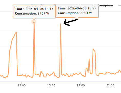

iboost+ seems a little odd, when I think it is switching on, but could be OK!
27 Jan 2008
29,792
3,694
Llanfair Caereinion, Nr Welshpool

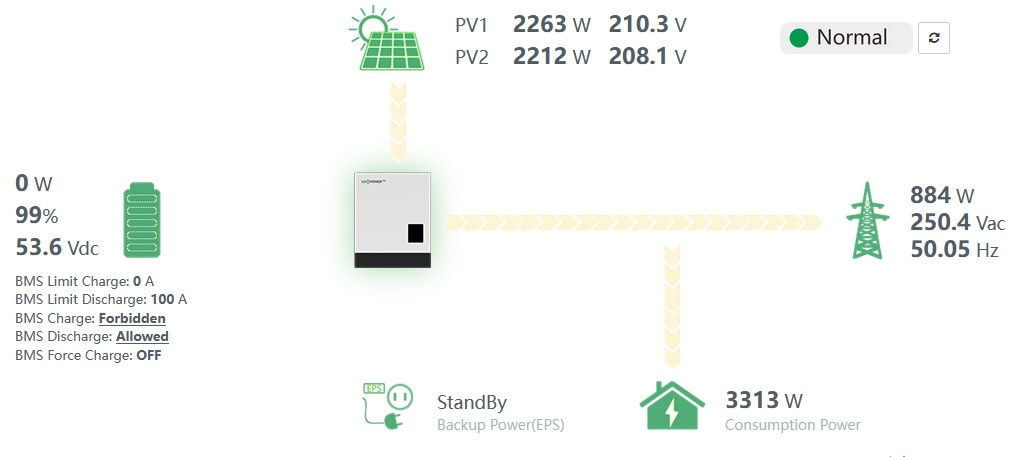

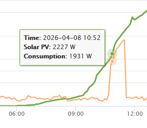

I looked at my software and noted a high load. 1775682772840.pngThe 3313 watt load seems around 3000 watt too high, but before I could check the immersion heater load had dropped. This 1775683286532.png does not seem long enough to be the immersion heater. Second spike wife was out, so nothing she has done, the first peak 1775683538437.pngseems to follow the solar production, so that would seem to tie in with iboost+ but I can't think of anything other than the iboost+ that could use 3 kW, but the time seems too short.
It may be that a thermostat will do this, and nothing wrong, but I would have expected a thermostat to stay energised for longer. But until yesterday, this year there has not been enough solar for it to use a full 3 kW, so not noticed those spikes. But can't think of anything else which uses 3 kW. Monday and Wednesday both high solar, and it seems similar both days, so is once every 2.5 hours about normal for an immersion heater to cut in?

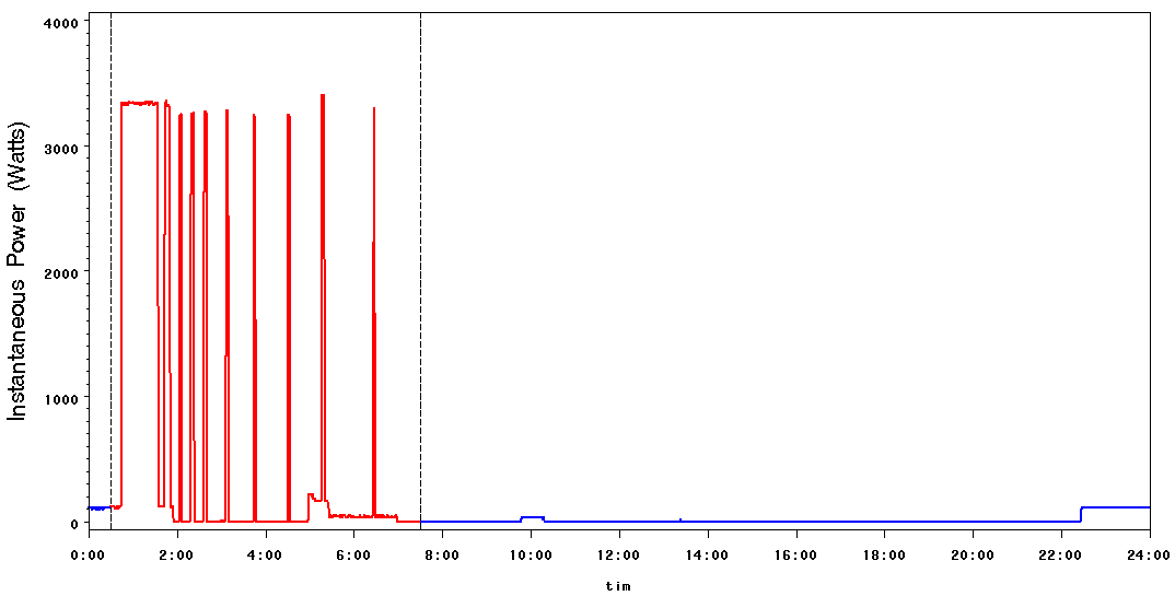

I'm not sure whether this is relevant, but even in the case of my extremely-well-insulated immersion-heated DHW cylinder, after the initial period of getting the water up-to-temp, the thermostat switches the immersion on very briefly far more frequently than "once every 2.5 hours" (roughly 'once or twice per hour'), usually just for a minute or three, as can be seen in this fairly typical graph of one night ...
Thank you. Seems mine doing as one might expect then.
You're welcome. Yes, it does seem that such is the case.
With a 'normal' (rather than my 'excessive'!) amount of insulation, I presume that the 'top-up' bursts of heating would probably be more frequent than what one sees in my graph.
