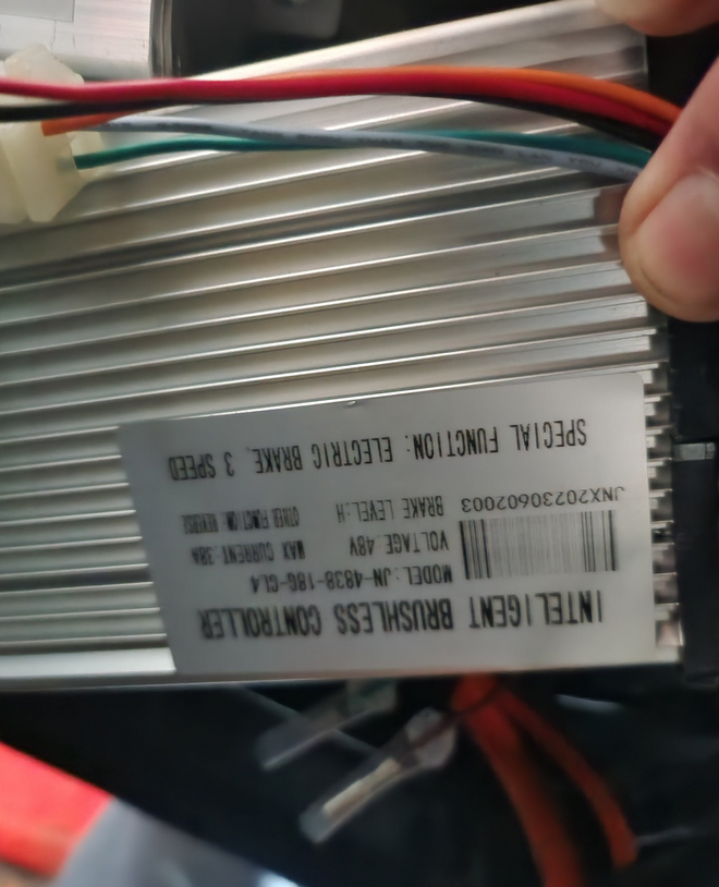

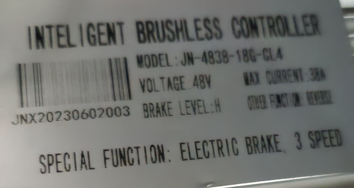

This is to help someone else out. It is the brushless, motor controller, on a mobility scooter, but they also use these same controllers, on ebikes etc.. It has selectable 3 speeds, variable throttle, controls lights, brake lights etc.. What I am hoping for, is a diagram of the pinout of the various plug connections, if possible. The control is made in China.

Not really an option. It is a brand-new mobility scooter, which in the EU has three speeds, 6, 12, and 25kph. When sold in the UK, the 3rd speed is disabled - usually via a simple wire link. All they want to do, is re-enable that 3rd speed.
Look through listings on Aliexpress for similar controllers, it may be possible to work out with the documentation of a similar product [and a multimeter?].
I've looked, and found nothing that matches. Were I there, yes I could probably work it out with a meter, but I am not there - I'm trying to help remotely.

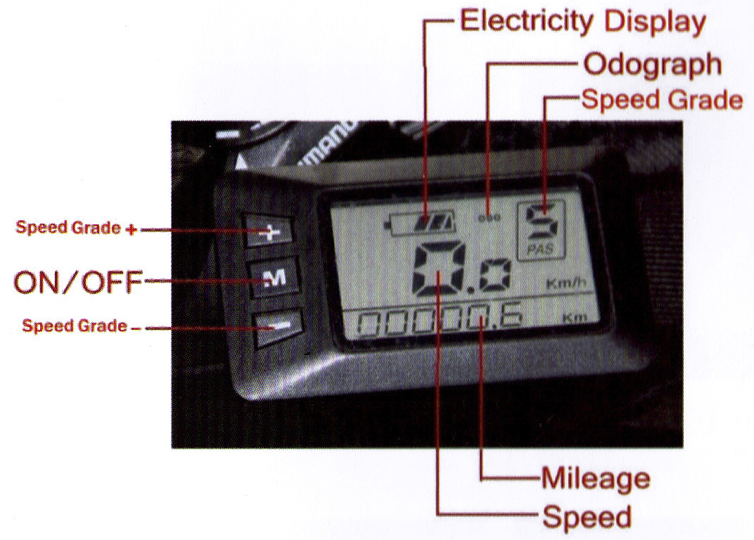

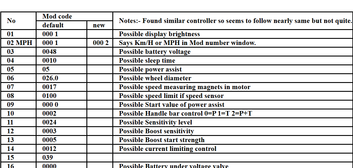

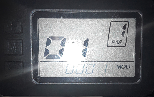

I would assume like the e-bike you have a monitor of some type? IMG_0008_1a.jpg there were 17 options 1748522806551.png but scrolling through them I found 18 options so that's why a little nervous at changing anything and why I have noted the original settings.
I see 1748523016806.jpeg here I have recorded to change to MPH I think it was some years back when I got it, I had become 70, and Colvid resulted in not being able to renew my driving licence.

I think you might be on a hiding to nothing with this one. Nothing on Google or Baidu, Deepseek tells me that JN-4838 isn't really a part number and more of a description: 48V, 38A.
