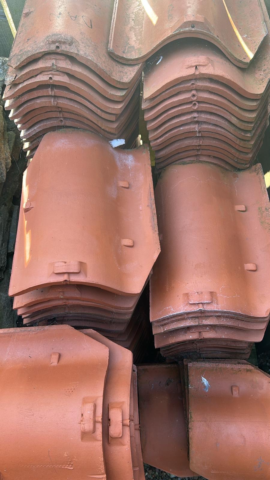

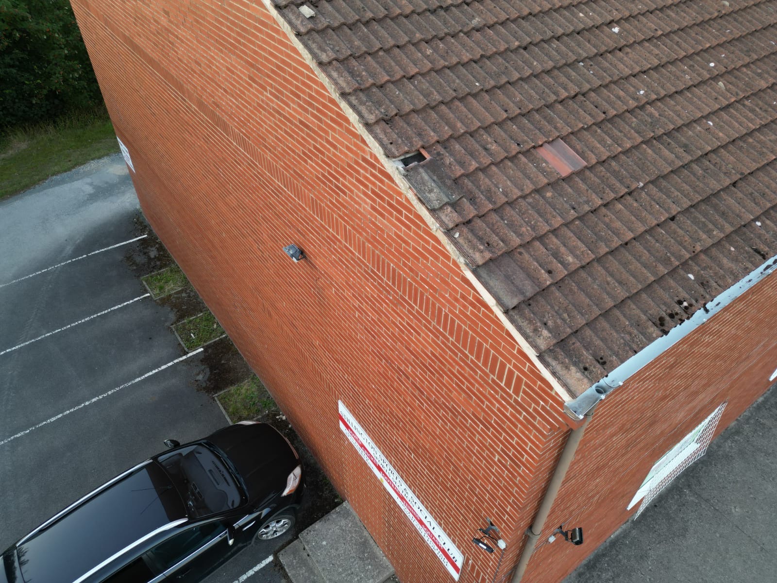

Hi I am going to change a broken tile at our squash club but not sure which tile I need. Someone has left some spare tiles at the club but we are not sure if they will work. Can you guys tell me if these will work and if not which tile to buy from the merchants.
I am used to using slates but never done tiles. I’m not a roofer

Those tiles are totally different. The roof image are Marley Mendip by the looks.
