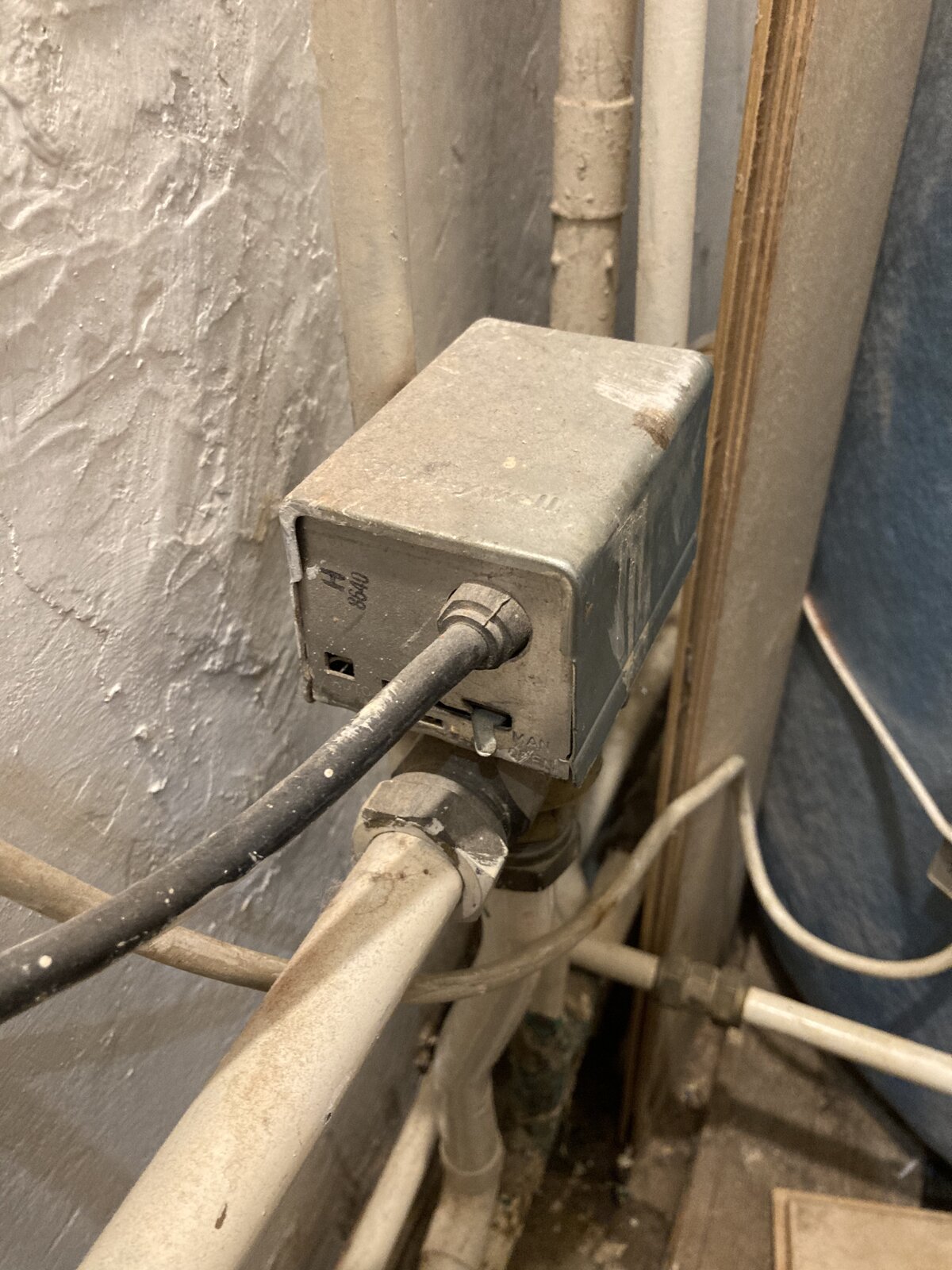

First thoughts are faulty/failing zone valve or weak/failing circulator (aka pump).
Thanks Chris. Im sure I heard a bit a more whirring coming from under the stairs a couple of days ago where those are both located. Is there anyting I can do to remedy this myself? I am pretty crap to the point where I had to just google "zone valve". I do recognise that though and I do have one lol!

So I just switched the zone valve to manual using that small metal switch. No change

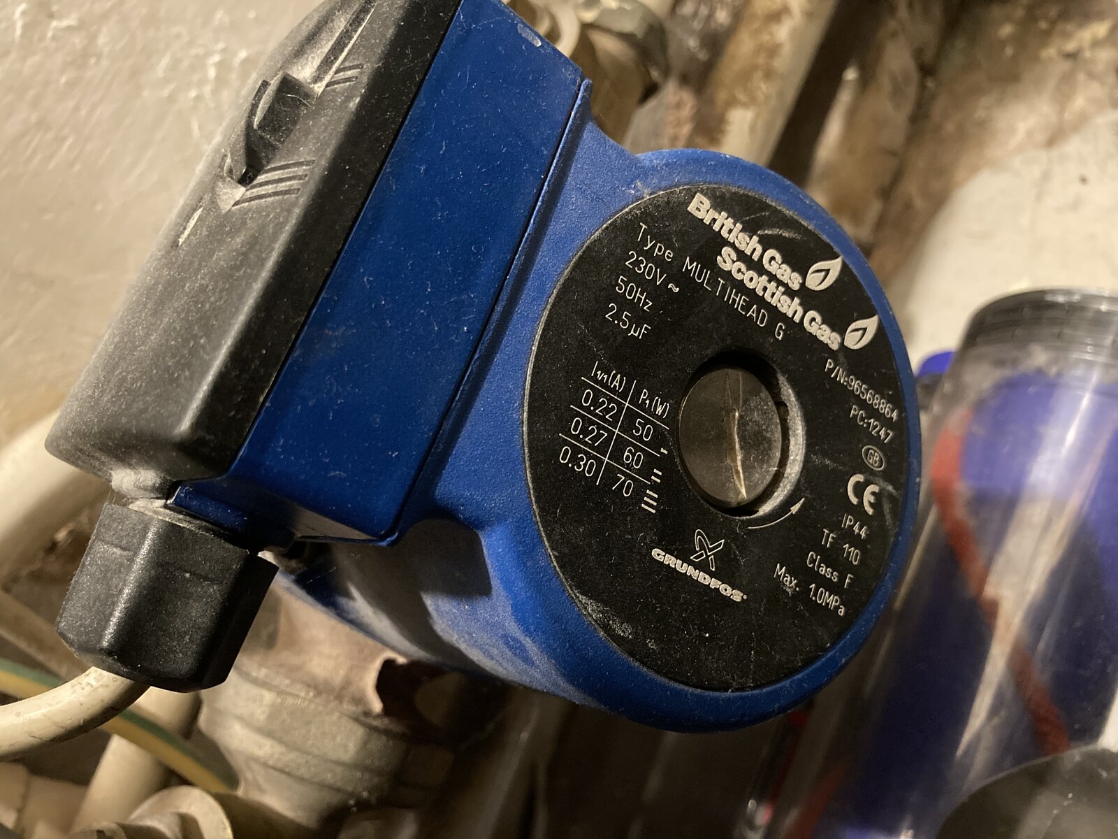

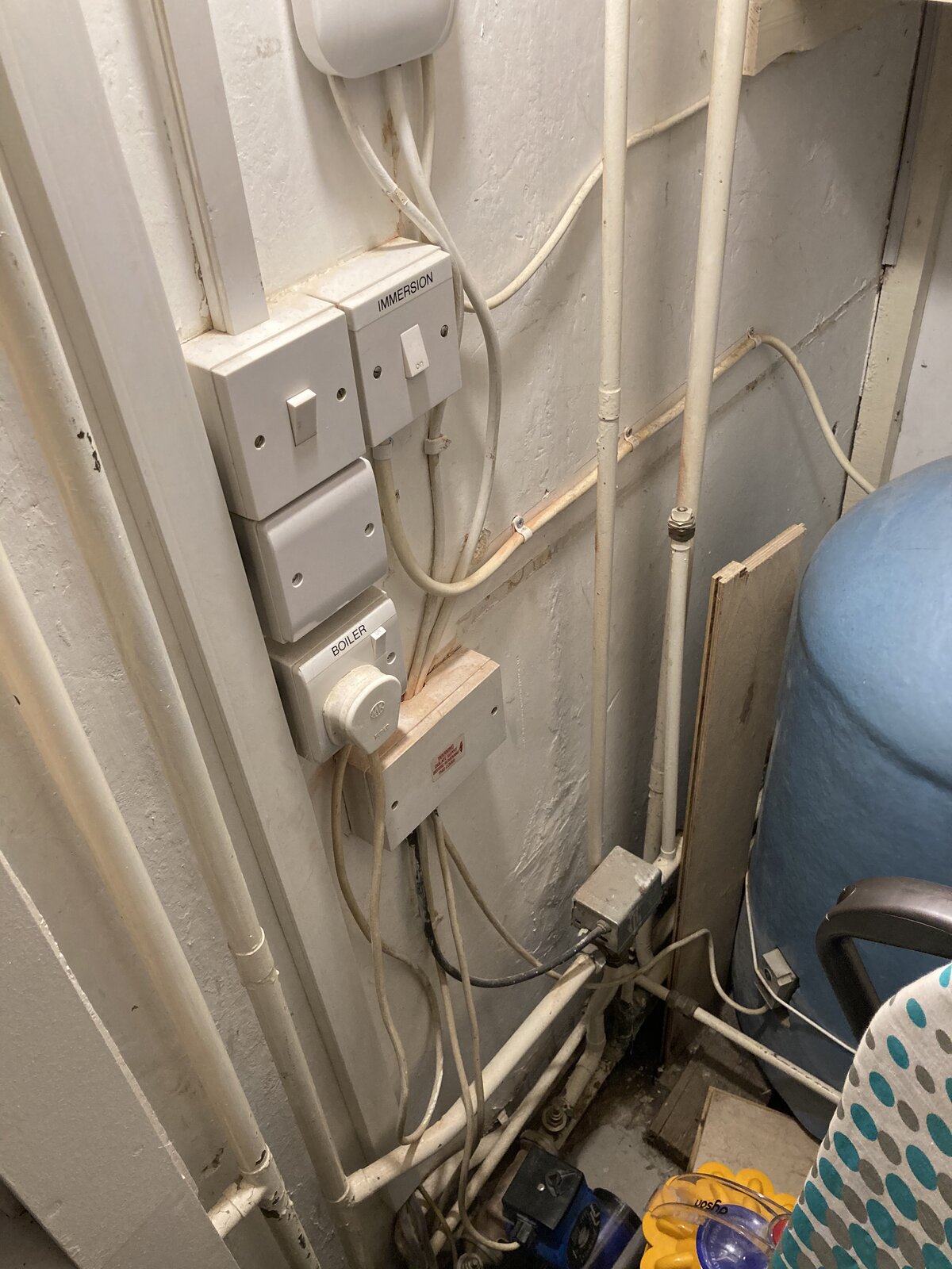

So this is my "set up" under my stairs. Presuming the blue thing is the pump!

- Pump speed setting is on 3.
- House is a mid-terrace 2 bedroom house with 5 x cast iron victorian free standing bar rads and a heated towel railed in the bathroom
- All victorian rads were removed, flushed (so much sludge!!), sandblastered and powder coated 4 years ago and refitted so I expected the system is somehwta clean, although the pipework hasnt been flushed but presume it all end up settling in the rads anyway? When i bled the 1/3 pint out a few weeks ago the water was clear, albeit thats from the top of the rad
Start with the circulator - remove the silver screw in the center and place a rag under it as there should be a dribble of water. Put heating or hot water on and see if the middle starts to rotate.
Right I'll give this a bash tomorrow and report back. Presumably there'll only be a bit of water and it wont be free flowing out??
Are the isolating valves either side of the pump fully open i.e. not restricting circulating flow ( same thought as CBW)

Also assumed you have bled air valve on upright next to 3 way valve?
No I havent. I've always wondered what that upright was in all honesty! Can I just use a rad key to open it or do I need a different tool?. Is it some sort of catch-all pipe for air before it gets to the pump
Ive never touched these and to my mind no one else has either so they should be open as they normally are!
