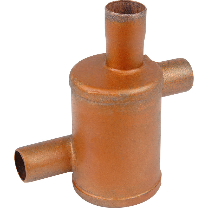

Switched on again this morning with system cold, and Only hot water not central heating, fires up and I hear the pump running ok, I got the steps and checked the feed and return pipes coming out of the top of the boiler, the feed got hot more or less straight away but the return stayed cold up until when I heard the boiler start to actually boil the water as it were and I switched it off, have man coming tomorrow and he seems to think block too - never been flushed but did have inhibitor I’ll report back tomorrow - thanks for all the replies
I have worked on hundreds of Ideal classics and never seen a blocked heat exchanger on one ever, a blocked heat exchanger does not happen overnight , it would be kettling and getting worse over many months

Could be pump, pipework or air separator (if fitted) blocked, need checking over, and fault finding, which needs someone on site. OP is there one of these fitted in the airing cupboard?
