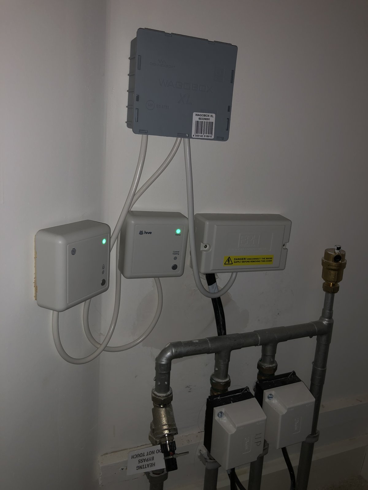

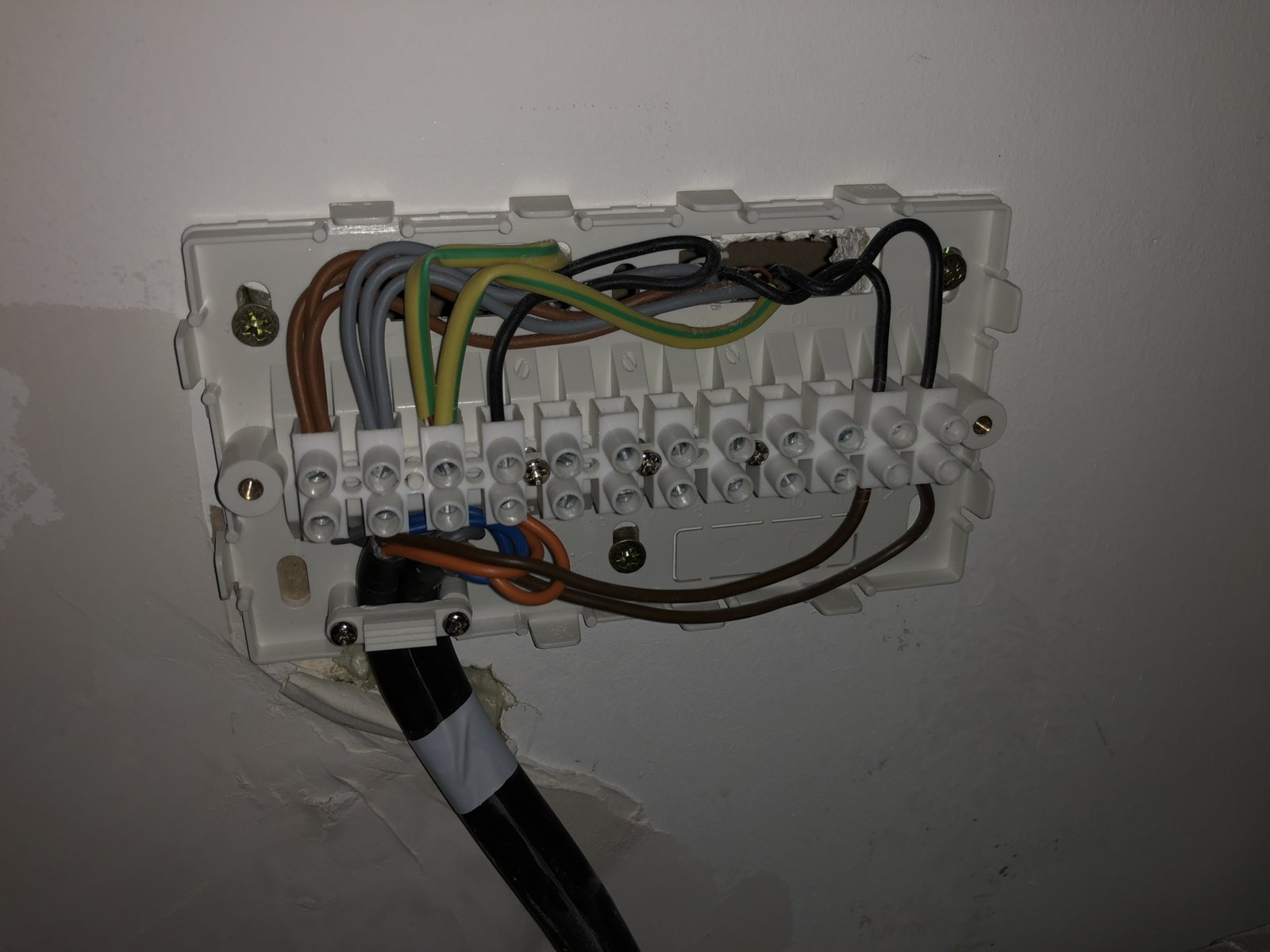

Apologies, the hives I have are replacing 2 wire (common and n/o) wired Danfoss thermostats, we have a EPH wiring centre in the upstairs closet next to the two valves which is where the two hive receivers are going.
The two thermostats which speak to the receivers are going upstairs and downstairs.
I’ve attached a pic of where it’s wired in to, I haven’t got a pic of the job done so far as I’m out of the country at the moment, but both valves are directly under this unit.
The boiler is a Combi Idel ESP1 38 if that’s any help as well?

The easiest way would be to replace the two existing thermostat receivers with two Single Channel Hive receivers. Looking at your photo, I am assuming that there is a brown (L) & grey (N) wire from the wiring centre far left terminals that goes directly to each of the existing receivers L and N. There should also be a black wire coming back from each receiver, one zone will be in the far right terminal, and the other in the terminal next to it. If so the existing wiring at the receivers would connect as follows:
The Brown wire goes to the Hive receiver L
The Grey wire goes to the Hive receiver N
The Back wire goes to the Hive receiver 3 (Heating on)
Add a link between the Hive receiver terminals L and 1 (Common)
If in any doubt don't proceed, but ask for clarification. If you need any further help post the model number of the receiver and details of each wire and where it is connected.
You posted the boiler details in your posts title, but it is irrelevant with multizone as the Hive is wired to the motorised valves not the boiler.

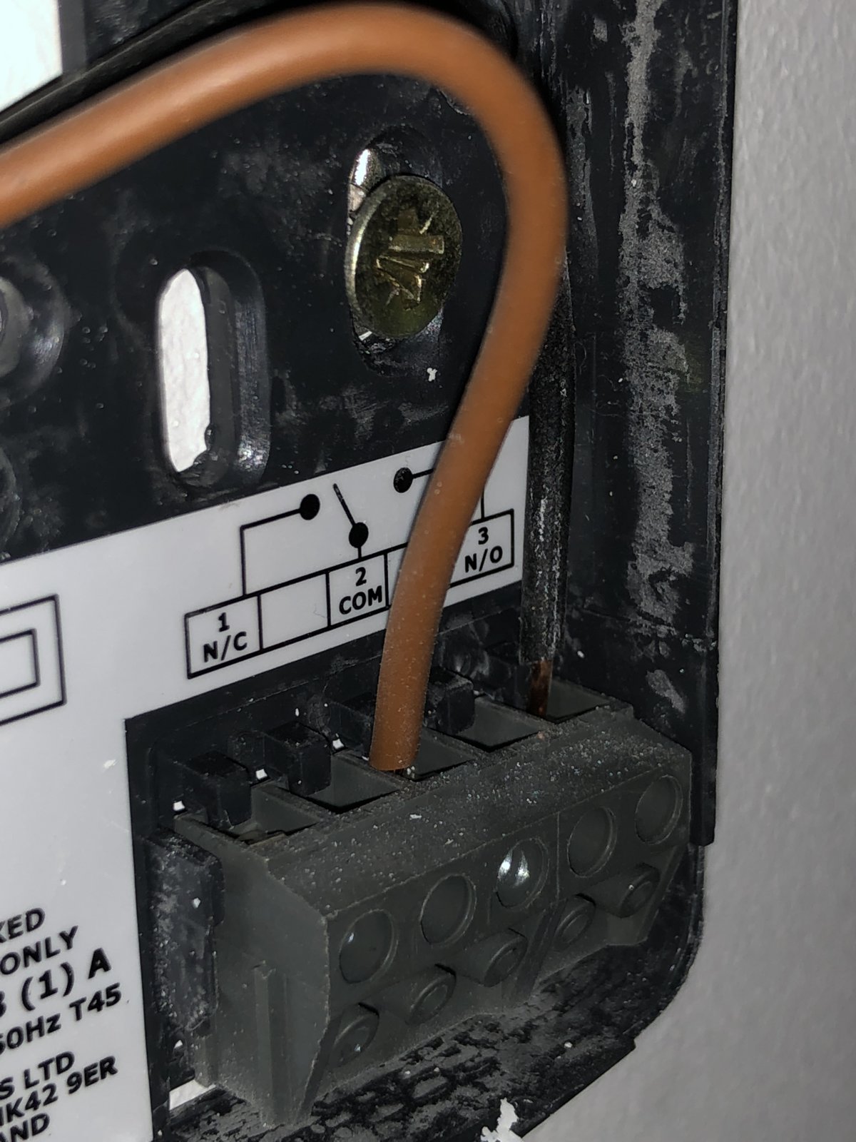

You have assumed correct on pretty much all points, the reason we are putting the receivers upstairs is because we don’t want both the receiver and thermostat where the previous thermostats were.
That being said, there were 3 wires where the thermostats were, however one wire was terminal led off leaving just two, I have attached a picture from that too.
Can I ask why I need to link wires L and 1? L is live and when the boiler comes on, point 1 is also live as well, is that a way of getting to work?
I will post the receiver details when I get back if needed but just curious about linking the points above that you mentioned.

I can't see it clearly enough to see what it is, but that does looks like a wired thermostat not a receiver. In which case there would only be two wires used if it is battery powered. The Hive receivers aren't battery powered and need a 230V supply for them to operate hence the link, for the Live and the extra wire for the Neutral.
So, would I be right then in saying that the original set up (not the Hive) is that you have two battery powered wired thermostats without receivers that only have the brown and black wires connected.
OK, good. Now we are getting somewhere. The the grey wire is the N but is not used presently as the existing thermostats are battery powered. So, you can either remove the existing thermostats and put the Hive receivers in their place as I said before:
Or, if you don't want the receivers where the existing thermostats are located.
It is possible to disconnect the existing thermostat cables from the wiring centre. They will be the cables containing the black wires to the far right of the photo. You will have to work out which zone is which from the motorised valve they are connected to, and then wire in the Hives directly in their place as I've marked on the photo.
Thanks Stem, I will do that when I get back, so what I have in place is the Live from EPH to hive L, the grey cable to neutral, but the Black cable next to earth, I believe that to be the common cable although I might be wrong, to port 1 on the hive, and the relevant cable on the right to port 3 on the hive, so it’s just a matter of adding the live cable to port 1 instead of the common cable to get the boiler to fire up?
Yes that's the brown wire. Same for both Hives
Yes correct. Same for both Hives
I have not mentioned that wire deliberately. Leave it well alone it has nothing to do with what you are trying to do.
It's the two black wires on the far right you are interested in. One will go to heating on (3) on one Hive and the other one will go to heating on (3) on the other the Hive.
Then add a link between L and 1 (Common). Same for both Hives.

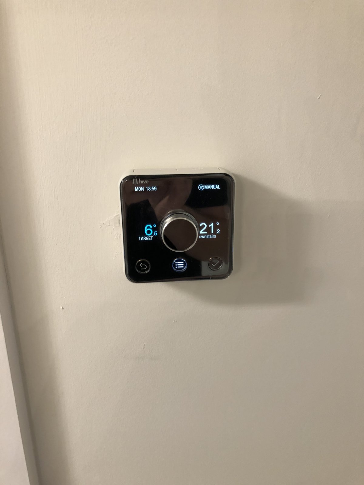

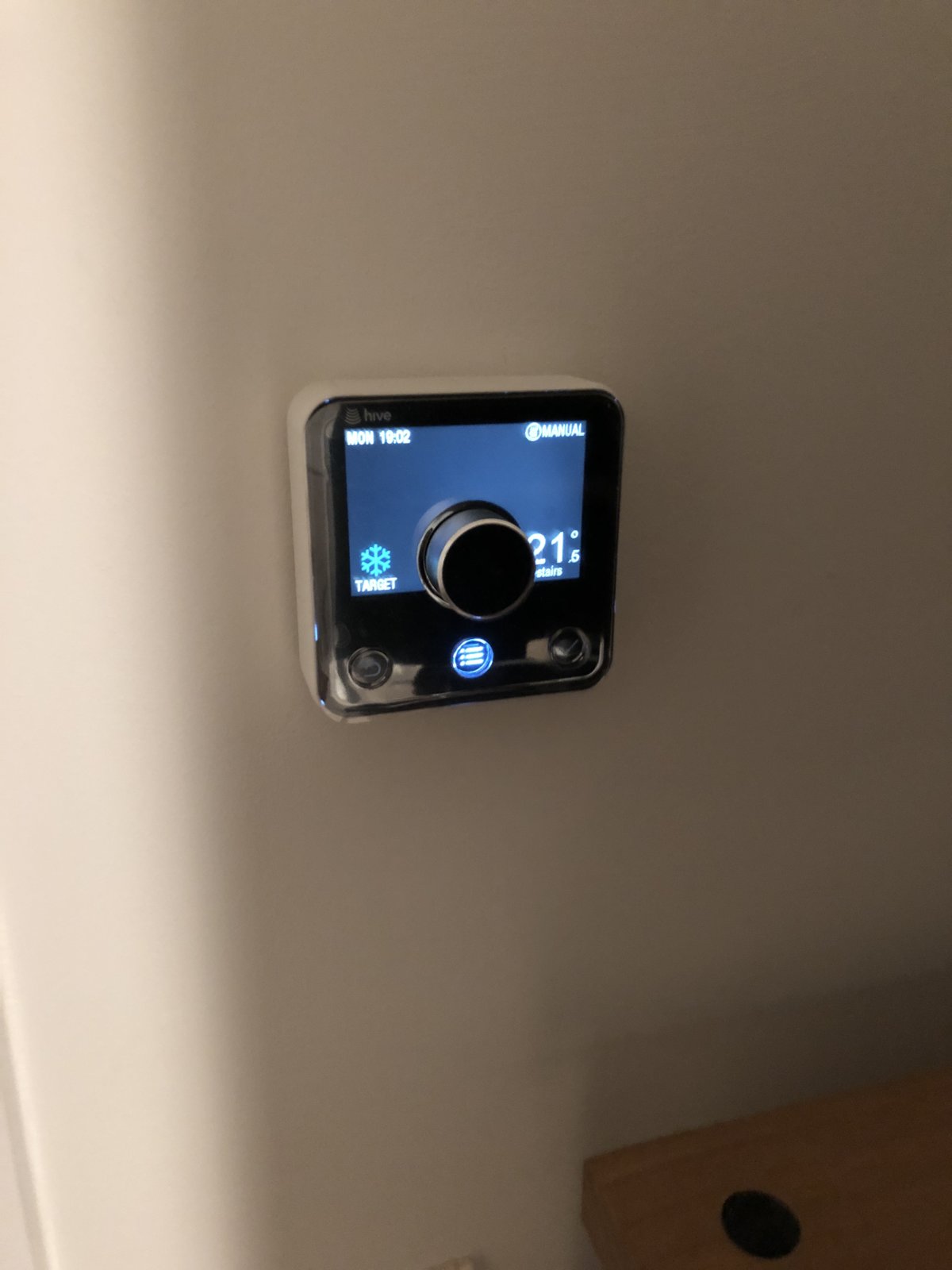

Your advice was spot on! Hive is now up and running perfectly. I’ve attached a few pics of the (mostly) finished job.
Just need to do a bit of making good where the old thermostats were but other than that, it’s all good!
Thanks again for all your advice and help, it’s very much appreciated that you took the time with all your posts.
Ian
