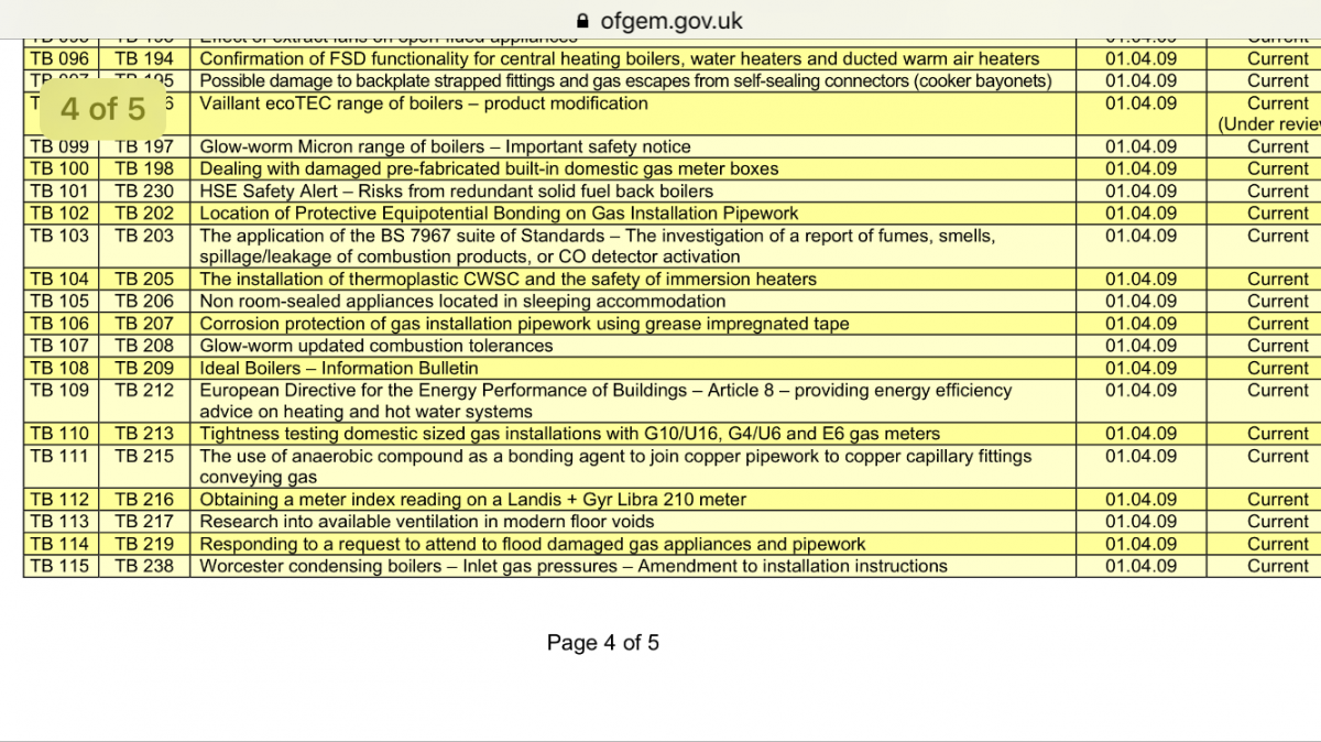

Video doctor you see messing with things you nothing about , just so you can see what shambolic is on about , go back to being a google warrior and find the gas safe technical bulletin 108 regarding your very boiler . as you see all gas engineers are able to access this info easily so how pedantic is he being now :rolleyes:;) . i just can't be bothered to go into the rest of what he said because your being ignorant to what you may have caused :ROFLMAO::ROFLMAO::sneaky: . leave that bl@@dy boiler alone

You assume wrong. Per bulletin any work even just to replace a caseing screw on this boiler then it must be stripped and insulation and retaining pins checked and replaced as necessary.

But carry on putting your family at risk, what would I know I'm only the senior engineer for ideal for Scotland and according to you "only nitpicking'
Oh and did you remove the COMBUSTION cover to get to the spark generator?
I've given you a clue. As soon as that cover has been touched the 4 tests must be carried out.
Why not post it so the OP and others can be made fully aware of the potential hazards that might exist from using the appliance. And also they can make it available to the next person who services the appliance.
( is it 108 or was there a typing error )
It wont mean mean much, just refers to the useless original ionization / insulation retaining pins failing and the insulation falling onto the top of the heat exchanger causing the flames to melt a big hole in the burner chamber wall. They need checking to make sure the updated kit has been / needs to be fitted so when they distort they still manage to hold the insulation up. It's all pretty irrelevant to the boiler owner who just needs the annual service booked.

Well done @AGAS back in 2009 but right TB number
