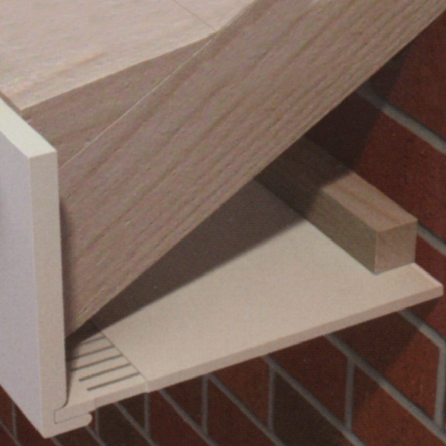

The eve in question has a vented soffit. Can I just drop the duct "in there somewhere"? It's impossible to get to the eve from the loft and not particularly easy from the outside either as its a very narrow passage on the side of the house. This eve/soffit is around 30cm from where the bath extractor is.
Interested in your thoughts.
That's very close, I'd think you could easily push a cut length of rigid duct that far, with an elbow or something to go through a hole in the soffit, and slightly sloping so any condensation will drip outside. Though such a short length, well insulated, will not be prone to condensation as it will quickly warm. You may need to add a backdraught shutter.

I could get a rigid pipe through the hole in the ceiling (where extractor grill sits) and push it over the eve. (Hadn't thought of this approach as I thought I had to do it from the loft. Thanks!). I can't see how I can drill a hole in the eve to push the face of this pipe out...
Yes, my eves have a vent but water may start to collect on one of the sides. The non-vented end of the soffit may be at a lower level than the vented end. If that makes any sense. Perhaps I am overthinking this

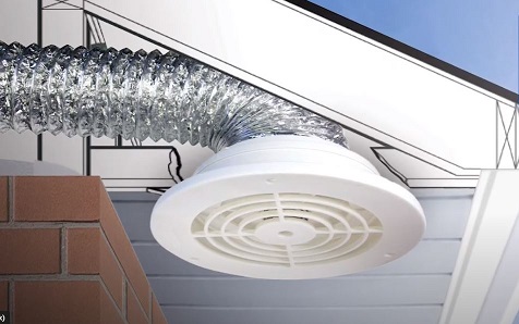

Most soffits are the same as yours. The grille is usually installed using flexible duct at this point because of the tight bend. Condensation only forms inside the duct so any access water will run through the grille not sit inside the soffitt.

The hole is cut in the soffit centrally between two joists / rafters. The flexible duct pushed through the hole, the duct is attached to the grille, excess duct is pushed back through the soffit, the grille fixed in place and the duct positioned / straightened correctly in the roof space.
