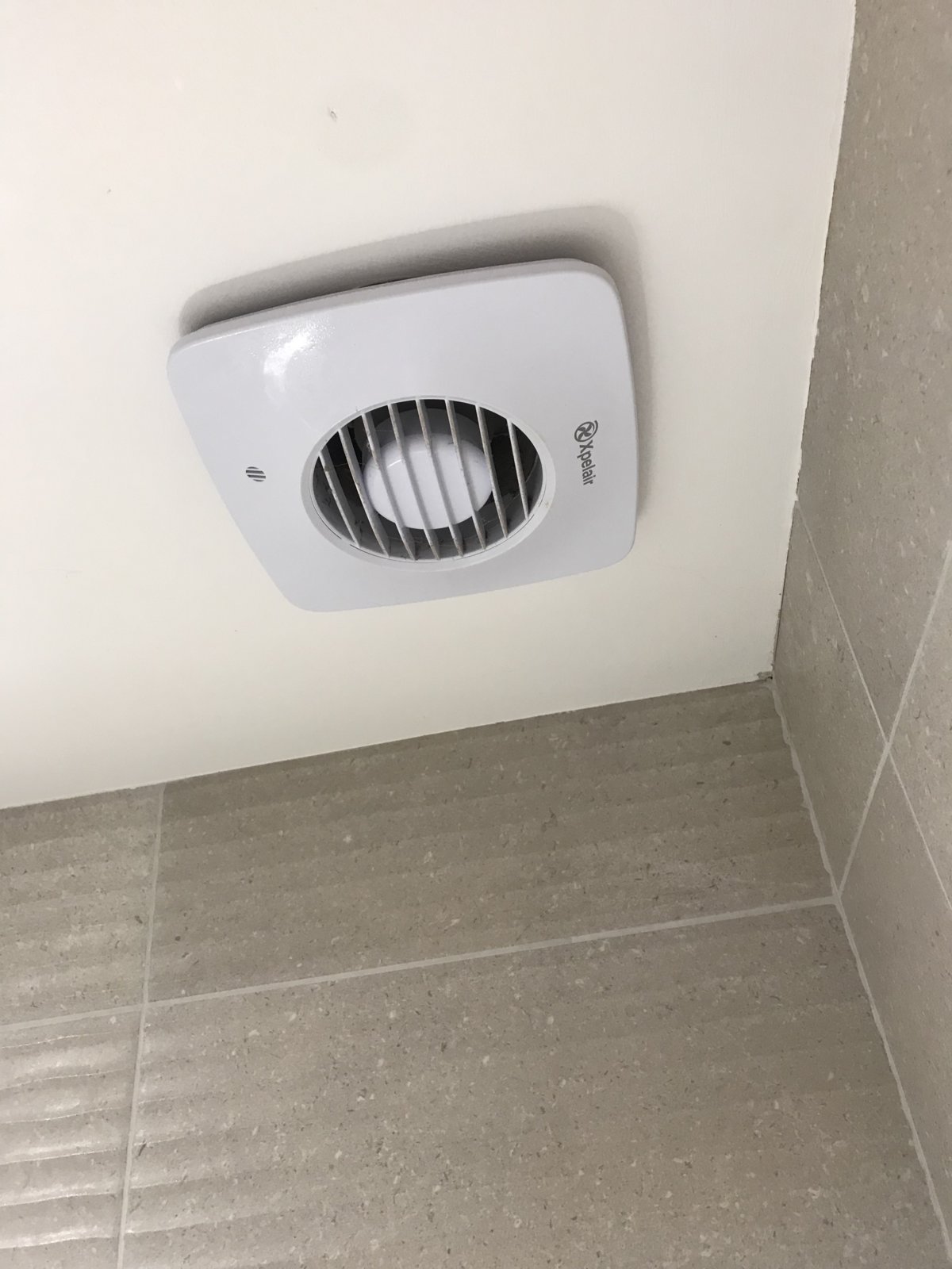

my en-suite extractor has failed and I am looking for recommendations on a new one please. Picture of current unit attached.
Ensuite has no windows and is 1.4 x 2.5m. The duct above the ceiling travels around 2m before it pops out of the roof.
Thanks in advance
Sorry, here you go. It is a timer unit

I wasn’t aware that it had a humidity sensor as I’ve never noticed it running outside the parameters of the light switch timer delay...

My recommendation is to get the same one (perhaps without humidity sensor). Whenever I have changed brand (as a DIYer) the new brand one needs the cables to come in from opposite side, or different length cables, or screw hole position has changed. So unless some big issue with old one, suggest you get the same to minimise effort of job.

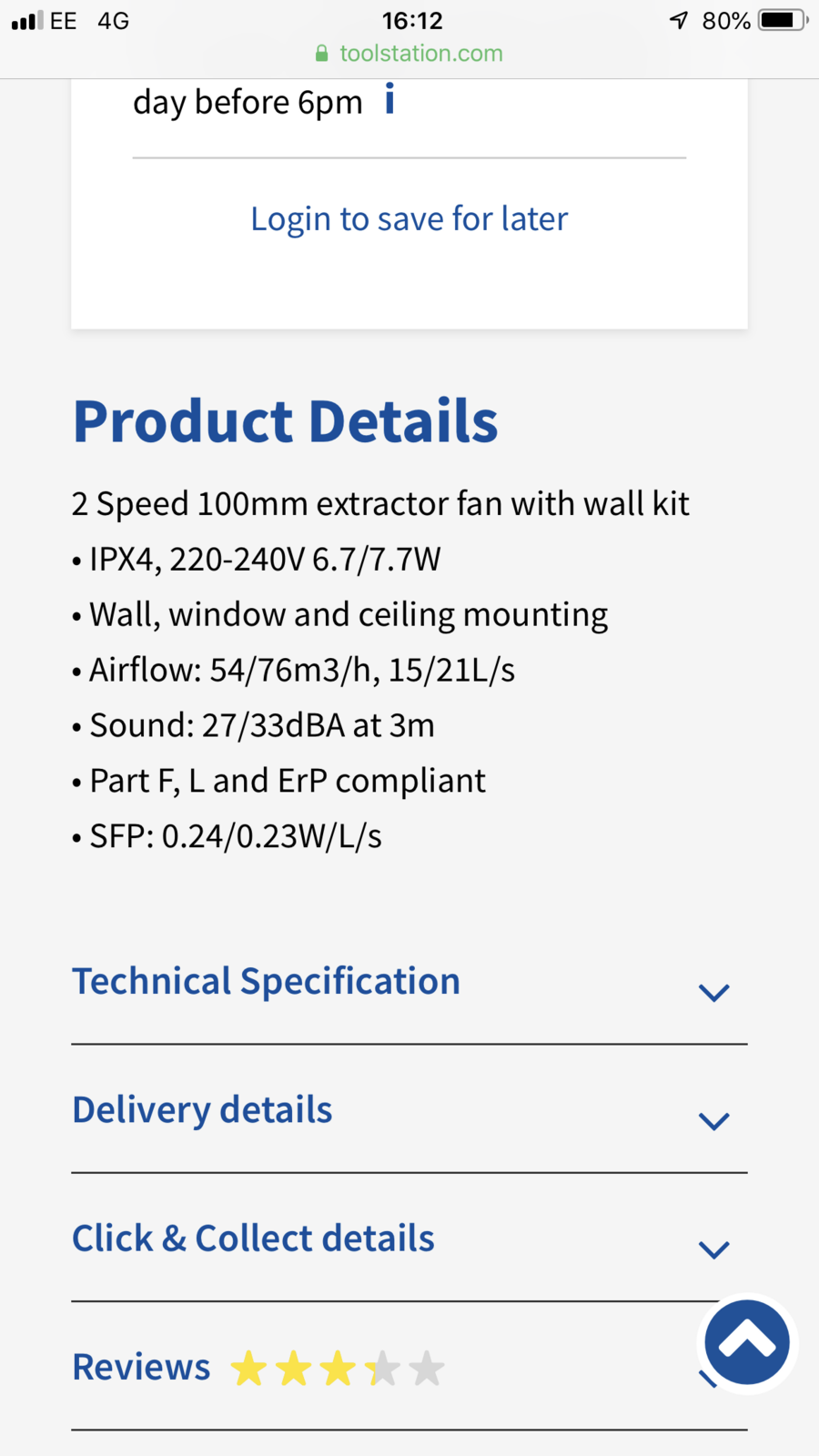

Do these specs seem sensible to the dimensions of my room?
Jupiter, Sorry I am wrong person to ask, as said, I just swap out same brand (if no other issues) to save fitting issues.
The numbers look okay.
Sorry, but if you had said that the old fan still left condensation, or didn’t clear the smell of curry downloads then I’d have made alternate suggestions.
