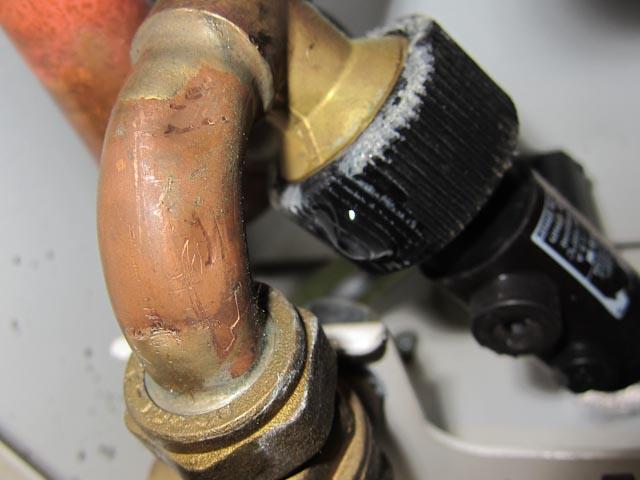

Hi
I will try to describe the problem well...
The boiler is leaking some cold water from the back - it is dripping next to the far left pipe, which seems to be marked DHW In. I can't tell if it is actually coming from this pipe or from somewhere else in the boiler and just dripping out from this location.
Everything seems to be working fine - the hot water and central heating. The pressure is currently just a bit under 1.5 and the central heating just came on and switched off ok.
Is the pressure too high? Is there something I can check / adjust easily before I call someone out to look?
I'm not sure exactly how fast this drip is.. not too fast. I will leave a bowl there and see how much water i catch tonight. In any case, there's something clearly not right.
Thanks so much for any advice you can give!

Sounds like the pipe needs replacing that goes into the heat exchanger.

It more than likely will be the pipe, they are pretty inexpensive too.

OP, if the pressure has not dropped, it will be the hot water side that is leaking. Almost certain it will not be the pipe but a union or seal. Turn the water off at the main stop valve and see if the leak stops..

Hi thanks for the comments
This morning I switched the boiler off, took the bottom panel off and managed to take this photo (see below).
I might add that the gold pipe leading into the black plastic looks dusty, so the water could be coming from the black plastic - I also note the limescale build up there.
What do you reckon?
Looking for some :) s!! but you can be honest! Is this the heat exchanger?
Or do you think the water is coming from somewhere else and then just ending up there?

that pic is the domestic hot water flow switch, use some tissue paper to dry it, then watch to see whether the drip appears from the pic or further up.
ok i think the drip is coming from there. I don't see any water coming from anywhere else. Water just seems to be slowly forming in exactly that place and not running down from the gold pipe or even from the top of the black plastic.
If that is the case a new washer is probably required.
if that's the case, then i'm guessing it shouldn't be very expensive to fix?

a new fibre washer may do the trick, or as i mentioned previously you may hace to replace that small piece of pipe, a little tricky to get to but worth it to cure the leak.
