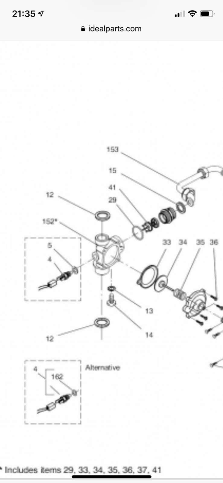

I thought i would just double check the wiring and see the thermister. I looked at the location in the manual and when checking the boiler, there is now DHW thermister, I can see the CH one but there is definitely no DHW one and no location for it.
I then went back to the manual which covers a few different ideal mini’s and I then noticed that the s24 doesn’t have one, so now I’m stumped!!

Yes.Put boiler in bin.
Your looking at a manual for the Combi not the system.
So there is only one on the S24 change it.
