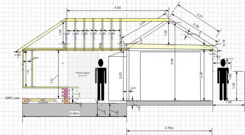

Yep - plastic interlocking tiles - weighing around 8KG per M2, installed over battens and breather membrane.

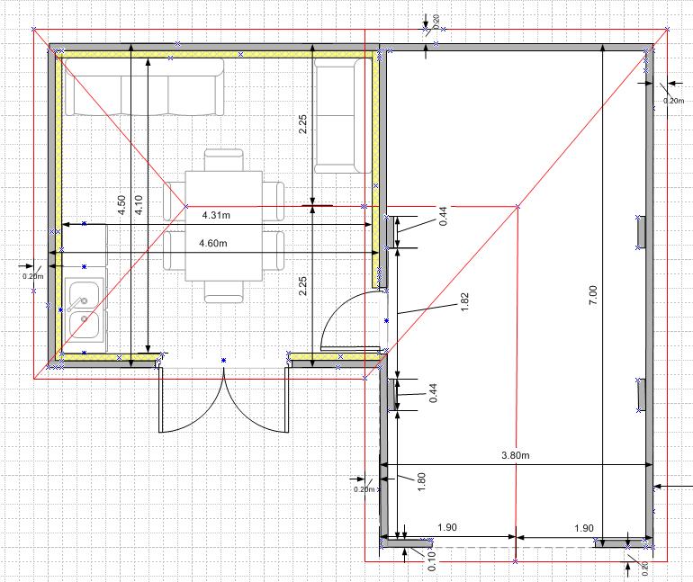

I've abandoned the idea of the massive eaves overhangs because the plans say the resulting eaves will be way too low to be practical, so I'll go for standard eaves that are 200mm deep - I'll get a new diagram uploaded later so that you can see what I mean.
I like the idea of a vaulted ceiling in the summerhouse but not sure what I can get away with in terms of avoiding spread - i.e. whether I can fit some collar ties to make it all stable, or whether I should keep a couple of joists in place too made out of a decorative wood such as oak and leave them exposed? I could even put a feature king post in place to support the apex of the hips/ridge.
Updated plan and elevation below. I've tried to illustrate the idea of the two oversized 'feature' joists to stop the spread. I've added double thickness wall plates too (two layers of 100x50mm):

Sorry but going to give you a lot of problems.
You now appear to be showing 450mm single brick skin below studwork. How you going so insulate that to the U value that you require? Also how do you intend to secure bottom plate to dwarf wall?
Notice that you have not got the same storey height to the new build as to the garage. Why
On the new build part your hip rafters are not at 45 degrees. Why? This can be overcome but means a lot of additional work and the possibility of roof tiles now coursing round hip/
You have not stated your pitch. On the new part you have a half span of 2250 and a rise of say approx 1375 from top of plate to top of ridge board which will give you a pitch of 31.4` degrees and a length of rafter of 2637 plus overhang, however on the garage you have a half run of 1900 and rise of say 1375 which will give you a pitch of 39.5 degrees and length of rafter of 2345 plus overhang. So in a nutshell you will have unequal pitch to hip and valley over garage. Will make life very very difficult. The figures above are only approx to give idea of pitches. Check them out yourself.
Regards plastic roof tiles, never used them. Would never consider using them unless we found out a lot more information. In our opinion they are only fit for a shed or beach chalet. We do know that they greatly expand in hot weather and shrink in cold weather. We also do not know their reaction to breathable felt or the air circulation between the felt and dew point of plastic tiles. . In the normal run we would talk people out of vaulted ceiling, unless it was designed and built in the correct manner, how ever in your case , if you use plastic tiles with such a light loading then possibly 2 no 50x225 C16 with bulldog connectors or 75x200 C16 will be sufficient to span 4500 and stop any spread and creep, however that is only our opinion.

I'd included the dwarf wall because I thought it'd be slightly more attractive, and because I have the bricks lying around. Having given it some more thought, it's a few days extra work that I don't need, so I'll forget that idea. That'll help with the U value too.
The walls are complete up to DPC level now. I'm going to screw the sole plate down through the DPC with concrete screws.
Re: unequal storey height, the elevations show the foundations cross sections. The finished floor levels are actually the same. I've finished the slab 100mm below the garages finished floor level so that I'll be able to lay 75mm PIR and 25mm chipboard on top. Slab is floated flat to minimise the bounce through the PIR/chipboard.
The new build hips aren't set at 45 degrees so that when viewed on the front elevation they match the pitch of the roof on the existing garage - so purely aesthetic. I'll take a closer look at the roofing tiles - I'm not sure whether I'm okay to have a variable head lap on them so that I can make sure there's no coursing around the hip.
Re: the variable pitches, I'm not sure what I can do about that given that I have one building that's 3.8M wide, and one that's 4.6M. Assuming the rise has to be equal for both, then the building dimensions dictate the pitch. After the two hips and valleys on the last roof I've got quite comfortable marking and cutting hip and valley jacks - is that the only difficulty?

On that subject, I've had cold feet on the plastic tiles and am going to go for fibre cement instead - Marley Garsdale. Seems only slightly more heavy at 21KG/m2 and looks relatively simple to lay - any thoughts?
Gary, Had not forgot you but have kept putting your summerhouse out of our mind due to the fact that we can get our head round how to explain your roof to you due to the unequal pitches
Google and have read of this and you will understand the problem better.
A Tale of Two Pitches: Exploring Off-Angle Roof Framing .
We are not saying it can not be done, but we do not know how to explain it to you in simple terms.
We will sit down to-morrow and giver it a lot of thought and come back to you
