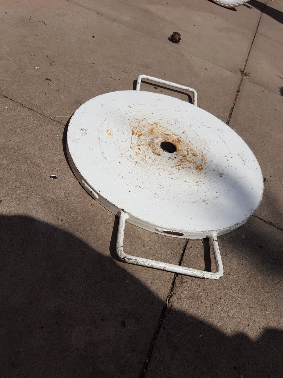

Ive got these weights, they are 20kg each and i need to fix 2 together to make 40kg, they will be carried so need to be fixed pretty good, any ideas? 20180714_141144.jpg
Large diameter, but short length bolt through the middle with a washer either side and nut on the back? Some pretty large ones(M20) are readily available.
What's the thickness of the disc and what's the diameter of the hole in the middle?
The thickness of the plates is about 20mm and the hole in the middle is about 35/40mm
Think you might be onto something there but is there anything that would fit that bigger hole?
if you centre bolt them, the top will be able to swivel/rotate unless you fix the handles together.
The only place I can think to easily get a large nut and bolt is from a vehicle like a truck so a scrapyard might be worth a look
or drill the weights in three or four places and bolt through with smaller bolts.
use a new cobalt drill and some fluid
Yeah, that was going to be my next suggestion.
Gazza, if these are for some sort of training/exercise purpose and you'd rather not have anything sticking out the sides to gouge a chunk of flesh from your leg, then drilling, tapping some threads and using countersunk bolts through from one to the other is your best bet.
Unless you know someone who can weld, then you're a bit limited TBH.

I did think about drilling but not sure i have a drill manly enough to get through them
If it was ten quid from Aldi, then you're probably right. However, what have you got?
It's more about good quality sharp bits and a steady hand (i.e. keeping the drill perpendicular to the surface in both axis).
Like Tiger said, cobalt bits are what you want for the pilot drill at least, but I would add, make sure they are "split point" also. Then enlarge the holes.
Each of your 20mm lumps have been constructed from 2 x 10mm plates welded together, it would be easier to do likewise in joining joining the lumps.
10 minutes topps with an arc welder would sort it, what about a local garage or or workshop if you dont have a handy mate?
If you do drill,4 x 8 or 10mm in each, cobalts are handy for hard stuff but good quallity HSS bits would eat it and what the heck if not perfectly round, it not got to be flown to the space station to mate on something?
