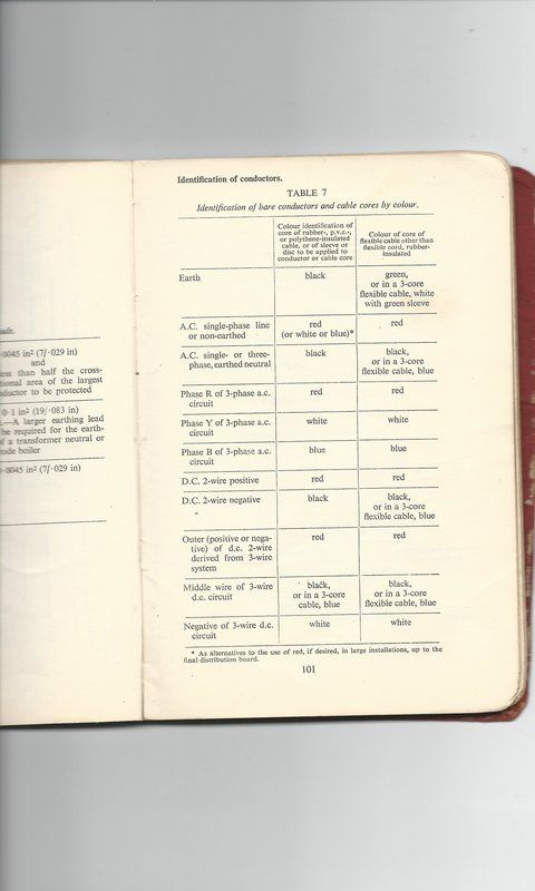

Of course there is; far too little confusion around at the moment.On the subject of colours, there's a proposal to standardise the colour for functional earth conductors as yellow.
Do you mean the black earth or
the white yellow phase?
Call it sable, maybe?But if the earth is black, how do you distinguish it from the neutral?
