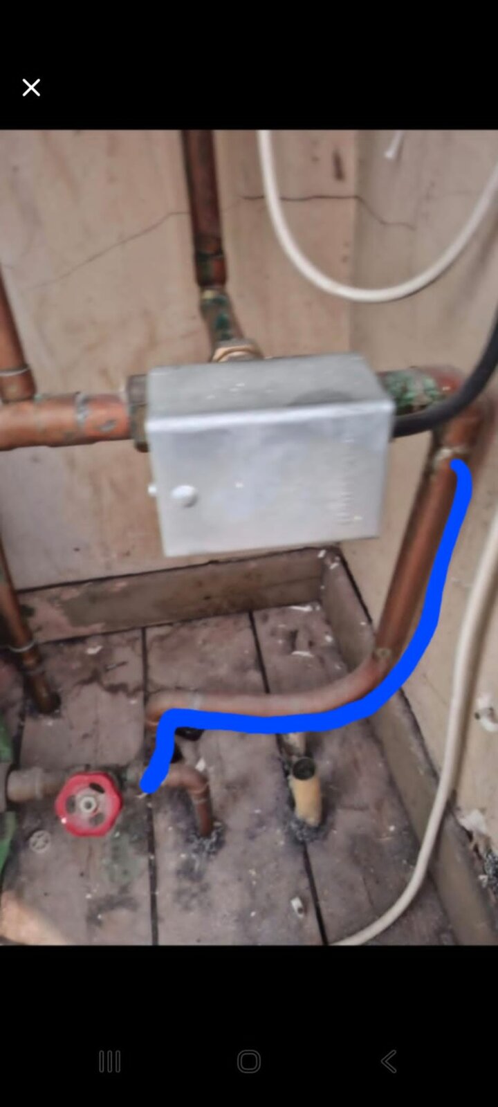

In my picture below have I identified correct for flow and return pipes ?

Turn heating on, starting from cold. The flow pipe will become hot, long before the return becomes warm.
There should also be an arrow, formed in the pump casting, denoting the direction of pump flow.
Care to elaborate on what it's for? You can do as above, but can also be traced back to the boiler.

First time fitting on a heat only system. Just want to be sure before start . Got no problem with bunging f n e and vent. Isolating water and wet vav ing the remainder water in pipe so no water when cut it.

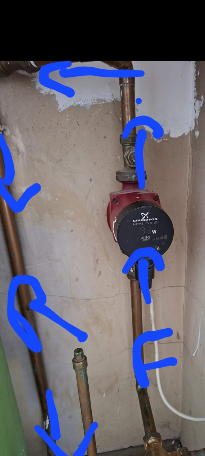

But I think I have got the flow and return arrows wrong way. Return is after pump going to 3 port I think. Just need clarifying.
Could not see arrows on pump today
If the pump is going to 3 port, that’s usually the flow

Is this return ( In blue) 'm not up on identifying on heat only. Combi would not be a problem . Thanks

No off the 3 port will be heating flow and cylinder flow for hot water. Have a look at the cylinder there’s 2 connections if indirect, one will be flow from the 3 port the bottom should be return
Why not fit it by the boiler? The primary return is most likely under the floor, not in the airing cupboard
For the filter to be most effective, as suggested, you need to have it after the primary return from the HW cylinder where it meets the main return and then before the boiler.
That may require the return to the boiler, in the cupboard possibly, to be rerouted to allow space for the filter to be fitted.
