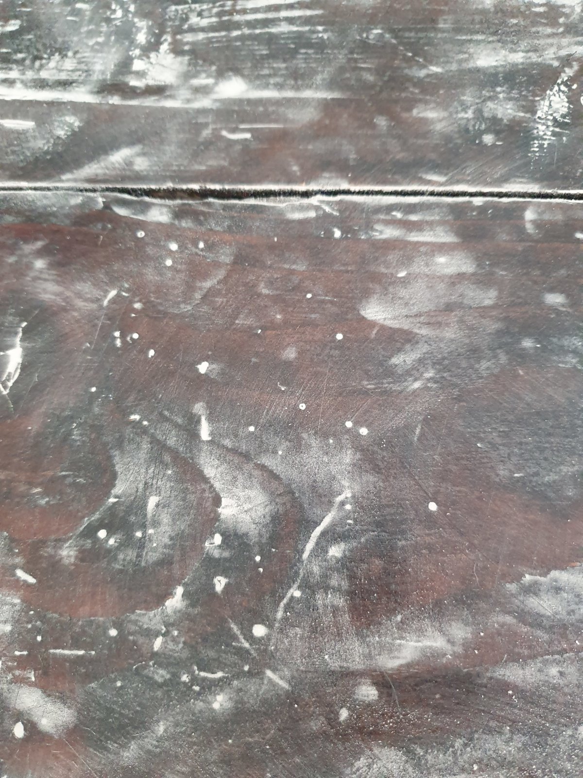

I want to give our bedroom floor a spruce up, but I'm struggling to determine what finish has alreadybeen applied to it.
Here are the clues...
I can feel the grain on the floor, so that makes me think it isn't a varnish.
If I scrape the top of the floor a residue does come off. It doesn't flake, but it's more of a soft powdery texture.
I put a drop of tung oil on the surface. It didn't soak in, so I'm thinking it isn't an oil finish, but it did rub ok with a cloth.
I also put a drop of acetone on, and rubbed a little. This definitely removed the top layer. From what I read acetone will remove shellac, but I'm assuming it will also remove a wax based finish.
I sanded an area down with 120grt and you can see the result in the photo.
I think it could be a wax finish, and if this is the case has anyone got any suggestions as to what product I can use on it?
