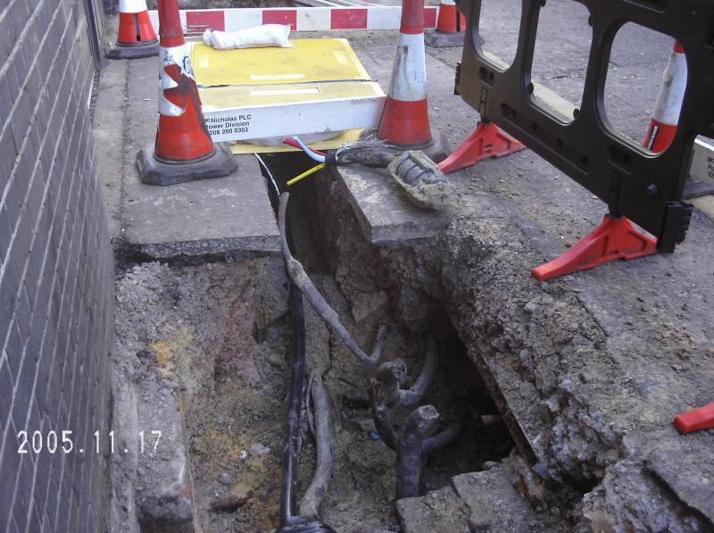

In this photo, the neutral apparently failed, and the resulting explosion blew a hole in the pavement, luckily nobody was injured at that time.
Unfortunately hundreds of households lost power for a couple of hours as a result of the fault!
