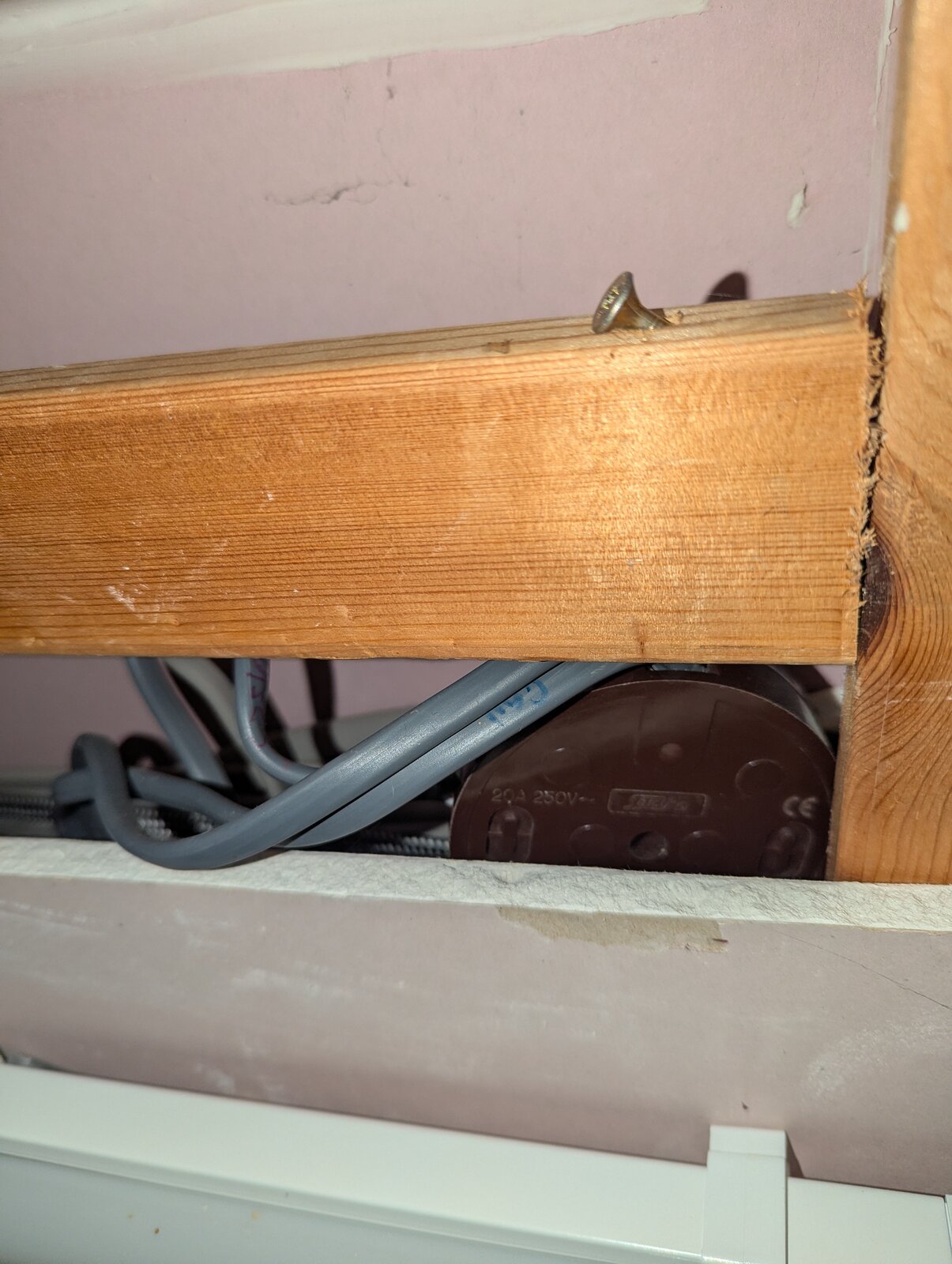

the electrician I've just used has connected an outside light via an old style junction box. The junction box is in the ceiling of the under the stairs cupboard, which I'm about to plasterboard and then plaster over (he knew that was the plan).

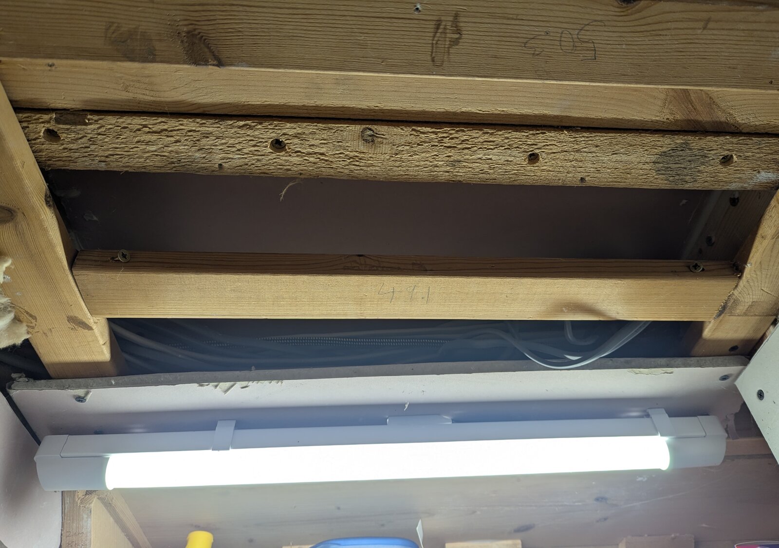

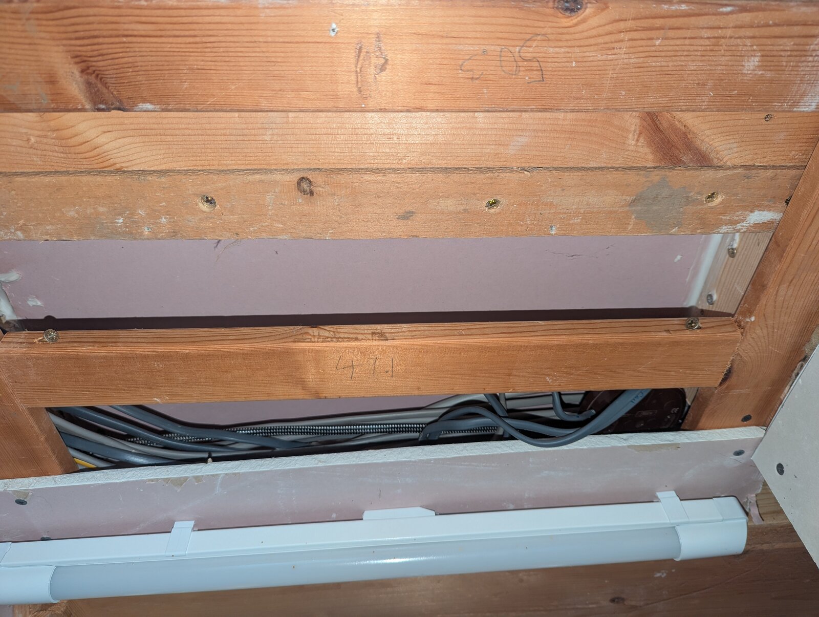

Hi, I'm so sorry - I hadn't realised this conversation had continued. I've attached photos

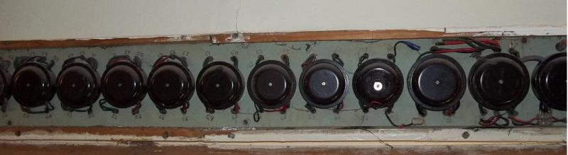

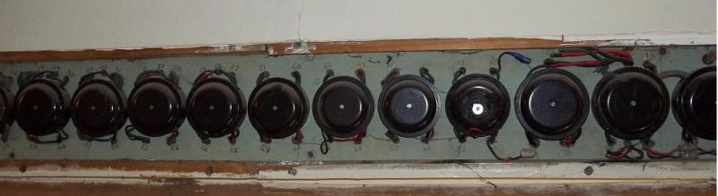

A friend bought a cottage and discovered this DIY installation behind a hard board panel
A 230 Volt ring main was looped along the junction boxes and each socket in the house had a cable from it's "own" junction box.
Door bell wiring ( ELV ) used the larger junction boxes.
Gosh!! That looks a little eccentric but is it ok in terms of the regs?
