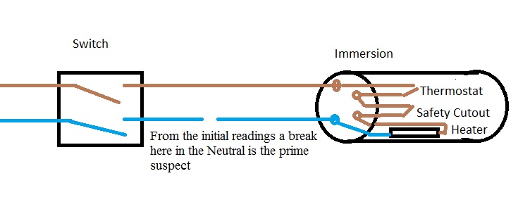

Immersion no voltage between live and neutral
feed to switch 240v
load from switch 240 v
thermostat 240 v
element 240v
What are each of these voltages referenced to ?
ok thanks I'll give it a go and let you know how I get on. thank you all again for the help .
