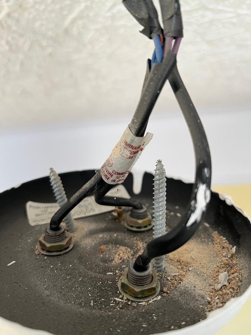

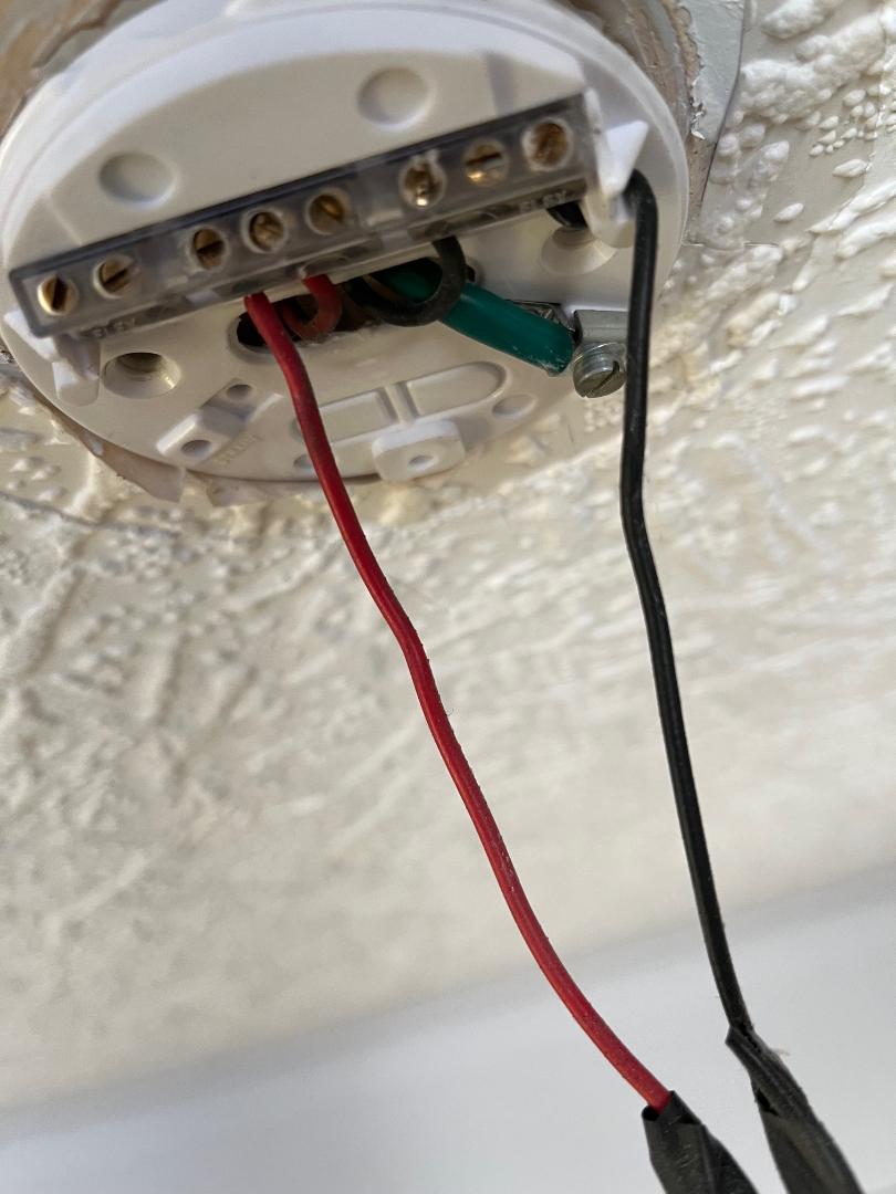

I'm decorating my upstairs bedroom and decided to replace the light fitting (it's been there for 25yrs). I disconnected the old fitting which was only connected to live and neutral. (See pictures below). I checked the voltages and noticed the neutral- earth voltage was 120V which doesn't look right. Live- Neutral was 240V as expected.
I've switched off circuit from fuse box and trying to figure out next steps. Should I call in electrician or are there some simple checks I can do?
Any help/advice appreciated.
Thanks.

Yes this needs to be addressed.
The next step would be to test the continuity of the earth wiring from that fitting location back to the main earth terminal. This is not teriiblly difficult but does requilre a long temporary cable to be set up. If that is bad, then the fault is within the lighting circuit and it becomes a matter of searching and testin different parts of the circuit until you find it.
If the connection to the main earth terminal is good, then this suggests a serious problem with your supply earthing setup. If that's the case post a picture of the CU/meter setup for further advice.
Can you confirm your earthing arrangement? If not, maybe post a photo of consumer unit area. Maybe test something else, like a socket?
The Earth isn’t connected back to the CU is my best interpretation of what’s being reported
I agree, that is the most likely cause, but it needs to be confirmed. It's also possible (but less likely) that the issue affects the entire installation.
