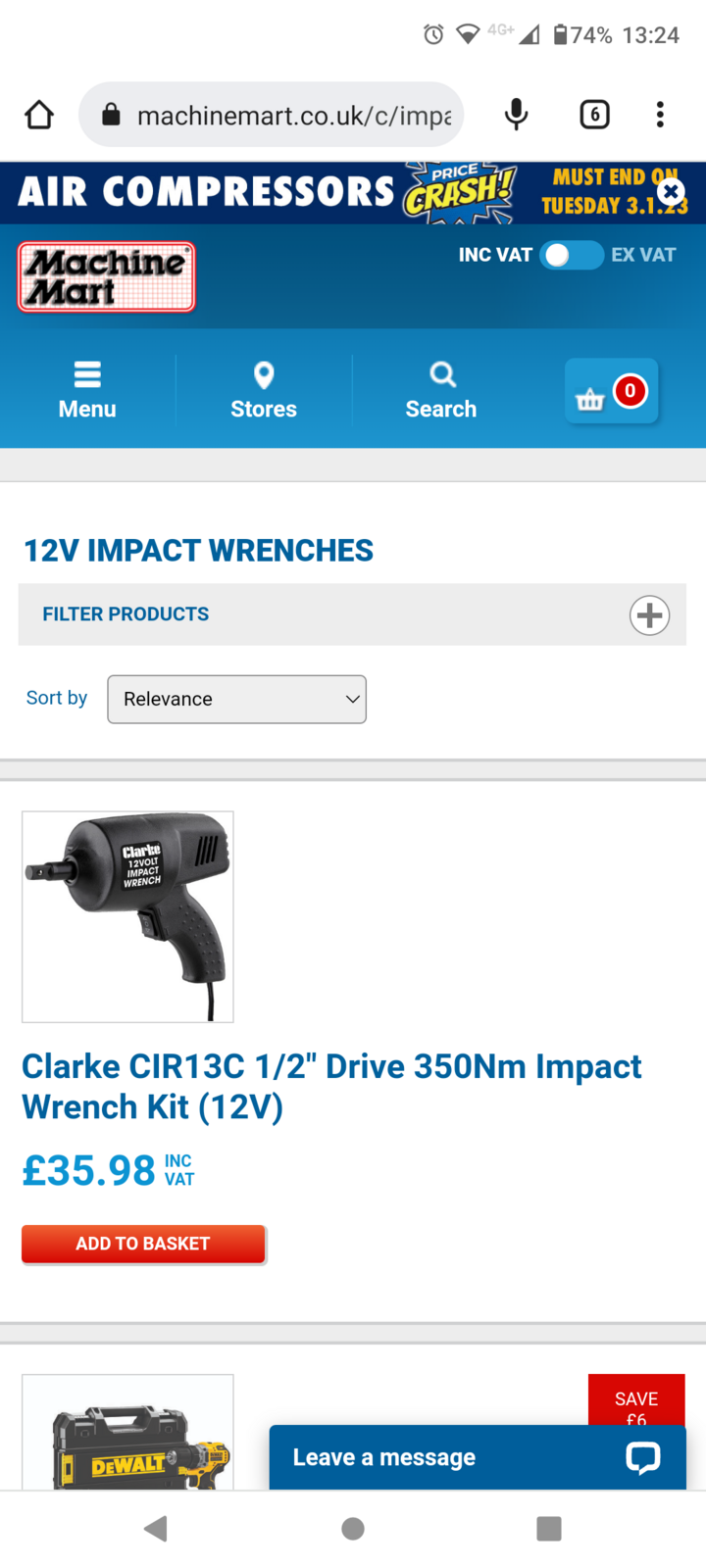

Don't use an Impact Driver to tighten wheel nut/bolts up. Instead buy yourself a Torque wrench (50 to 150ft-lbs) and use that. The car handbook will quote the recommended torque setting (typically 80ft-lbs/110 Newton metres).
it's OK to use the impact driver to remove wheel nuts.
