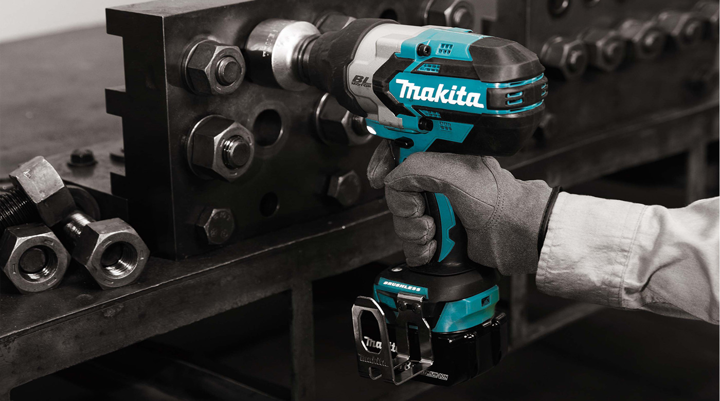

OP, You're best have a look on Youtube at some of the reviews on there of the actual model in action. If you pay too much attention to Roger he'll have you believe you'll need something like this to crack wheel nuts:
