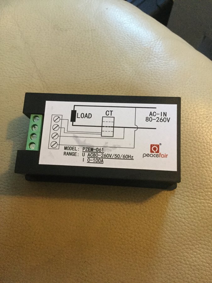

ok I have a Peacefair power meter with an impedance loop, a Chinese product and the wiring diagram is not clear,
The small loop appears to wire either way to the two middle terminals
Can anyone please explain if the loop goes over the live or neutral .. Sorry if it looks obvious but I'm not certain.. It looks like the neutral but ...

I assume that the 'impedance loop' you are referring to is the coil which constitutes the 'current transformer' ("CT"). It should not really matter whether you put it on the line or neutral (since the same current will be flowing in both) but, conventionally, one would probably put it around the L.
Kind Regards, John
Hello John, thanks for replying, yes CT I mean will go on L that's great. what is confusing me is the diagram can be interpreted that L could be either side of load ..
Put the CT on Live load, the lowest screw in the block be N .. Is that too obvious that I'm confusing myself?
As I said, the same current will flow in the conductors on either side of the load, so it doesn't really matter which one you put the CT on.
Do you not have a wiring diagram? I'm not clear as to what those lower two terminals are for, but I assume that the top two go to 'the meter'. Do the bottom two also go to the meter, perhaps to supply power to it?
You should make sure that something is connected to those top two terminals before you put the CT around the cable (or, at least, before any current goes through that cable) - since potentially dangerous voltages could appear between those top two terminals if nothing was connected to them.
Kind Regards, John
It's not marked because it doesn't matter what way around L and N go, or what conductor the CT is put on. The unit will require some sort of fuse though and must be installed in an enclosure.
That's the only diagram and yes the two lower terminals will feed for back light and display
Thanks EtH I have enclosure but can't guarantee there's an internal fuse .. So will factor that in
