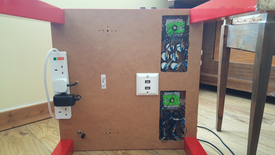

I'm currently building an arcade table. There are three mains powered components inside the table - speakers, monitor and single-board computer. The space inside the table is very limited so on a previous build I connected a standard 4 gang extension cord to the outside and brought the wires through so the plugs were connected to the extension outside of the table. This is shown in the attached picture (though the speaker in that case was USB powered hence only two plugs required).
I was hoping for a neater finish on the current build so that there is a single fused AC male power socket exposed and all other wiring is done inside the table. Unfortunately two of the three plugs are too bulky to connect to a 3 or 4 gang extension held within the table.

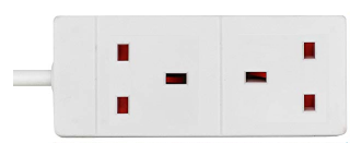

Other than rewiring to remove the plugs which isn't going to be an option, my only other thought was a special type of 2 gang extension. I could go back to USB speakers which would then leave me with two plugs, one of which can't simply be rewired. So is there something along the lines of this available anywhere?
I've never seen anything like it (and mocked that one up in paint.net) but I imagine there are a lot of electrical accessories that I've never seen. The power supply plug is bulky vertically but both plugs are no wider than the extension and the extension fits inside the table on its side.

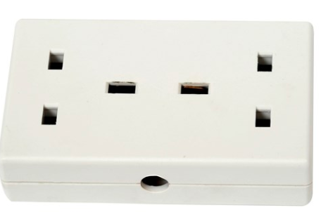

Would this this (click here) be of any use ....
So close to being perfect but the cable would have to come from the end. Great to know that this sort of thing exists though! I have a space of 45mm inside the table which will (very snugly) fit a standard extension on its side. Unless it would be safe to drill a hole in the end of that socket and redirect the cable to come out there?
Likely impossible; you'd need to fit a cord grip too.

So close to being perfect but the cable would have to come from the end. Great to know that this sort of thing exists though! ... Unless it would be safe to drill a hole in the end of that socket and redirect the cable to come out there?
I don't think that it would necessarily be impossible - it looks as if there may be a fair bit of space in there.
As for the need for a cord grip, that would probably not be necessary within the socket, if it is going to be 'fixed' inside an 'enclosure'. Some sort of clip/restraint outside of the socket, close to where the cable enters it, would probably be adequate. It might even be possible to fit a small 'stuffing gland' to the end of the socket's enclosure.
