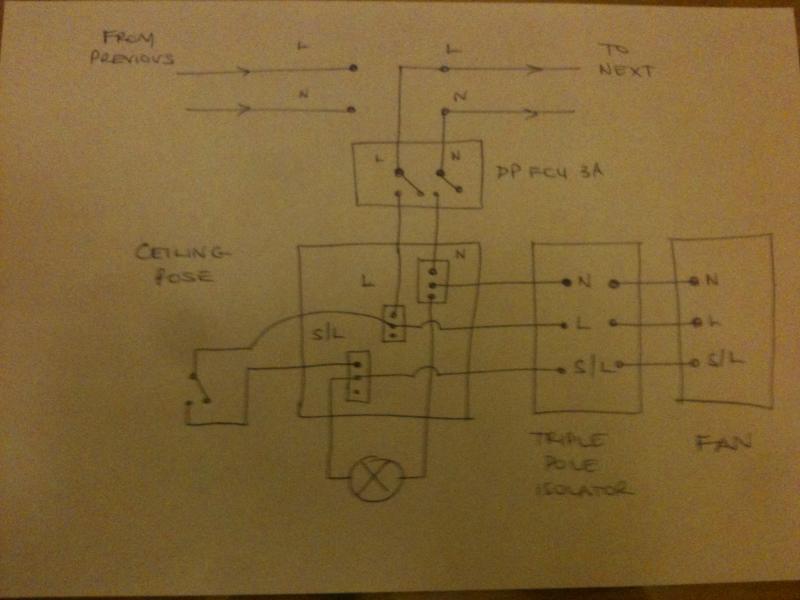

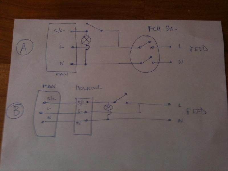

OK - bought the fan, and the instructions say use a 3A FCU to isolate outside the bathroom, but I thought that sometimes a triple pole switch is used.
I have tried to draw out both how the instructions say to wire the fan and light (A), and how I thought a triple pole would operate (B).
It seems a triple pole has the advantage of isolating the fan, but not the light, whilst a DP switch isolates fan and light, but do the regulations care what is done?
Your diagram B is correct.
Use TRIPLE and Earth to and from the isolator.
Sleeve the switched live with brown sleeve to indicate it is a live.
Take the earth to the fan and, if not required in the fan terminate it in a terminal block in case you change the fan to one that requires an earth.
Sleeve the earth in green / yellow.
Thanks - Yes, left earth out for ease.
BUT, if I followed the instructions in the Manrose Fan, they say use Diagram A - that's the DP version - would that still be OK, even though the 3A FCU isolates Light and Fan?
OK - As the MANROSE in-line fan instructions reads:
"A DP fused spur having min contact separaton of 3mm in all poles must be used and fitted with a 3 amp fuse".
I have to oblige - so I suggest to combine both diagram A and B - as such :
It seems daft to me that the fan has to have a 3amp FCU, as it appears that triple pole diagram B is what is normal.
The fan is a Manrose one, a fairly standard in-line fan from what I can see.
I plan to site the FCU and Triple Pole switch in a double back box above the door on the entrance into the bathroom.
Are there any thoughts on this please?
I believe it's the in-built timer that's probably rated at less than 6A or so, therefore needs protecting should there be a fault.
