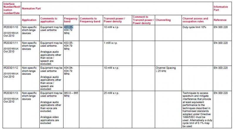

Total rubbish, even 300 mW is wrong. The voltage does NOT determine the effective power of the transmitter.
is page 17 from the regulations applicable to SRD radio devices.
http://stakeholders.ofcom.org.uk/bi...-tech-info/interface-requirements/IR_2030.pdf
Note 10mW maximum ERP
So the starting point is a 300Mw TX transmitting 10 yards.
Impossible in legal and compliant equipment.

Sorry but field strength is not measured in watts but in micro-volts per metre or milli-volts per metre.

The detectors cannot transmit at more than 10mW due to regulatory requirements.
