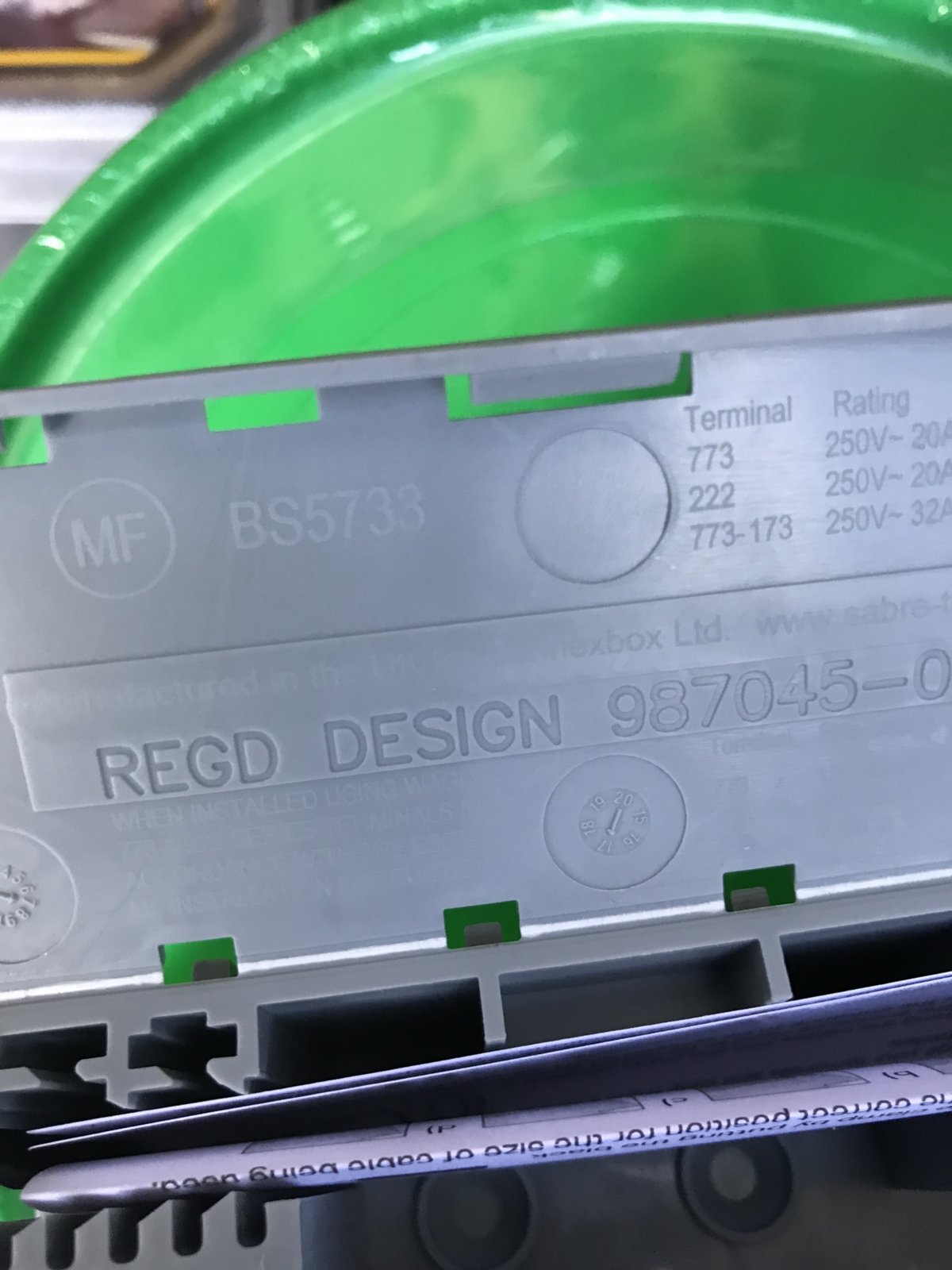

(2)Yes. The MF mark is on the underside of the Lid. BS 5733 requires the MF mark to be visible during installation.
Hmmm. There are umpteen photos on eBay of Wagoboxes with their lids open, and, having tried quite hard, I cannot seen an 'MF' mark on any of them. Has anyone seen such an animal which does have this marking?
.... The MF mark was introduced in BS 5733. For an accessory to have the MF mark the connectors and enclosure together must pass a number of tests specified in BS 5733.
Again, we need to know about these requirements and tests.

221s are fairly new so they may not have updated their information and moulding - or they’re just not suitable (don’t see why they wouldn’t be)
Thanks for the photo, Iggifer. I must say that, even now I know where to look, I can't see the MF mark on any of the eBay photos I've looked at!
Maybe older stock doesn’t have them, I’ve only bought those within the last week. It’s also quite hard to photograph as it’s not impressed very deep.
Maybe the Wago retainer is the reason, but they could use some removable rubber inserts like they use for the cable clamp if they wanted to I suppose
Indeed. All the photos I've seen show pretty different markings from what you have shown us.
