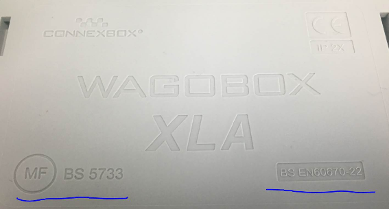

The MF instructions limit the number of circuits to 1 and the maximum aggregate current permissible for any particular circuit configuration. Here is a picture of the lid from a Wagobox-XLA showing the MF mark.
Hope this is helpful.
I haven't the heart to ask to see the outside of the lid of the XL rather than the XLA.

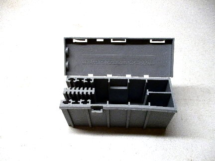

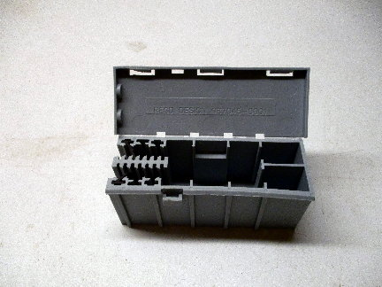

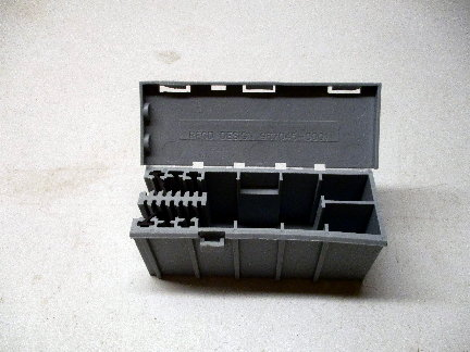

I've just looked at the ones I've got, bought around 5 years ago. When just looked at casually, this is all one sees (i.e. nothing other that the "Regd Design" number) ....

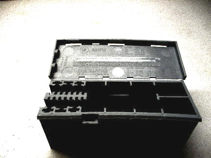

However, if one lights it from exactly the right angle (pretty critical), one sees exactly the same as you posted (I've had to play with contrast of photo to show it here) ...
... so it seems that the MF marking has probably 'always' been there, except that it was not visible enough for us to notice it!
