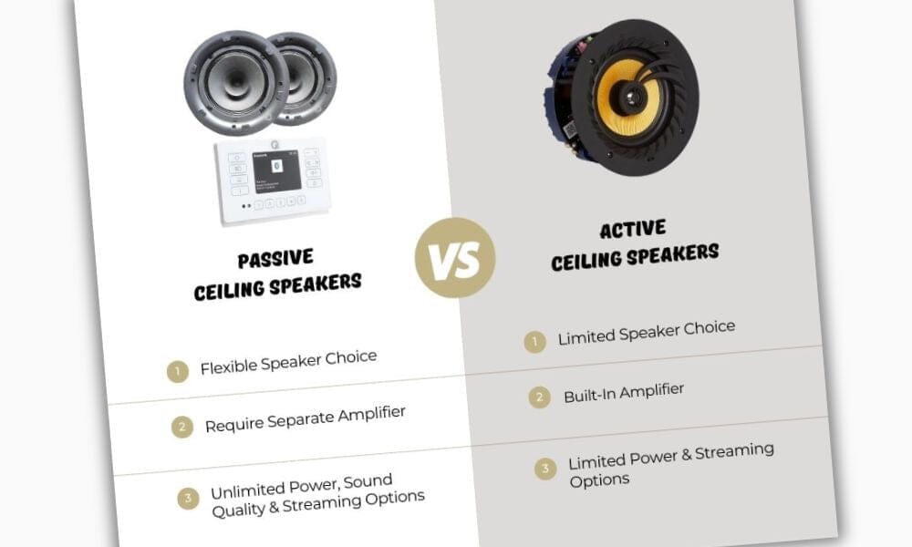

Thanks. Speakers therefore are passive? i.e. they just need audio cables from the amp to the speakers, no power required?
So you are saying I don't really need a wall control unit, but just an Amp somewhere which connects to a BT receiver? And then everything is effectively controlled via device (whatever I choose to connect to that BT receiver?).

The following might help

Most speakers are passive i.e. need a power amplifier to make a sound. You can get active speakers with an amp built into them, but they are more like bookshelf speakers. They will also be not as good as "separates" because they cram a small, cheap amp into the speakers. That's never going to be as good as an external amp. Even the little units like @freddiemercurystwin posted are really good for the money - and take up less space.
Speaker wire is quite cheap (£1/metre) for basic stuff and that works fine. You can spend 100x that but you won't norice any difference with a budget setup.
You could consider bookshelf speakers in each corner of the room, as I said above it depends how greasy your kitchen gets. Wipe your finger across the top of one of the units and you'll soon see.
Advantage of ceiling speakers is they're designed for the job, flush mount, and the cabling can go through the ceiling cavity and come out behind a unit for example. Or Bookshelf speakers will look nicer if you have room for them, i.e. make them a feature, and the sound quality will be better.

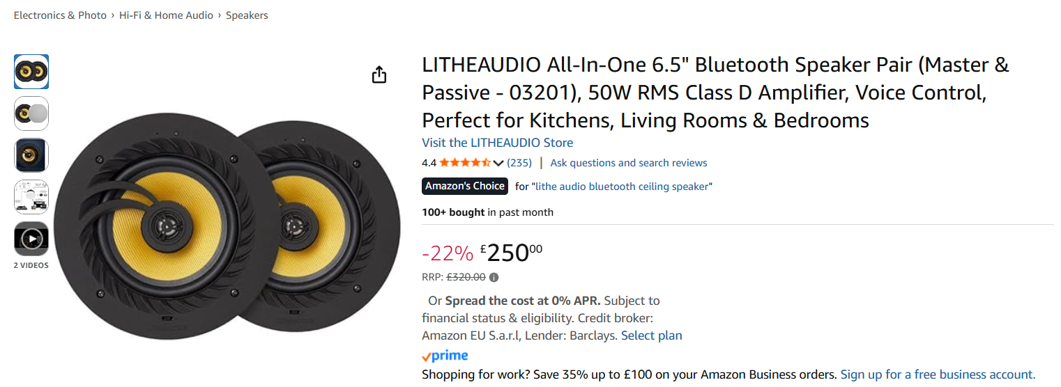

For someone going down the DIY route, I would strongly recommend something along the lines of Lithe Audio's active in-ceiling speaker kit.
There's one powered speaker and one passive speaker. Your spark can tap into the lighting circuit for the powered speaker. The passive speaker runs via a speaker wire from the powered unit. There's enough power here for an average-sized kitchen, and the Lithe smartphone app gives you EQ control. If you'd prefer to have some sort of permanent controller always available in the kitchen, consider buying a small Android tablet. The app can run on several devices.
Streaming quality varies quite considerably depending on the service and whether you go free or paid tier. Bluetooth will also leave its fingerprint on the sound. This system is certainly good enough to let you hear the differences between Spotify and Tidal, but maybe not so much between Tidal and Qobuz at their best. For that, you'd need to switch away from the bottleneck of Bluetooth streaming and go Wi-Fi instead. A Bluesound Powernode amp and Bluecube speakers would be the level, but you'd be looking at £1.400 in hardware rather than £250.

The Litheaudio system seems like it is always on? I.e. one could install a switched spur in between to be able to completely switch off the system when not in use.
This is true of all this kind of tech, whether it's Lithe, QAcoustics, Sonos or something else. TVs and soundbars are other examples. Low-power standby allows for OS updates in down time, and for the gear to be ready without a lengthy booting process or dropping into OS update mode just at the wrong time. You can fit a switched spur though.
