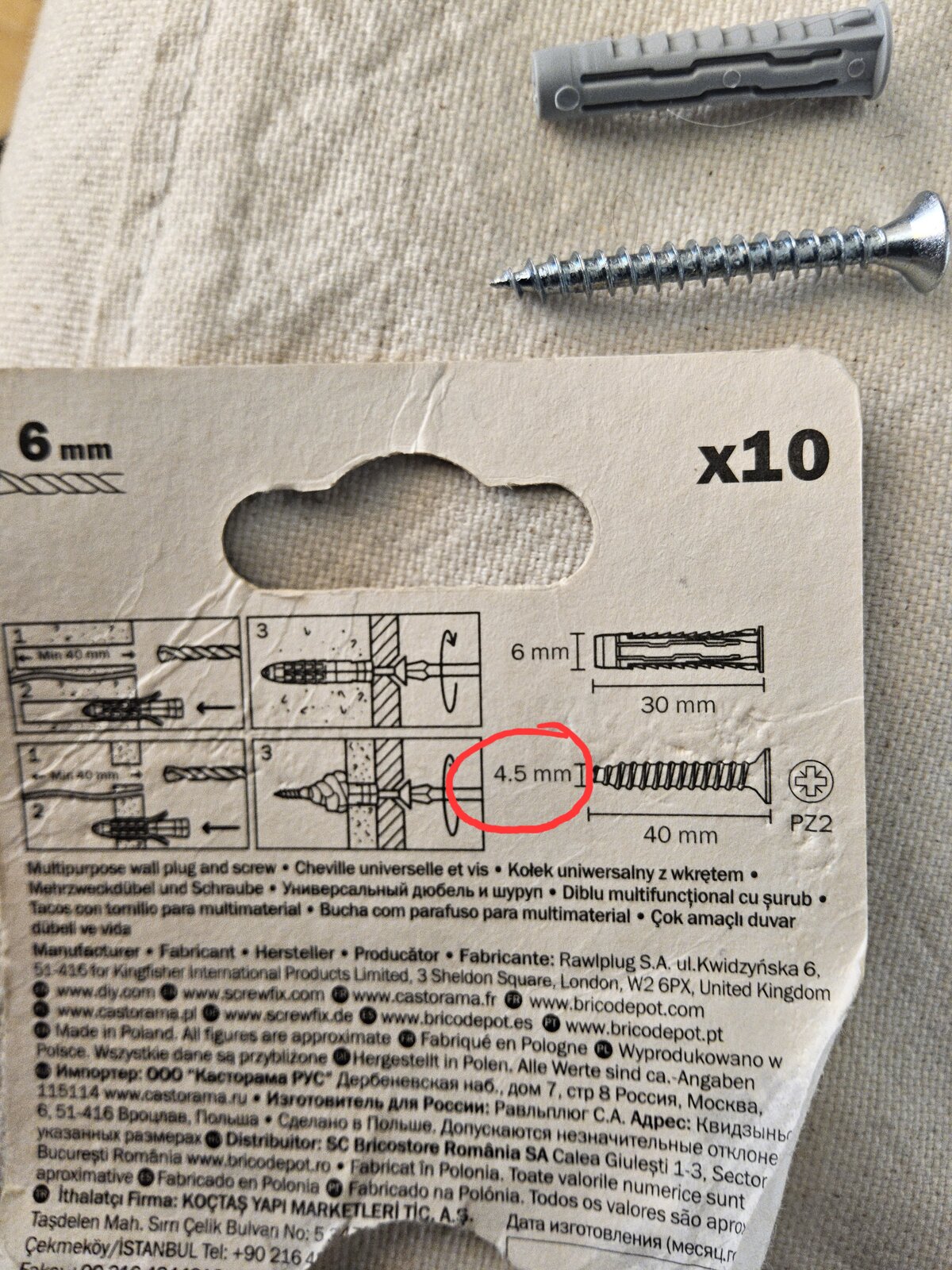

I require to drill screws into wall board (to hold a cistern in place) and believe 4.5x40mm screws will be sufficient (with wall plugs). This is the screws and wall plugs I have.
I draw your attention (circled in red) to the specified diameter of screw on the instructions of the pack.

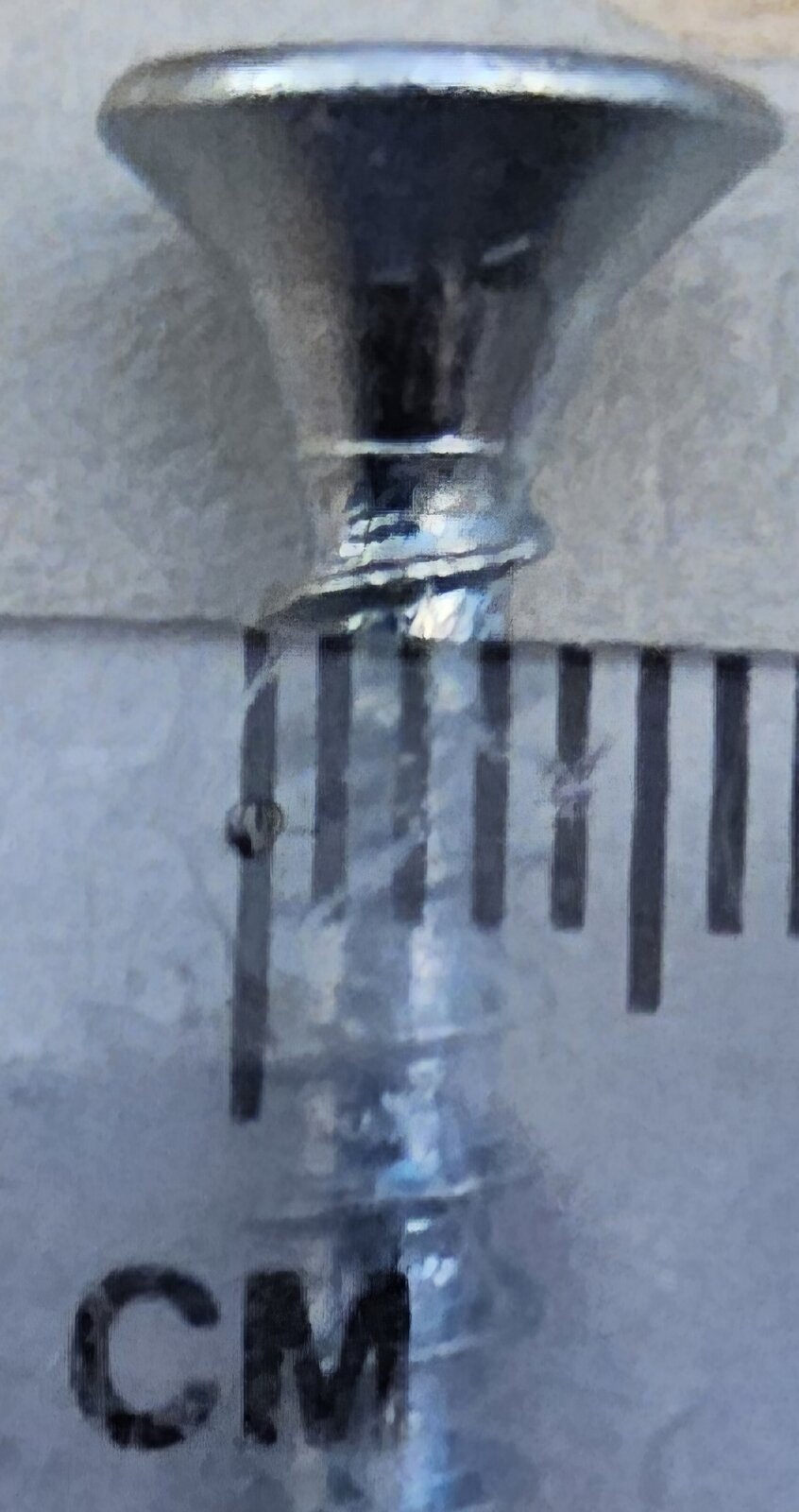

I measured the diameter of the screw and took this photo.
As you can see, using a ruler, with each black vertical line representing a mm, that the diameter of the screw is in fact 4mm.
Is this normal practice to overstate the diameter of a screw or is this a mistake? The reason why I ask is I wish to purchase stainless steel screws to use with these wall plugs but am unsure of whether to buy 4mm or 4.5mm diameter screws?

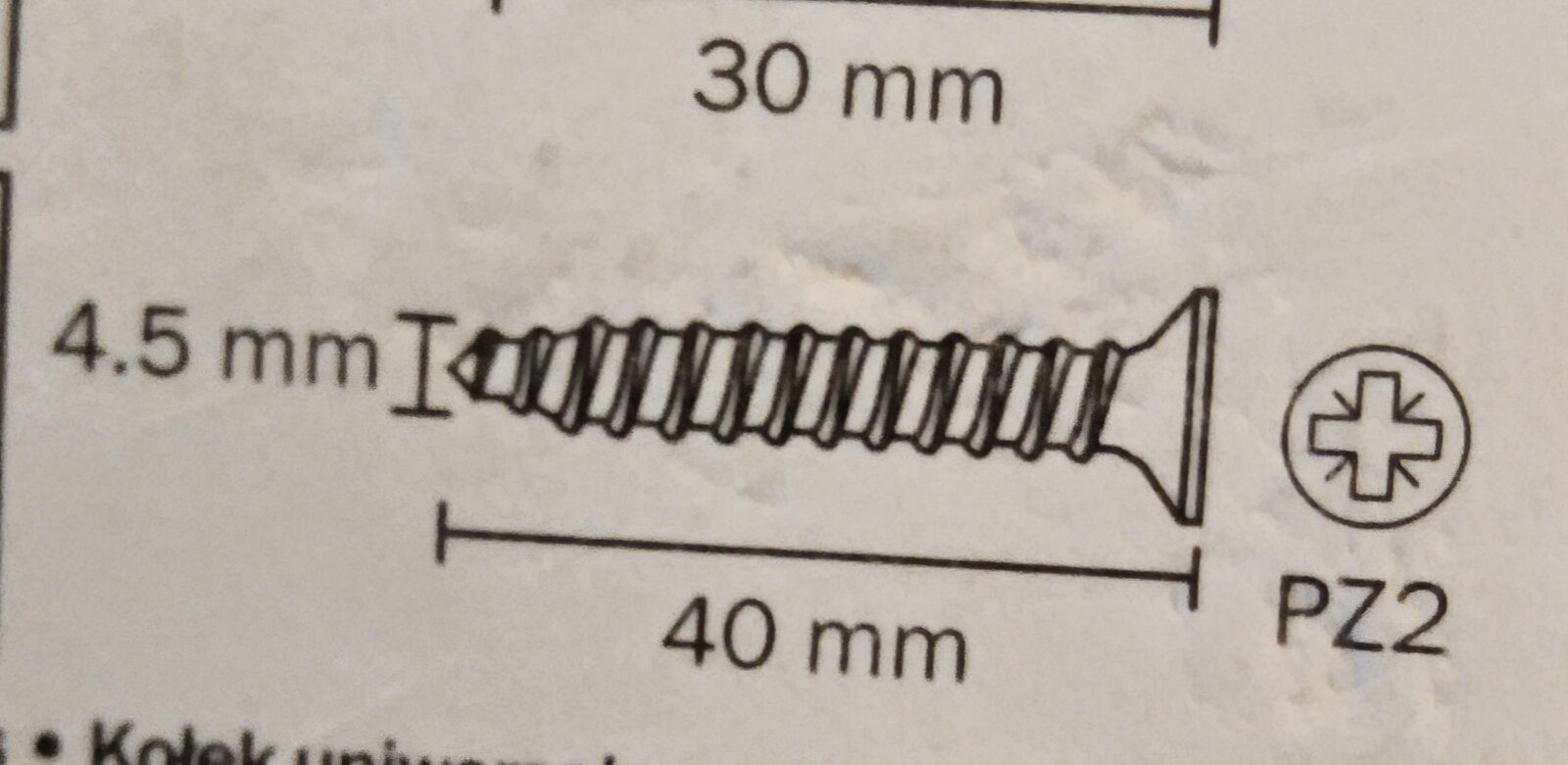

Just for clarity, here is the unmarked and enlarged diagram of the screw in question, that claims to be 4.5mm but I measure (see photo above) to be 4mm.
as i say you measure the other end it will be shown that way for clarity

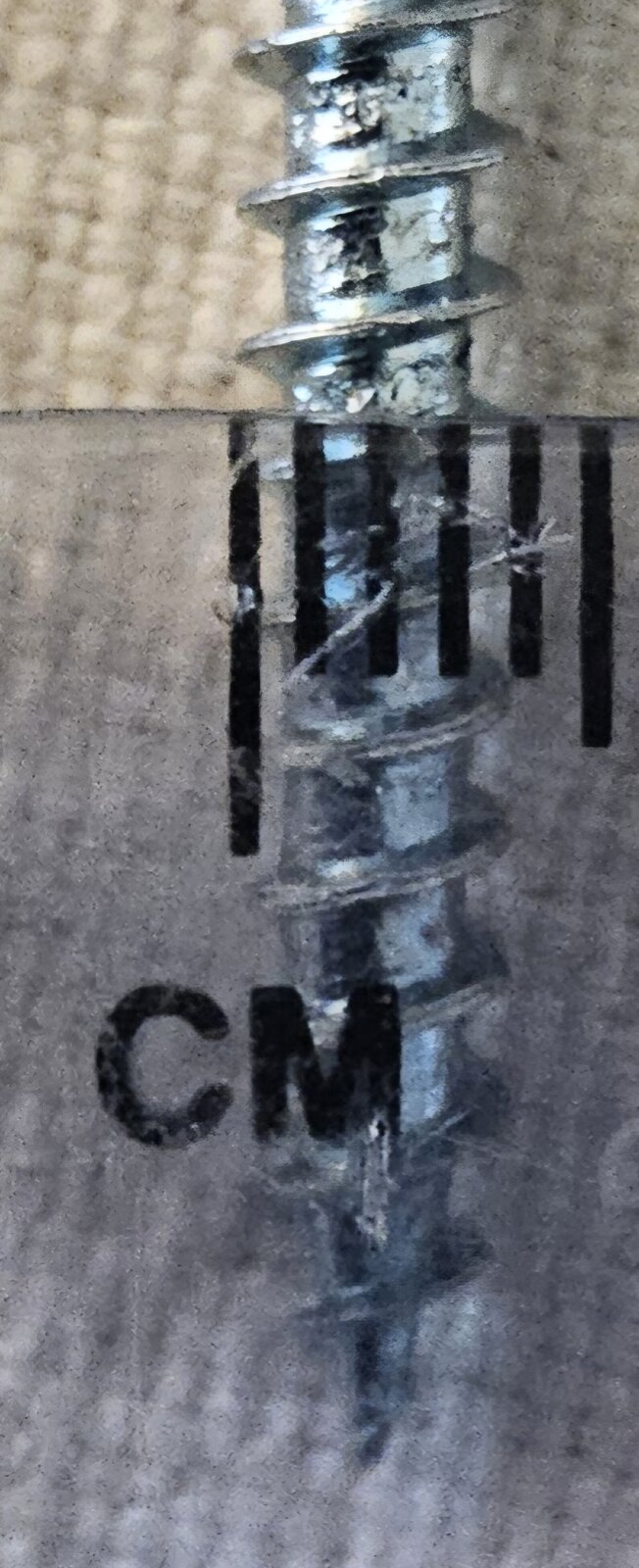

Here is photo of 'shank end'?
It's still looking like 4mm.

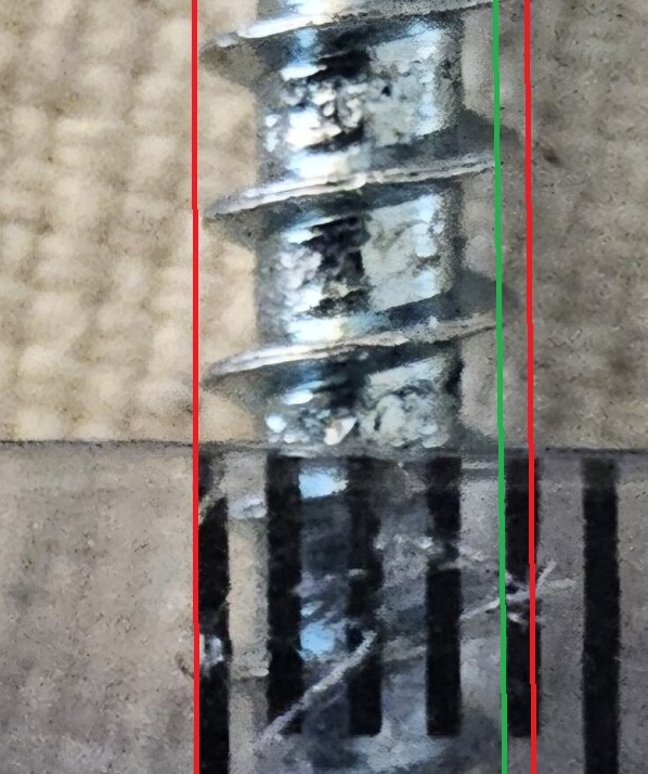

The screw is more than 4mm, even compared to that crude measuring device.
Left red line to the green line is 4mm. Screw extends to the second red line, which is pretty near 4.5mm
