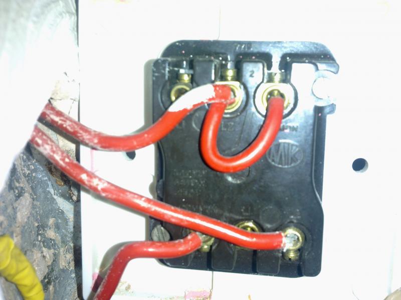

Hi,
My double gang light switch went 'pop' last week and I have bought a new replacement, But when I opened the old switch to disconnect and wire in the new one, I was confused and concerned by what I saw. So I looked on this forum for wiring diagrams and now I am even more concerned because it appears my existuing lightswitch (which has actually worked fine for years) is in fact incorrectly wired. Can anyone advise?...
Its a double gang two-way switch, but is only being used as single-way, switching two sets of lights.
The Common of one switch (for clarity, I'll call that Switch A) is actually looped by a small wire to the L2 of the other switch (switch B), which is also fed by a red cable, into L2.
The there are two other red cables connected to each of the L1 and L2 of switch A.
So, Switch A appears to be using all 3 connections, with common looped to Switch B L2. And switch B L1 is vacant.
Oh, and there is a black cable running behind the switch, not conected to anything (appears to have been joined, but not sure).
My new replacement switch has connections labelled 1, 2, 3 for each of the two switches. I have no idea what from the old to connect to what on the new!
Can anyone help?

It sounds like you have a live supply feed coming in at the L2 position of "B" which is linked to the common of "A" then a two way function at "A" the black cores are a looped in neutrals.
Photos by any chance?
Connect the new switch exactly as the old one was, including transfering the small link wire from the old switch to the new one. Leave the black wires as they are.
That's fine. The red wire will be your live feed to both switches. The fact that it goes to L2 on switch B instead of COM is not a problem. The switch will work perfectly well like that. :) :) :)
Which suggests that it's been part of a two-way switch setup in the past. Since it's only used as a single now, one of those two red wires will be switched live to a light. So far so good but, if it was mine, I would really, really want to know where the other one went. :confused: :confused: :confused:
You don't mention any wire in switch B COM. They must be (or must have been) or else that switch wouldn't have done anything. have a look at the black wire you mention. Could it have fallen out? :?: :?: :?:

Likely 1 = Com, 2 = L1 and 3 = L2 but as an electrician I would test with a meter to be sure I don't rely on marking.

If both L1 and L2 are used it's two way lighting. On/off only uses either l1 or L2 not both. Com is always used.
Aha. So by connecting the bridged wire to both 1's on new switch, I'm effectively re-wiring differently (to before), but correctly (now making both switches operate the same, instead of one being wired the reverse of the other?)?..
In your pic, connect the top wire and the link wire to the two "1" terminals on the new switch.
Connect each of the bottom two wires to the "2" terminals. One wire in each terminal.
That's it.

The picture actually shows the wiring for two switches you have to look at the connection drawing a diagonal line across the switch
.L1(A)..... L2 (A)... ./.. . COM (B)
(...Switch A.........)/(....Switch B....)
......... COM(A)...../ .... L1(A)... L2(A)
and do as RFL has instructed
