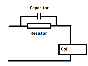

With a 1 megOhm resistor in place select the capacitor value such that the coil pulls in for about 1/10 of a second before dropping out.
The resistor at this stage is only there to discharge the capacitor between tests.
Second
Select resistor value such that the coil does not hold in on the stray voltage, then add 10%to the value.
As John has said finding the source ( or reason ) for the stray voltage and removing it is the best option.
Interesting circuit but it only works for a pulse input. The capacitor will block steady DC and hence the relay will fail to hold in (the resistor value being too high to supply enough hold-in current)
The resistor value is chosen to be such that the current is more than enough to hold the relay in when the 12 volts is present.. As mentioned the high value resistor is only used while testing to ensure that the capacitor is discharged between tests.
