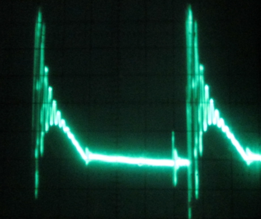

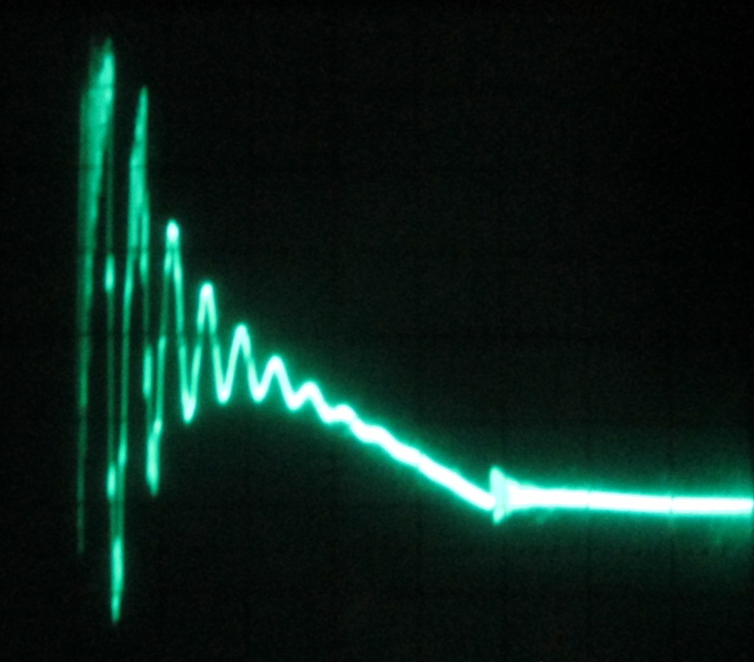

Further to the above, and as one might expect, when one increases the load (this is about 360 mA, i.e. about 4.3 W), things get somewhat 'cleaner' - that 'pulse' is around 30mV at its peak.
What I don't fully understand is that, although I don't think it's a problem as it is, I am not having much success in significantly 'suppressing' that pulse with RC filtering ....
Kind Regards, John

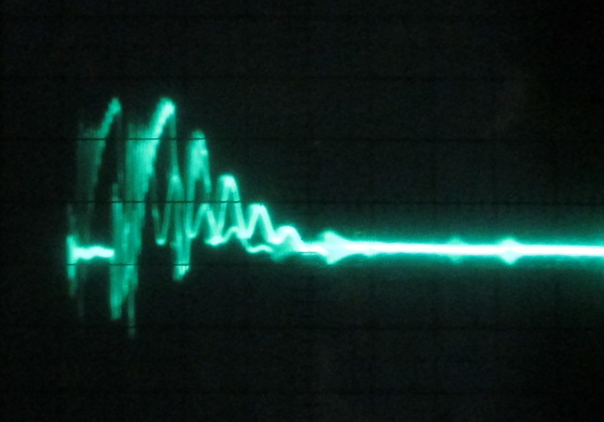

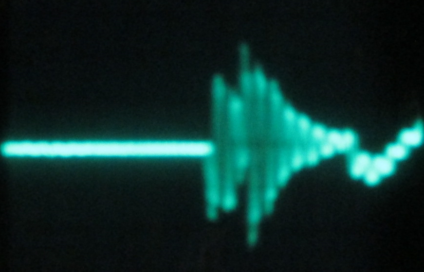

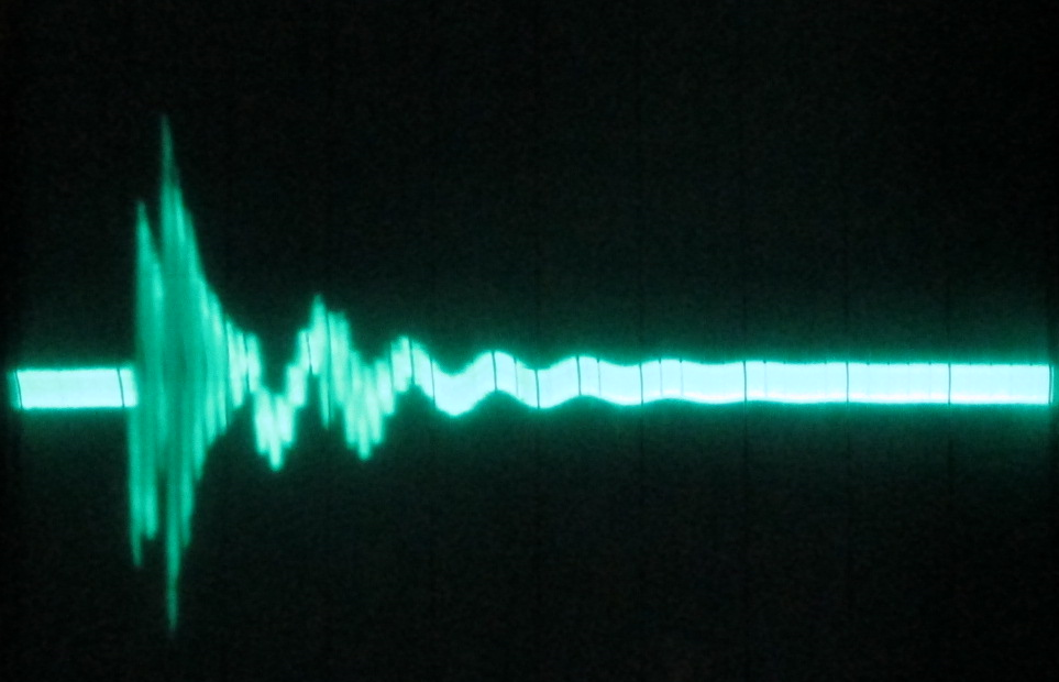

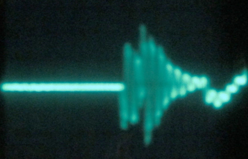

To get an idea of the size of the issue, leave the scope earth where it is and put the probe on the earth point as well.
Very interesting! Qualitatively similar (but now pretty symmetrical around 'zero'), but with a much higher frequency component (~ 30 Mhz) superimposed on the ~70 Hz 'pulses'. If I touch either or both sides of the PSU output, or even put my hand on its case, the amplitude drops by about 25-30% (all that with an ~360 mA load). It's certainly all coming from the PSU (rather than the BBC or whatever!), since the 'line becomes totally flat' on the scope if I remove its 230V input. In both of the following, the peak-to-peak voltage is around 40 mV; in the first, the x-axis is 0.5 μs/division (you can just about see the 'divisions') and in the second it's about 0.17 μs/division (a third of the first one) - with apologies for the not-too-clear photos! ...
