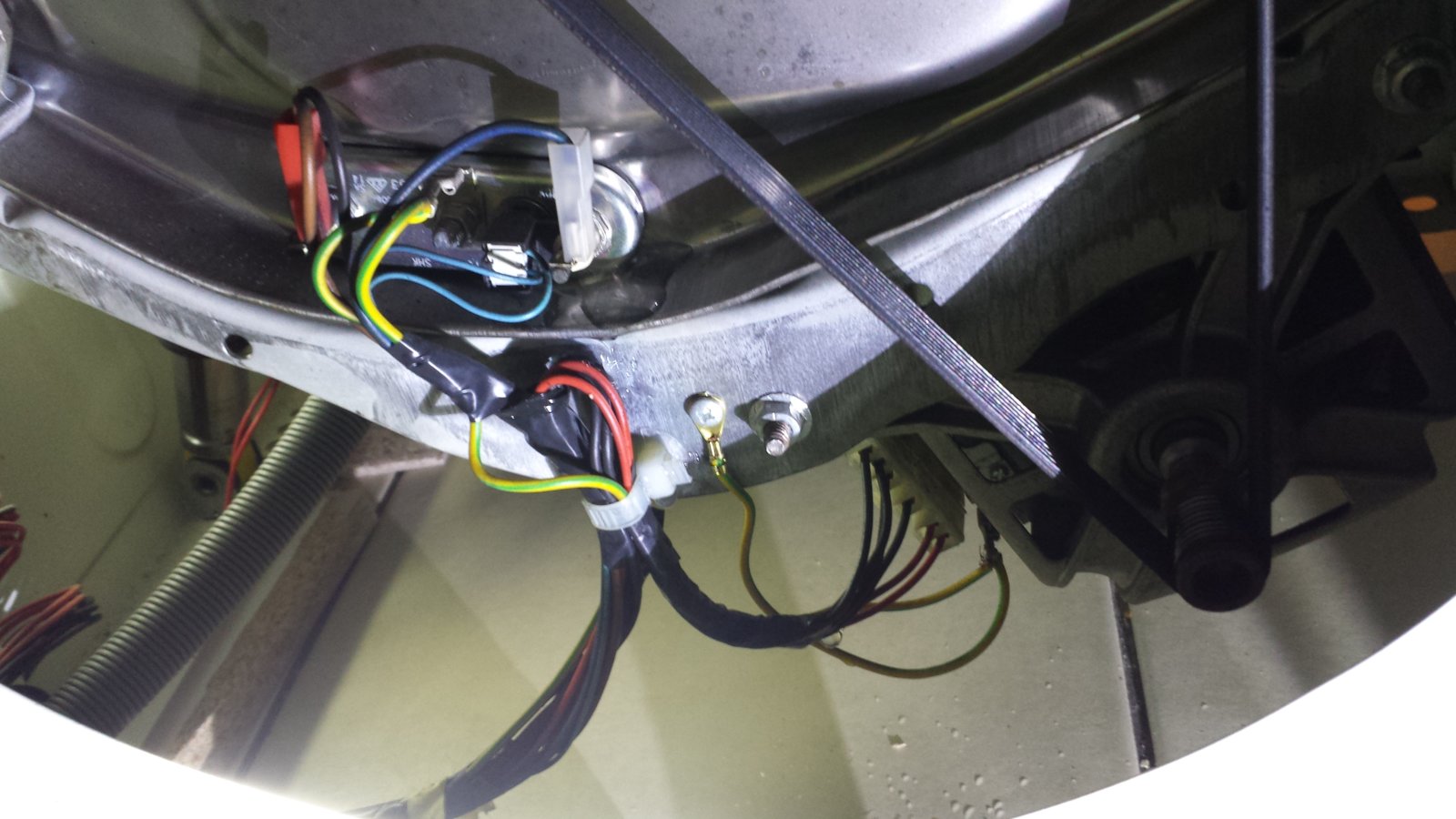

The machine appears to be leaking at the rear from a plate with electrical connections, attached to the outer drum.
Is this an easy fix, worth repairing?
Suspect it is a gasket fail for heating element.
Model is WM12X

That is definitely the heating element. Has it been replaced before? - the black tape is rather untidy and not what you would expect from a factory installation.
The single nut in the centre holds it in place - tightening it will expand the rubber seal and may stop the leak.
If not, loosen the nut and the element will pull out. Should then be obvious where the leak is.

Thank you flameport.
The bolt was not on tight at all.
Tightened several turns by hand with screwdriver bolt attachment.
No leak!
