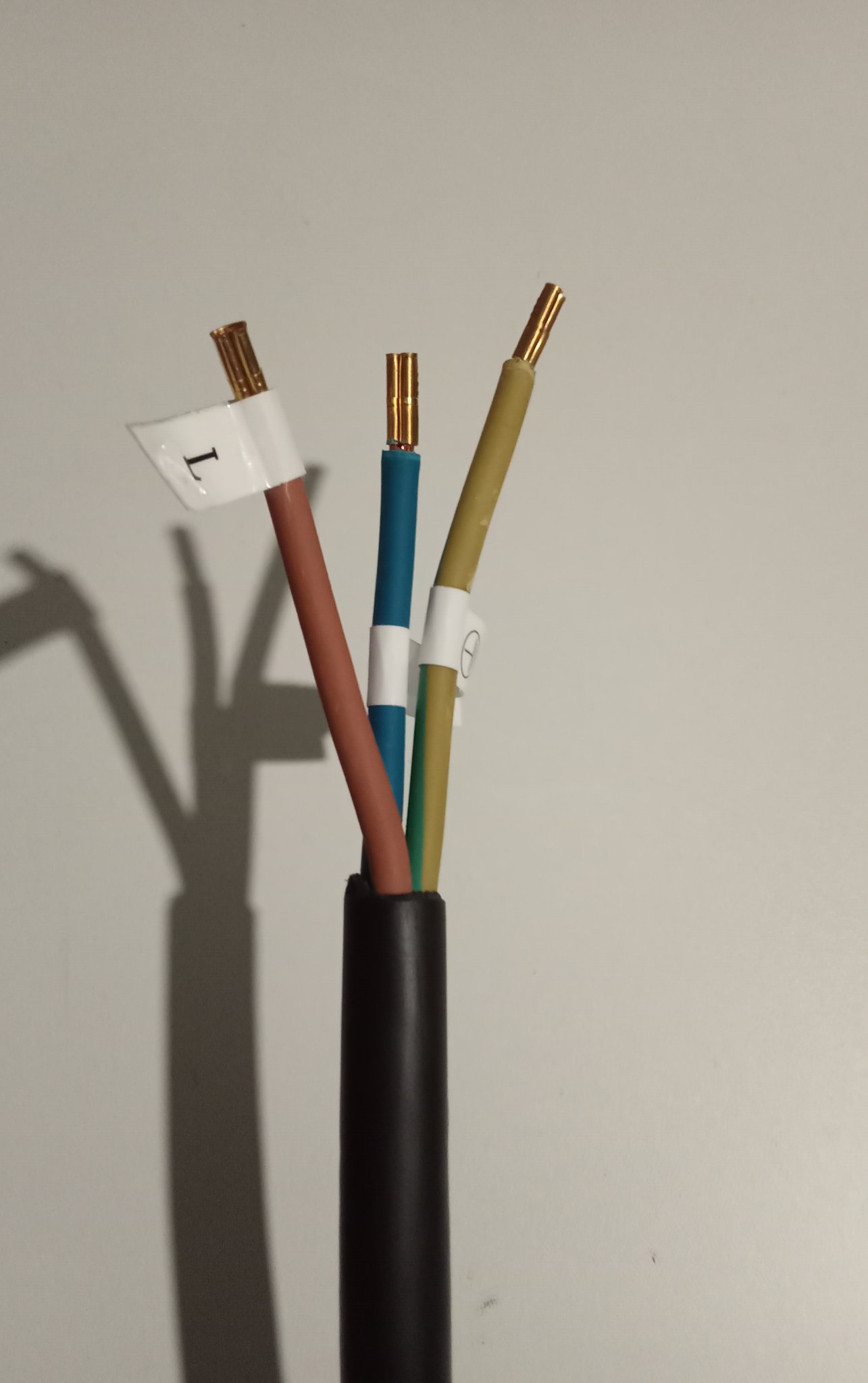

The manual gives the total power as 7335W. The cable is 3 core, pic attached.

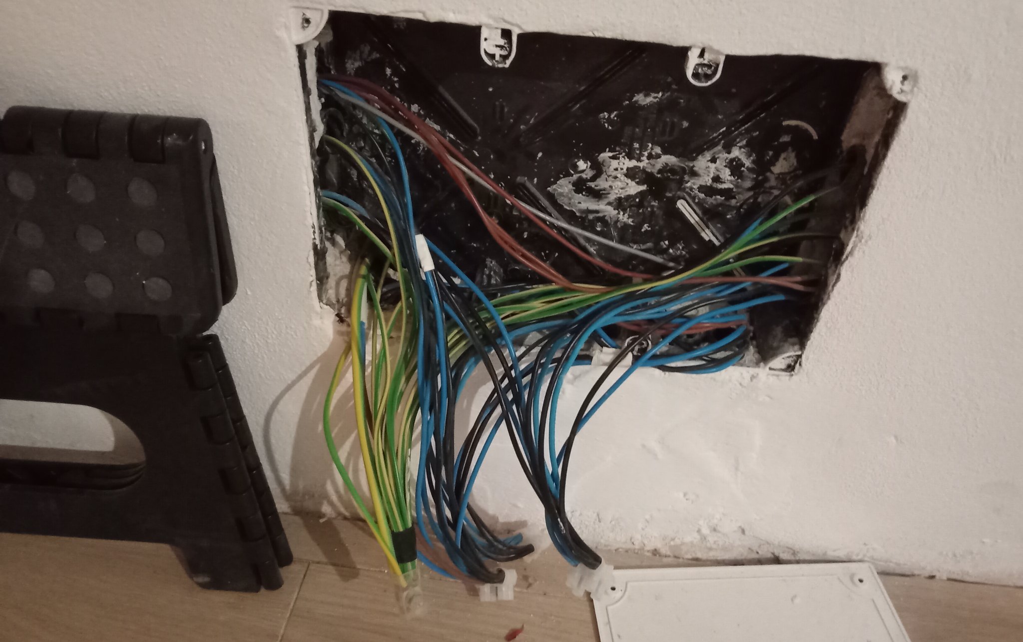

In terms of "opening walls", in Spain, everything runs in conduit (in walls/floor) with wires joined at junction boxes (see example pic). Theoretically, if there's enough space in the conduit in the junction box nearest the hob, a cable could be pulled through. The problem is, that junction doesn't seem to go direct to the consumer unit and if you can imagine JBs in every room, with wires going through perhaps multiple JBs, pulling a cable through won't be physically easy, even if you can trace a route to the consumer unit. Maybe someone experienced could work it out but I'm struggling.
The pic is of the JB nearest the hob and it all looks like 2.5mm cable.

I know but inferred from the electrician‘s comments that the existing conduit is too small for another three 6 mm2 singles, which means you‘d have to chase for another length of conduit, probably 25 mm.
Not an attractive proposition. It would mean up one wall from CU, across another, through another wall, up through the ceiling and down another wall, then under the floor lifting 7 tiles. Or, lifting 35-40 tiles. The tiles are rectangular 'planks', not square. We don't have that many spare and I wouldn't expect to get a good match with new ones.
