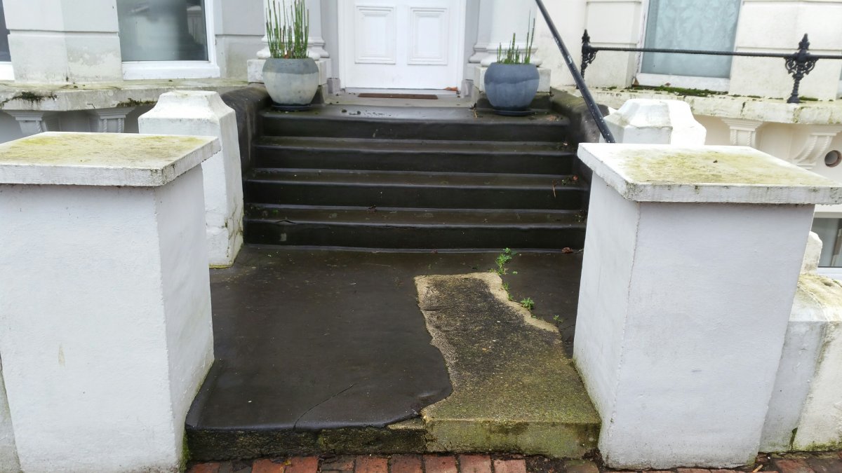

We will get the building painted next year and it would be great to get these stairs looking much better when we paint the building and looking or idea on the best option.
What do you think we should go for?

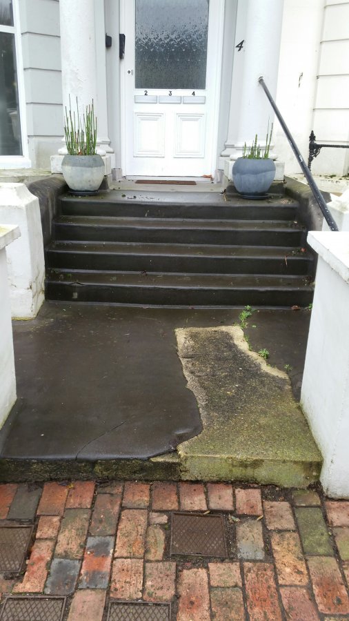

Your lovely building needs quite a bit of remedial prep work before any painting.
The steps and entryway have been damp-proofed with bitumen but where its worn away no bitumen prime can be seen.
The entryway concrete is a remedial repair from some time in the past and seems to have damage and cracks?
I would imagine that the damp-proofing took place to protect the cellar interiors and the areaway below.
Is damp penetrating into the basements or the areaways?

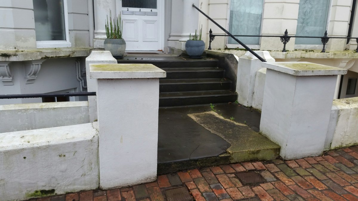

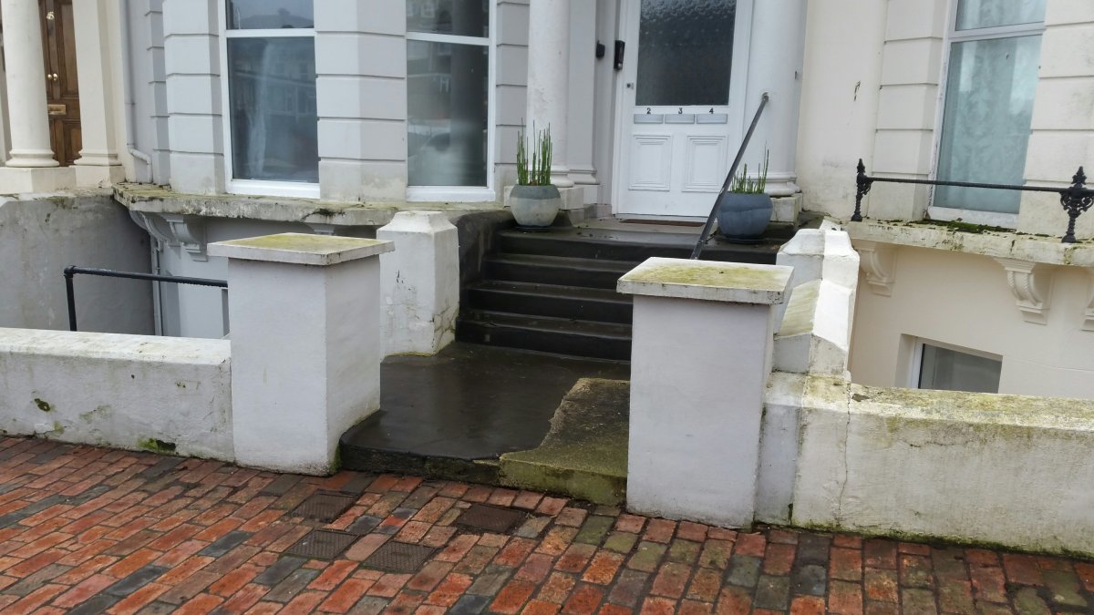

Without seeing pics of the whole elevation and pics of the areaways I couldn't give even a rough idea of whats needed.
Are there any damp signs in the basement rooms or inside the upper rooms below the window boards?
Whats the condition directly below the steps - are there store rooms?
And whats the condition of the rendered "parapet" walls & posts - the pic shows cracks and failing render on the top and front of the "parapets".
The entryway concrete slabs have been laid in four pours and are suffering from movement and water entry.
What about the pair of steps leading down to the areaways - whats their condition?
There's what appears to be gutter sludge on the window sills - what condition are the gutters in?
"waters flowing on the wall of the cellar" - inside the building or outside?
What do you mean by "normal water infiltration"?
The brick pavement is humping in front of your entryway - between two external mains water shut-off covers.
Until you know the condition of the underlying structure to the steps its not worth doing anything. Anyway, simply applying bitumen over bitumen will not work.
