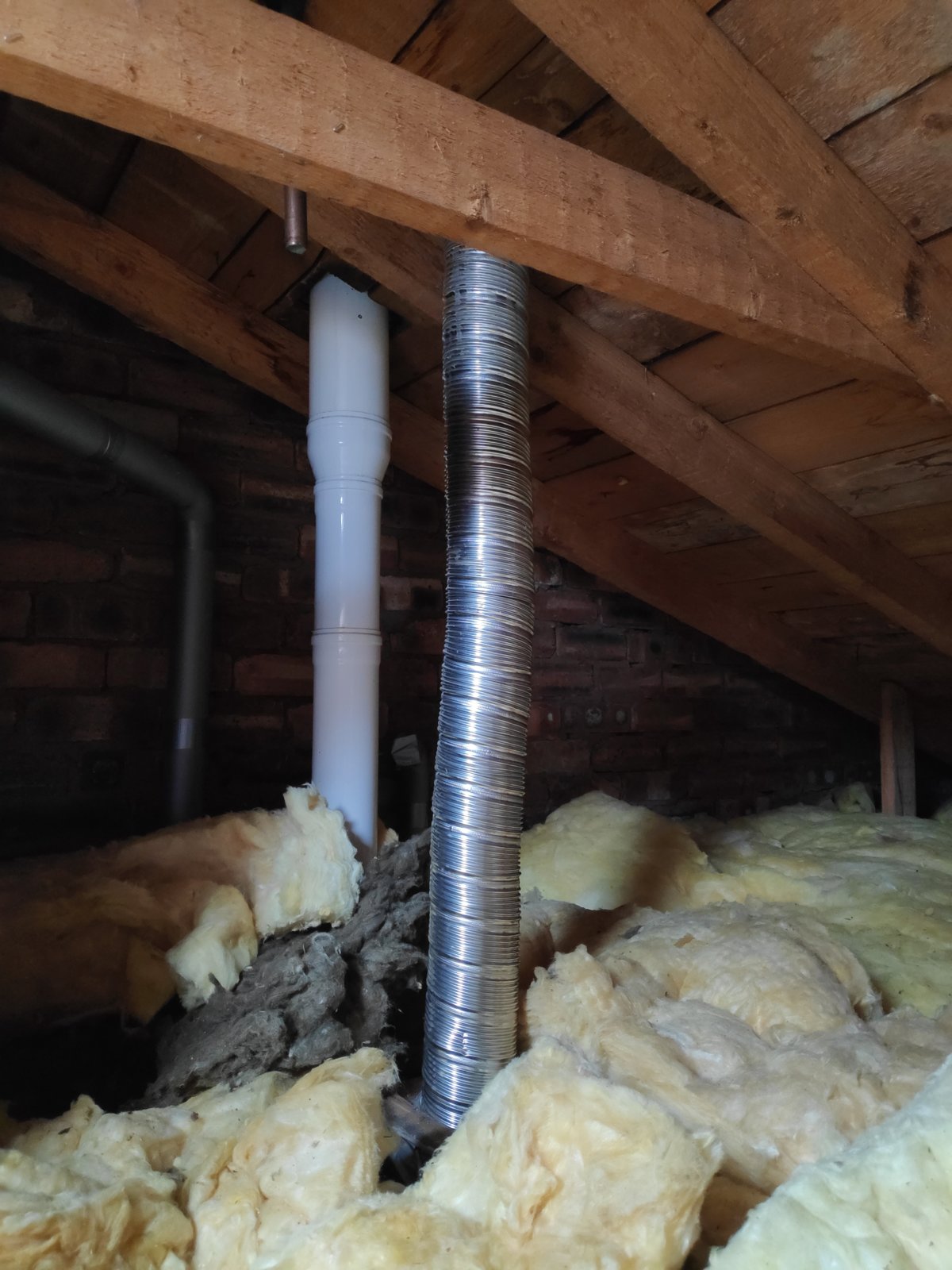

Hey all,
Looking at installing an inline extractor for the bathroom in the loft above as got plenty of access up there. Couple of questions:
1. There's an old aluminium flu up there from an old boiler, it goes directly up and out the top of the roof. Would I be OK connecting the extractor to that?
2. I'd like to use the fan with a humidistat, but would it be possible to have a switch or pullcord to manually turn the fan on if required?
3. When taking a feed from the lighting circuit in the loft, should I run that to a switched fcu then into the fan?
Thanks a lot,
Michael
I suppose I should say if suitable which isn't much help but it is just a hole after all.
Is it a flexible gas flue?
Sorry, I added a picture after posting. I think it's a flexible one yes.

Yes, pipe looks fine. You might need a condensate trap to stop any running back into fan and/or some insulation around the pipe.

Think we will give it a go with a pullcord only and see how we get on. Don't want it to come on with the light as we never need the light on in the bathroom in daylight hours.
Might be able to tie the condensate trap into the boiler condensate too!
