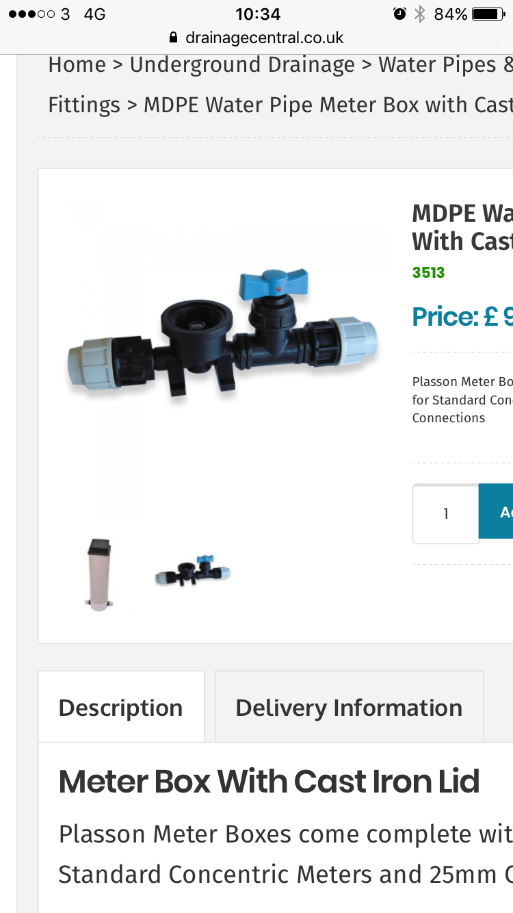

I'm on a job looking for a water leak. The house is the end 1 on a shared supply of 4, I can't hear anything on the external stop tap but can hear a faint noise on the internal one. The house has been extended over most of the supply.
I would normally dig at the boundary, cut n cap the pipe and listen again but that won't work here.
If there was a meter I could connect temporarily at the boundary it would confirm if there was a leak under the house.
Does anyone know of a meter or flow indicator that could be fitted onto 25mm MDPE in a small space?
I suppose I could use a normal one but don't keep them on the van.
I need the internals of a standard boundary box.
