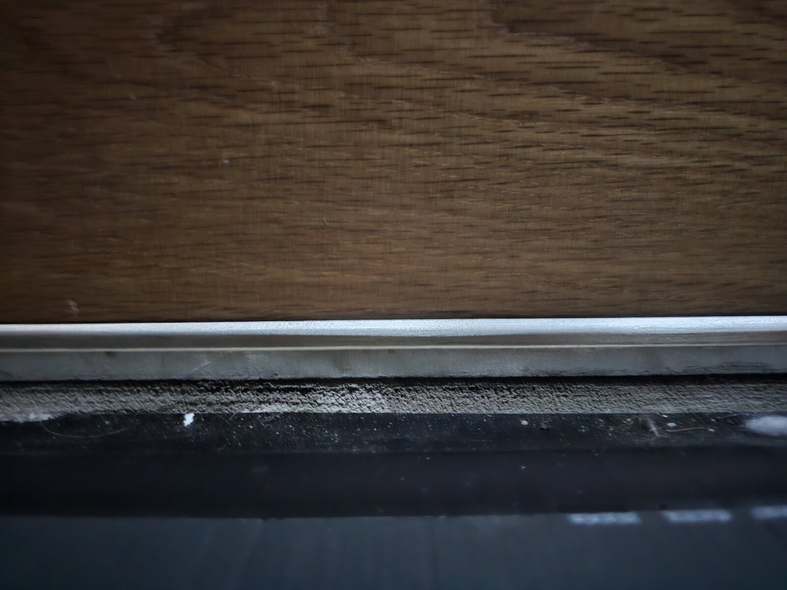

Right, could be onto something with the door gap, eye balling it looks to be 4-5mm on average. If 10mm is the minimum... What's the ideal? Guessing not much more as poor aesthetics would come into play.

3 of the 4 walls are internal walls ie aren't insulated whereas the one external wall and the ceiling have 150mm PIR. Extraction works fine up to the 10 mins mark, no obvious signs of condensation etc but when the kids go for their long dramatic showers it turns into a rainforest. All windows have trickle vents and extractor set to continuously on (and boost with light switch/humidity)
So do NOT open the window, increase the gap under the floor AND extend the time the timer overrun boost runs for to at least 15 mins.
This sounds like a good plan.
Thanks all for your help, very much appreciated
