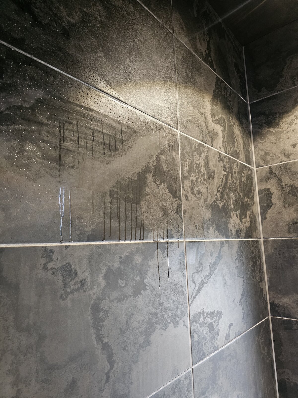

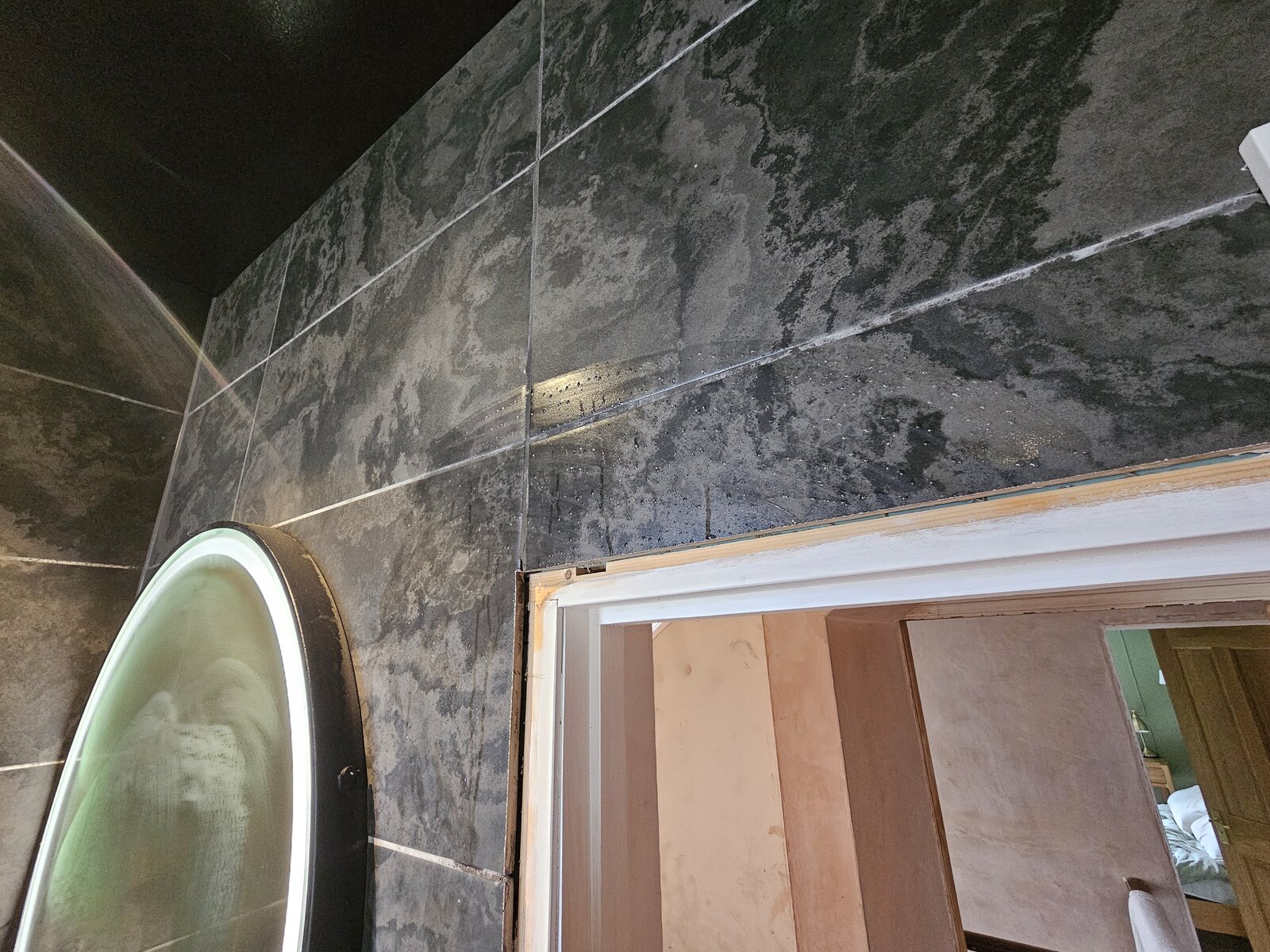

Just a bit of an update, post testing... Left the bathroom door completely open and ran the shower for 30 mins.
Top 2-3 lines of tiles around whole room started to get moisture build up after around 10 mins and stayed fairly stable at "damp" until gone 20 minutes but approaching 30 mins the walls were clearly wet and dripping.
Ultimately message to the family is shorter showers but curious to know if there is any extractor setup that can handle door/window closed and get the room to the 30 mins mark dry?

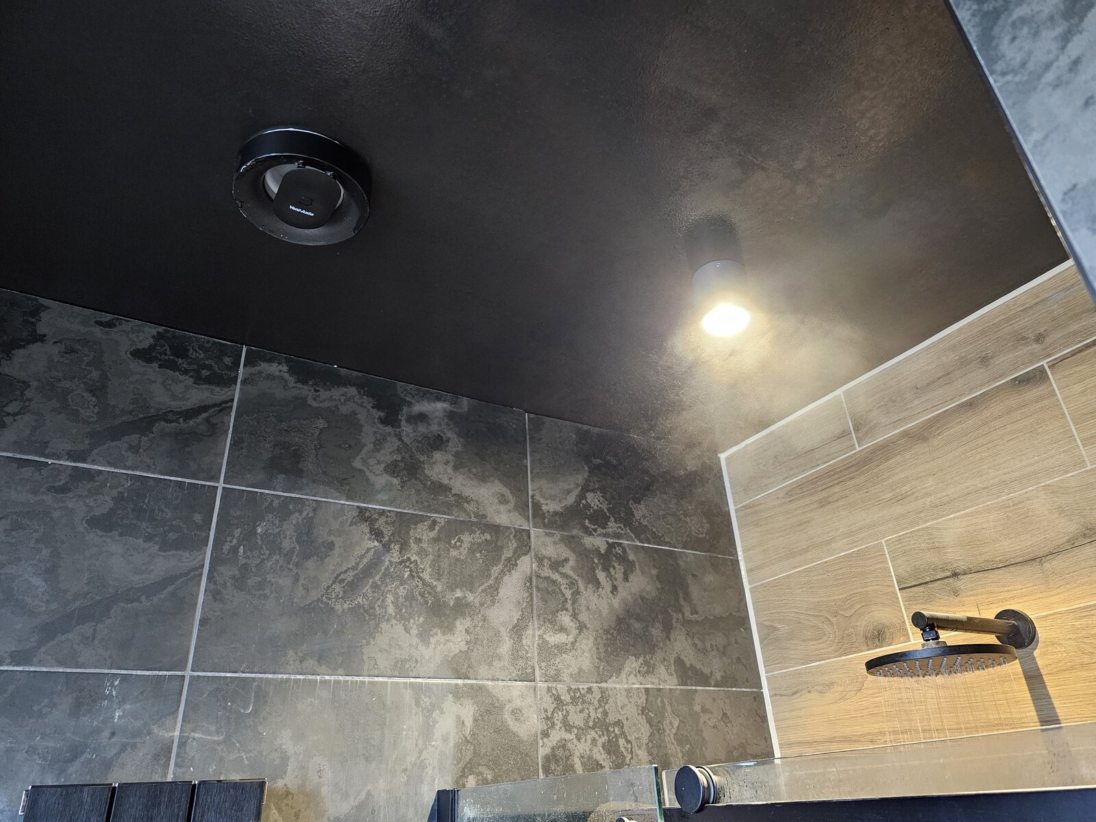

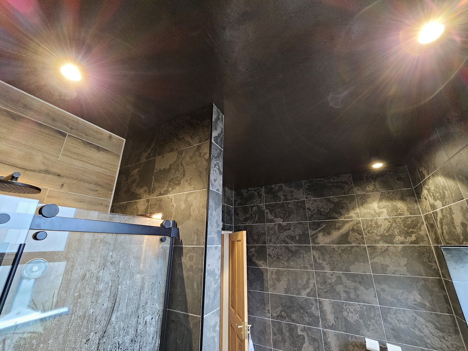

Why is the ceiling so dark ?
Unless the room is warmer you will never eradicate the damp. That’s the issue
Painted black (anti mould paint).

i see your extractor fan. What is its nominal air throughput?
I can't see it.
240 m3/hr is usually enough.

I think the fan is the issue and if you do tests on different days the ambient temperature starts to have effects
That's the trouble then. You have a small, weak fan suitable for a WC cubicle, and put a long duct on it. It is inadequate for a steamy shower.
Yes and no. That extractor is one of the most powerful extractors that isn't an inline type. It's certainly the type (and others like it) recommended for normal size bathrooms and 1.4m of ducting cannot be described as long. Unfortunately almost every top website that lists best extractor fan for bathroom etc has these as the top picks whereas they really should be promoting the inline extractor
Inline extractors are a lot more powerful (and great for long duct runs 4m+) but unfortunately there was nothing to suggest this was needed at the time of install but certainly will be looking into that now
