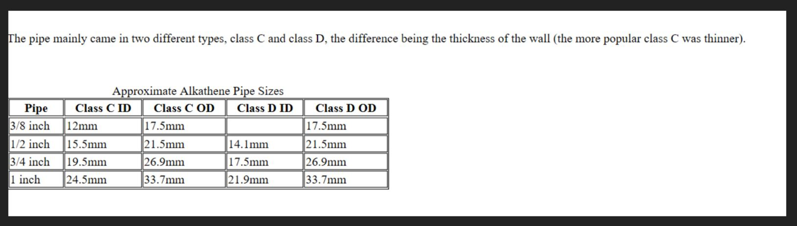

I have a problem with an old Imperial Black Alkathene Mains pipe (outside Diameter 21.3mm 3/4 inch), which supplies water into my flat.
The pipe has had a 22mm metric brass stopcock attached to it for the past 15 years, using a standard olive compression fitting, but recently the pipe has cracked a bit at the point that it attaches to the stopcock causing a small leak and this needs to be remedied.
Ideally I'd like to cut the pipe below the crack, put in a stiffening insert and a 3/4 olive to re-attach back to the stopcock.
Trouble is:
I don't know if the Alkathene pipe is a class "C" and class"D", these have different internal diameters. I can't shut water off too the flat to cut off a bit and find out, it needs freezing.
I can't find anywhere that sells inserts for Imperial BS 1972 pipework.
Believe it or not I have sought professional help, but everyone I've contacted is either busy, on holiday or doesn't deal with alkathene.
Any suggestions where I can get pipe inserts please?

I've no idea what the internal diameter of the pipe is, most inserts I've seen are 15mm, though 16mm Hepworth inserts are available too. I don't want to cut it and then end up with an insert which is too big /small.
Freezing it will not go well for you - it'll either make the plastic go brittle and shatter, or you'll end up cracking the ice plug as you inevitably flex the pipe when you're cutting it. Both will lead to the most monumental flood.
If it's heavy gauge pipe you don't necessarily need an insert - a Philmac Universal Transition Coupling will be sufficient on its own

Got a pro to put on a Philmac Universal Transition Coupling today, straight into 15mm copper. New stopcock too.
In the end freezing/squeezing wasn't required. Turns out Thames Water is trialling water meters for the block and there is now a shut off valve!
