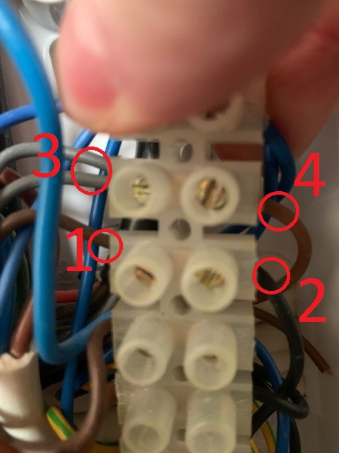

just a quick question.

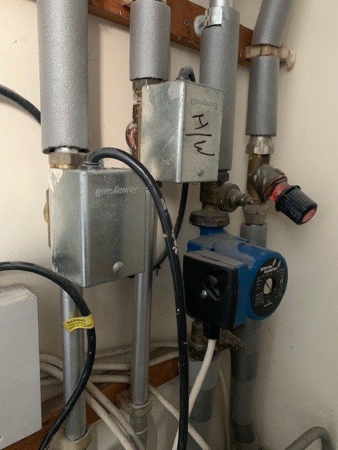

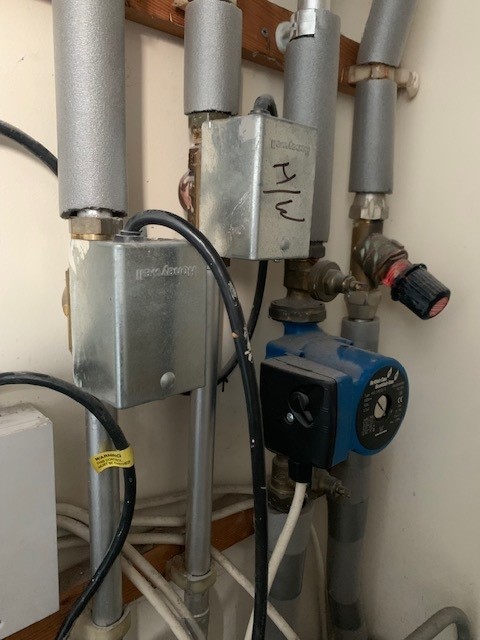

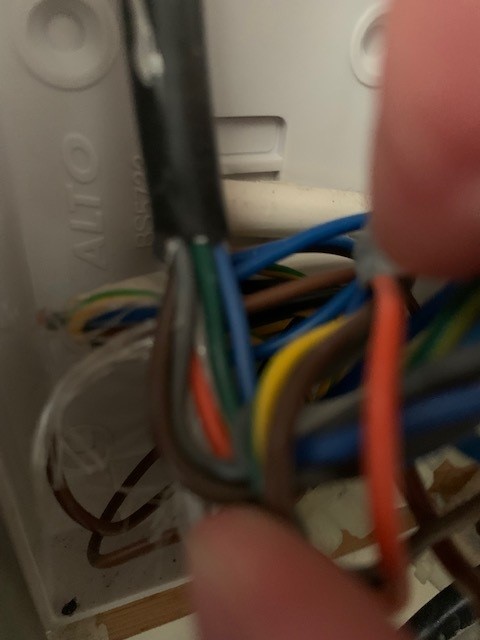

Image 9 this show the valves - i took the left one as the heating valve middle is the HW valves, what is the blue one? just want to check

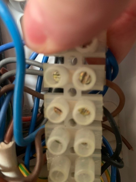

Image 10 - if this left valve CH is correct above then this is the wire which comes in the central wiring station. The brown wire is the live which i need to trace too?
Image 11 - this the point above is correct then this is where the brown wire connect to which is a black one. both the black wire and brown above i believe come from the thermostat (red and yellow cables which have changed colour once travelled through the other wiring station)
If that is all correct then i would in the simple work connect the brown and 2 grey wires together to complete the circuit? Which would mean the red and yellow thermostat cable are free from the circuit ( i would test this too).
Wondering if im on a good path?

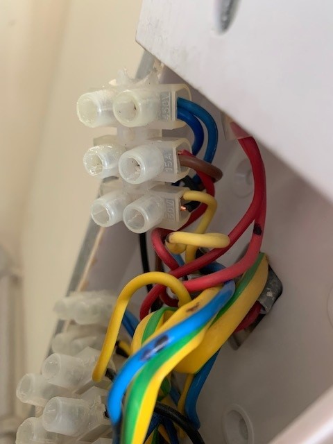

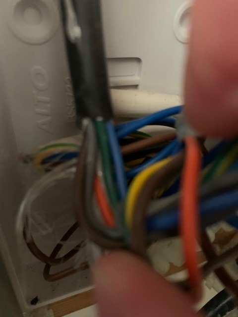

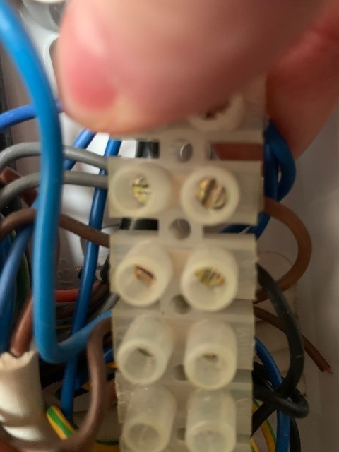

to add this image 8 is where the thermostat would like to in the mini wiring station as all the wires match up as the thermostat wiring.
Yellow = Black
Red = Brown
The brown(red) now connects to 2 grey wires what is this?
The blue “valve” as you’re calling it is the pump, and that’s activated once either or both zone valve opens.
Can’t see any grey wires, but they’re usually permanent live.
Sorry, I don't understand the question, and I don't see any grey wires. Two grey wires would normally be to the motorised valves, and would provide the permanent live for them to control the boiler. But they would be nothing to do with the thermostat wiring.
apologies, so now i am trying to locate where the red and yellow thermostat wires go to.
Question 1: Image 8 is the mini wiring centre which looks like the thermostat goes there first before connecting to different wires to go to the main wiring centre.
If this is the case:
Yellow = Black
Red = Brown
Is this correct?

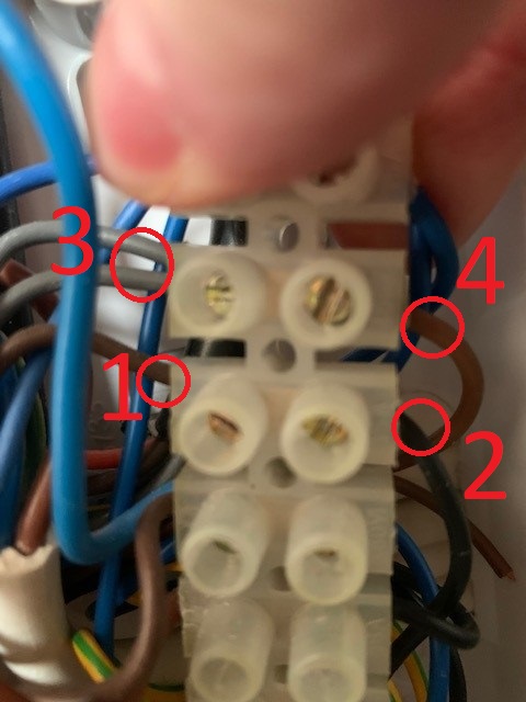

Questions 2: Image 11 (updated) for CH valve Brown wire (1) this connects to the black wire (2) this used to the yellow wire from the thermostat. and above it (4) used to be the red from the thermostat.
What are the grey wires?
Would i connect the grey wires and brown wire (1) to complete the circuit and therefore the thermostat wires have been taken out of the circuit?
hope that makes better sense now?
If thats the case then i can figure a way to connect the two wire taken out of the circuit to the heatlink?
That looks a bit more promising. So, as I understand it you are telling us that:
CH MV brown wire.......>black wire.......>Suspected Yellow wire to thermostat.
OK so note where the yellow wire is connected and remove it.
Also note where the red wire in the same cable as the yellow one is connected and remove that.
Now carry out the test I mentioned earlier, if you can't do it I suggest that you get someone who can, just to be sure.
At this point I would normally test with a multimer to be sure I have the right wires. With the multimeter set to resistance connected to the Red and Yellow wires, get an assistant to turn the thermostat up to max. The resistance measured should be very low. When the thermostat is turned to minimum the resistance is very high. If so, you have the right wires.
Once you have determined it is the thermostat cable just insert a link to join the two terminals together that you have just removed the red and yellow wires from.
I mentioned them earlier.
No.

So in image 8
'If' this is the thermostat wires i would remove the red and yellow out of the connector and then simple connect the black and brown together in the same connector hole?
This would take the red and yellow wire out so i could then look to connect these to the heatlink and nest thermostat?
That all sounds good to me (y). Provided that there are just the black and brown wires that can be seen in the photo left behind once the red and yellow wires are removed. [by that I mean there aren't any other wires we can't see in the far side of the two terminals]
The blue wire and earth from the same cable can simply be disconnected and removed. The cable should be completely disconnected from any mains wiring before using it for 12v
