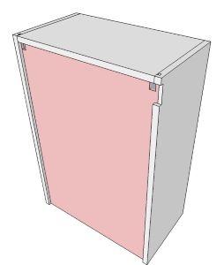

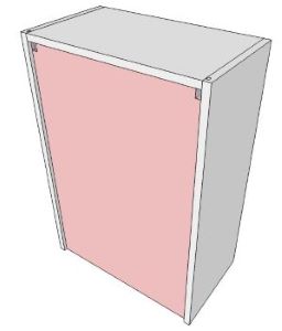

To some people this may be stating the obvious, but bear in mind that to use these long rails you'll need to notch out the backs of the inner cabinet "gable ends" of all the cabinets - so for a RH end you'd need to do this:
-> TO ->

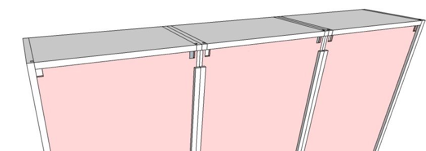

making a full run of 3 look like this:
Don't forget: don't notch out the outer end panels of the cabinets at the ends of runs (as above) and remember to take 36mm off the total run of the cabinets for the length to cut the rail (so 3 x 500mm cabinets would require a rail of 1500 - 36mm = 1466mm, or ideally a couple of millimetres shorter, no more, to give yourself a bit of "shimmy room"). These two things are easily overlooked.
