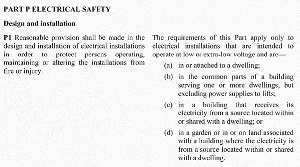

On the subject of part P
England use one version (2013)
Wales use another version (2010)
Scotland and Northern Ireland don't have Part P
As long as you live in England what you propose isn't a new circuit or within zones in a bathroom then no notification required
Or not.

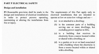

Nope, same version:
That's it. There is no more.
As said above - and ignored - the notification requirements are in separate Building Regulations - Regulation 12 in England and Schedule 4 for Wales.
It's only been eighteen years.
You are probably referring to Approved Document P which is just some guidance that someone wrote.
