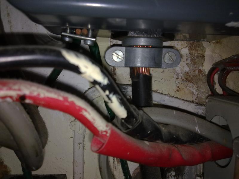

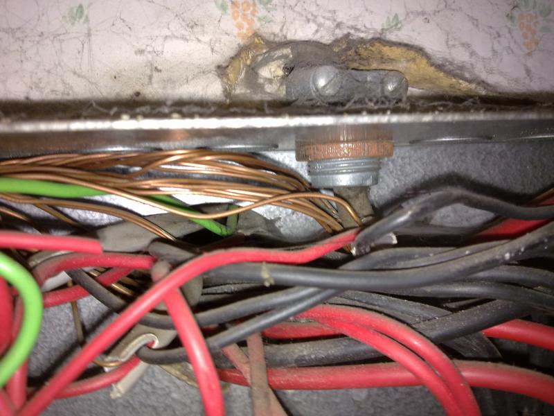

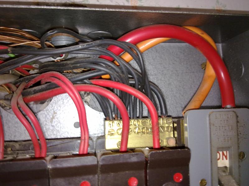

Hi - looked at job today - kitchen which is in extension.
There is a sub main feeding a separate consumer unit - this is a concentric cable which the installer has split the outer un insulated copper into 2 with 1/2 for neutral and 1/2 for earth.
The incoming supply is TNS
Is this acceptable? I realise the problem with broken neutral elsewhere in install at meter
Would running a separate 16mm earth and using outer concentric as neutral only be a solution?
The intention is to fit new RCD consumer unit on end of sub main for kitchen install. Will have hard time trying to sell new sub main cable
what would you do? any advice or suggestions welcome - thanks
You cannot use that cable as a submain - it is (as you correctly state) straight concentric as opposed to split concentric.
Even if you ran a new earth and used the concentrics as a neutral, you would have a single insulated neutral which is not permissible.
Your only option is to run a new submain really.....

Thanks very much for your prompt reply - my heart sank when i saw this as i knew it was dodgy and i was only there to price the kitchen for kitchen contractor.
Did'nt think of the single insulated neutral issue only the TNC-S bit

Then again, if I'd looked at that wiring (as a lay person) I'd have been a tad concerned with the previous sparks work - I can't believe they aren't already anyway!
That wiring looks messy enough to be on an American electricians' forum.
better tell that to the electricty suppliers :wink:
As RF says, they do not have to comply to our BS7671.
Straight Concentric IS NOT compliant under BS7671 - yes, DNO's use it everyday, I think we are all aware of that.
And they combine earth and neutral too - something else the consumer's not allowed to do, and something else this bozo has done.
