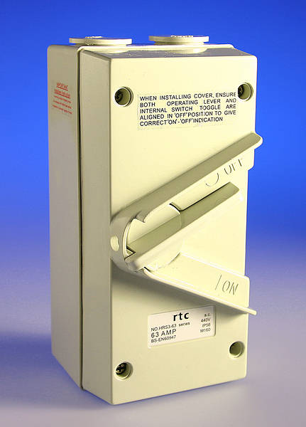

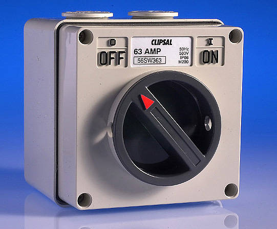

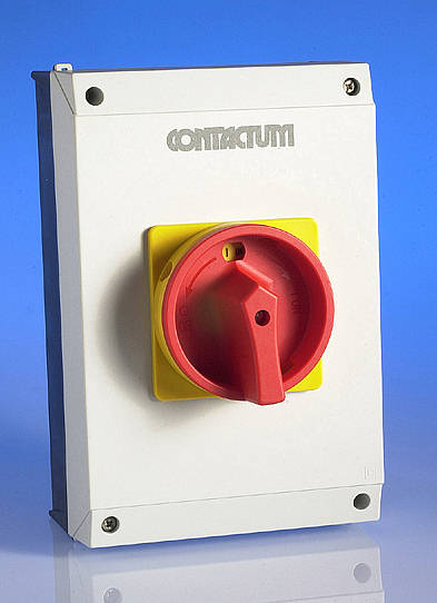

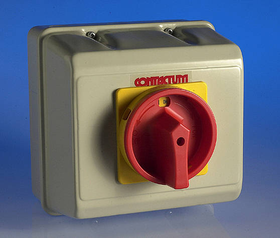

C/u will be in the house by the incomming and main c/u. It will be about 4 mtrs to Spa and about the same to the Sauna. The 6mm to the Sauna is already run. All internal. The swa has to be run as does the build of the internal sauna. Thought about local isolation. Understand that this should be at least 2 meters away from the Spa and as the c/u is only 4 meters, although it is in the house was going to have the mcb and c/u as the isolation. For max safety I could put an external switch on the wall. Do you know of any waterproof switches/isolators which can take swa and are rated at 45 amp?
Other makes are available - Klockner-Moeller are pretty good.
