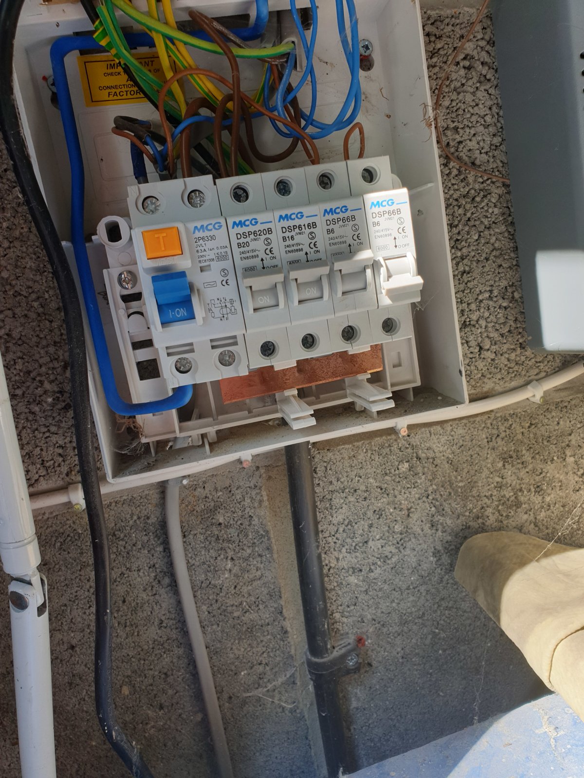

just ordered a 13 amp hottub and deciding where to put it in the garden. I will require an outdoor socket putting in. Near to house would be easier but we both would prefer it at the bottom of the garden. If this is the case may be able to bring a socket from the garage which is nearer. Would this just require the electrician to come of an existing socket in the garage with swa to the hot tub position or from the small consumer unit in the garage which is already fed via a swa from the house? Any advice welcome thanks

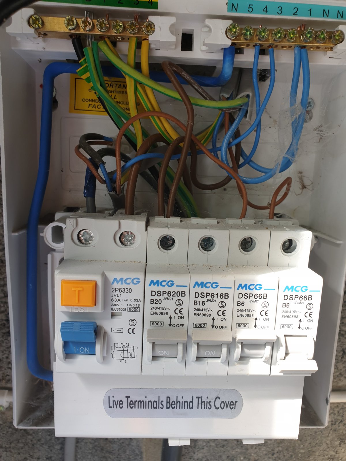

This is the CU in the garage fed via swa 20m from house. There is a spare b16 rcd, do u think this would be suitable for a sparky to connect an outdoor socket to? Thanks again

That is NOT an a spare RCD. It is a spare MCB.
As I said in post 2 an electrician is the best person to ask as he can see exactly what you have in terms of cable sizes etc.
Funky - re the electrician, I'm sure he'll be happy for you to do the manual labouring to dig the trench for the cable and to possibly excavate the hot-tub area for an earth mat.
