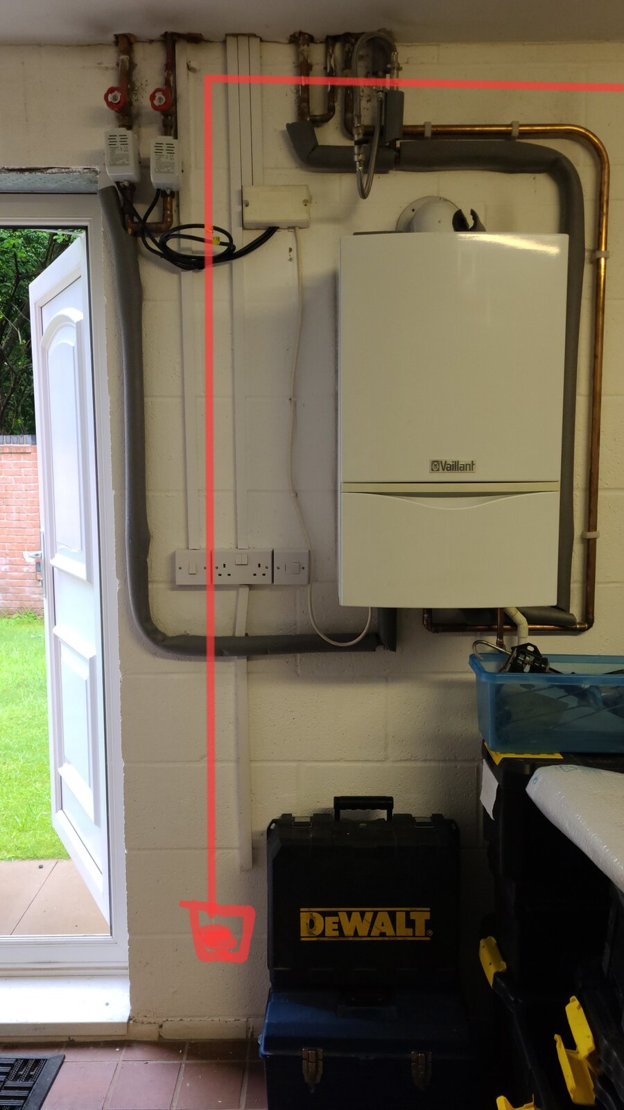

I am fitting some plasterboard and cupboards in a garage that is attached to the house.

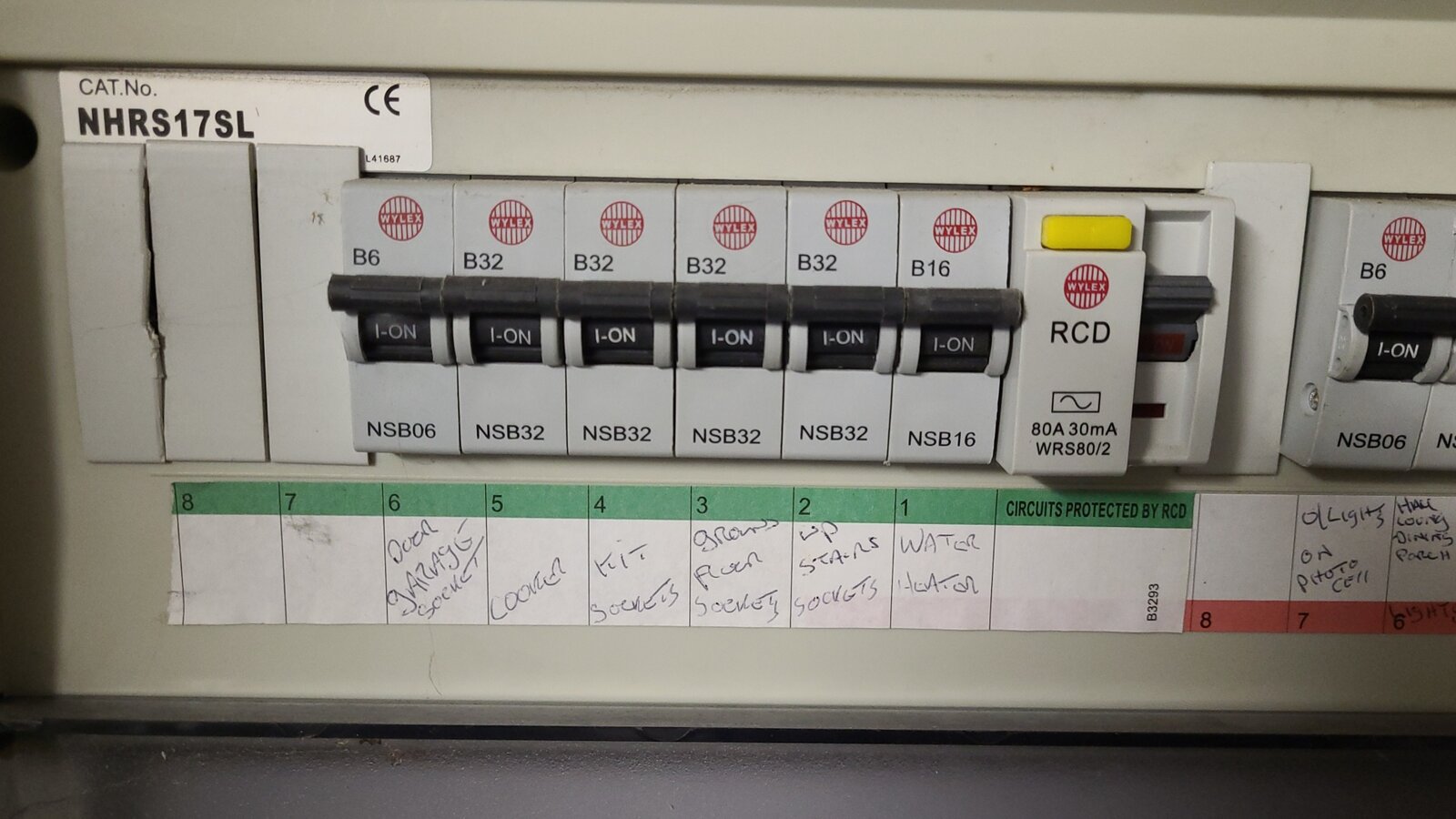

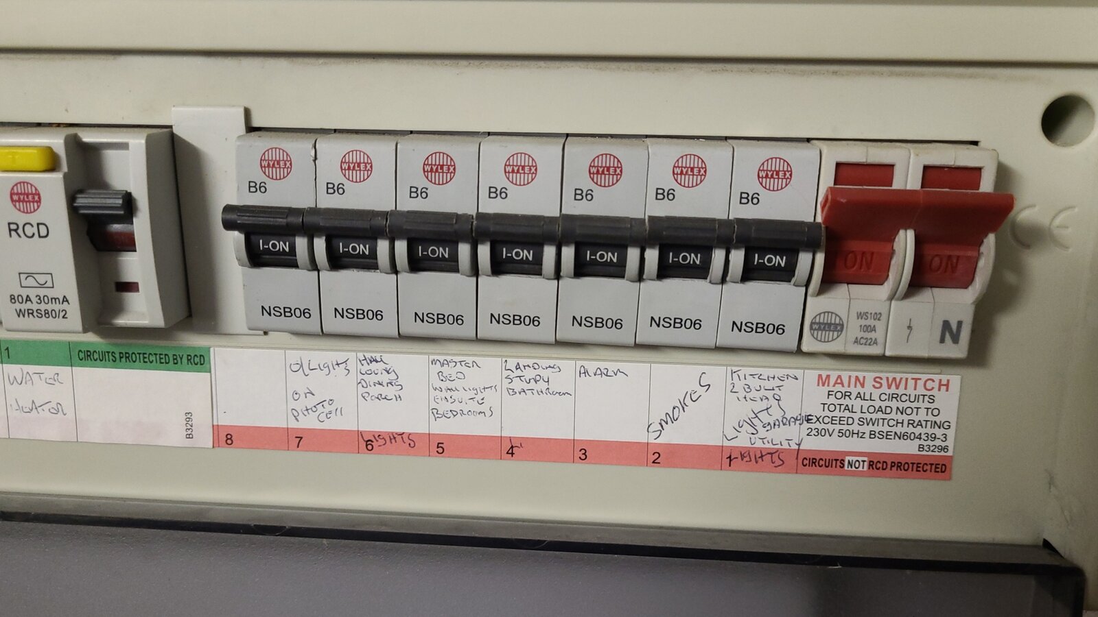

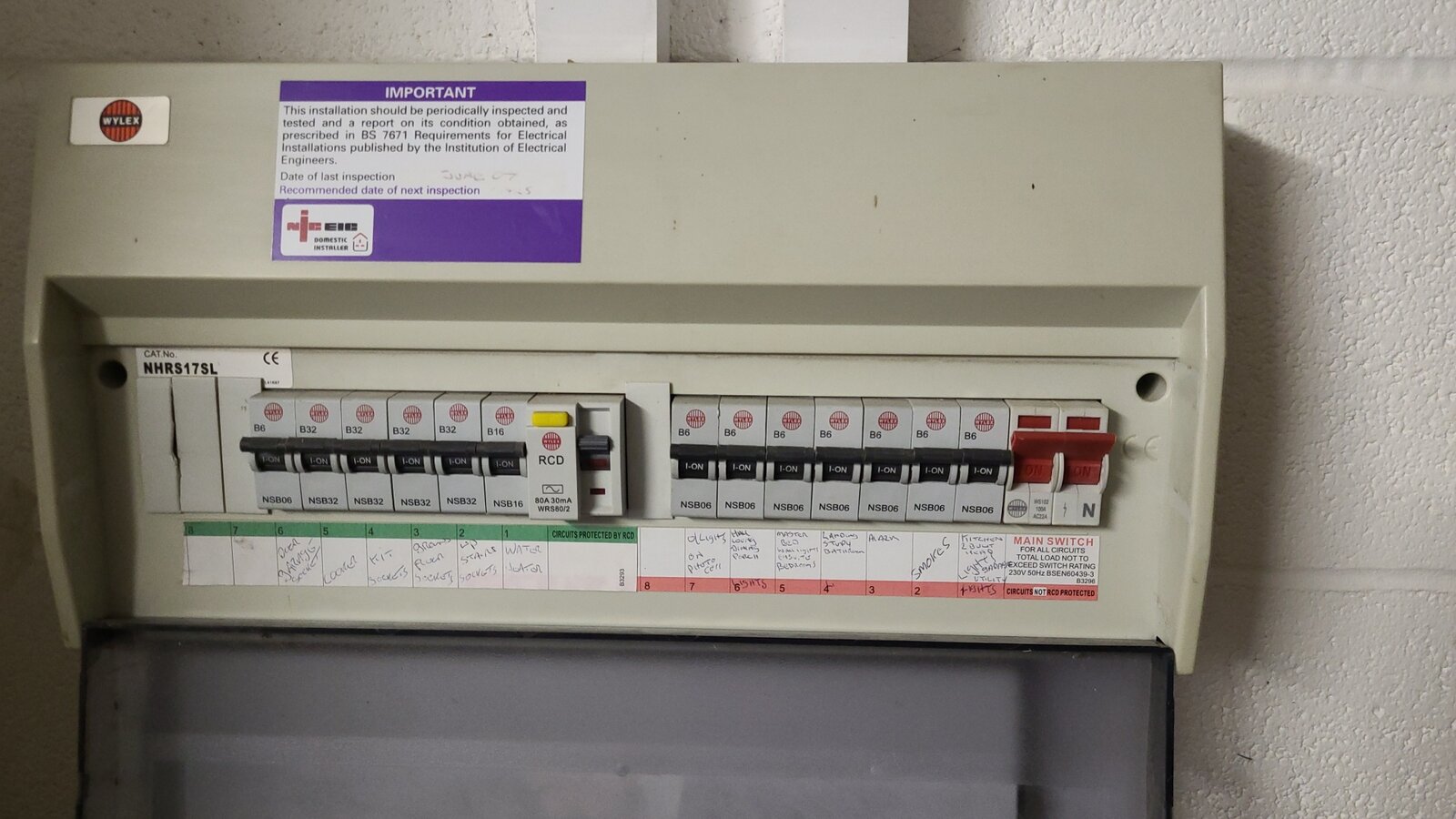

The consumer unit is also in the garage.
I want to have power to the outdoor patio and Hot tub. I would like to install suitable cable(s) behind the plasterboard now ready for the electrician to use in the future. I would like your advice on the best way to do it and the best cable size to use.

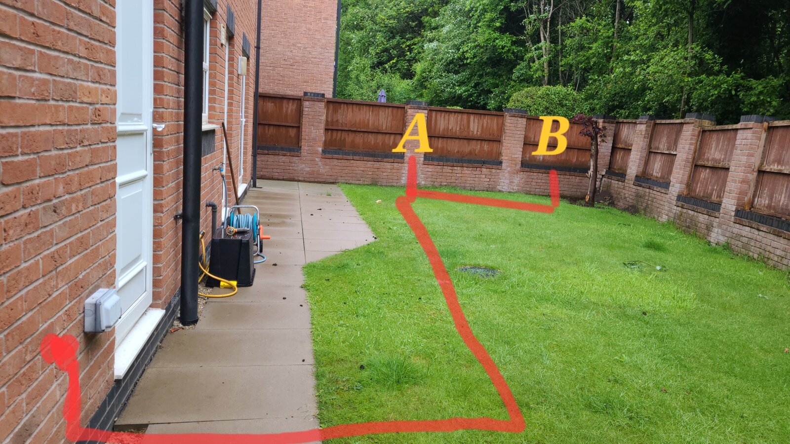

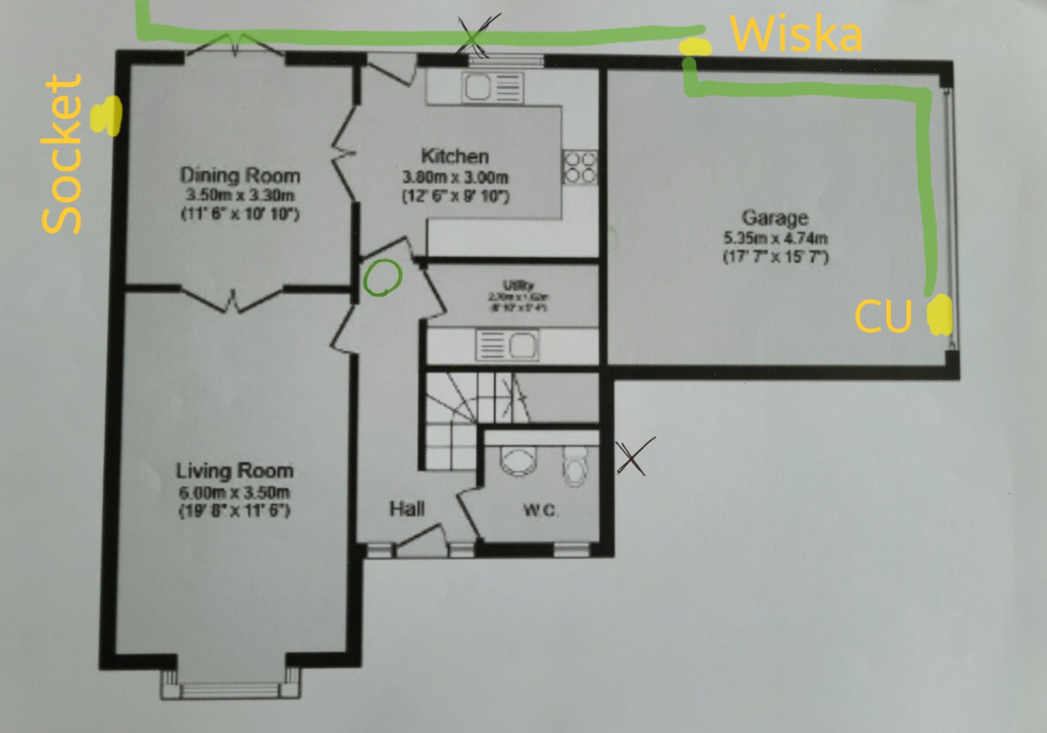

I am thinking of running the cable(s) internally (behind any plasterboard/cupboards), so up from the Consumer Unit to the safe zone within 150mm below the ceiling, around the two walls and then down to near the floor where it will exit through the wall to an external box. Then SWA to the patio and Hot tub either clipped along house wall below the dpc or dug into a trench.
The supply for the Patio should have enough power for a small outdoor kitchen (perhaps, electric BBQ, hotplate, Kettle and maybe two 2KW patio heaters) Unlikely, to be using heaters while cooking.
Current Hot Tub is 13A plug and Play type but I am wondering how much more expensive it will be to have a 32amp supply for future proofing
There is a existing outdoor socket close to the Patio but probably of little use (maybe the patio wall heaters or the 13amp hot tub??)
- Internal run from CU to outdoor box 12m
- External SWA from box to Patio 14m (A in photo)
- External SWA from box to Hot Tub 16m (B in photo)
A brief conversation with the guy at the counter in electric suppliers suggested running two 6mm Cables internally and out to the Wiska box then two 6mm SWA to the Patio and Hot Tub with IP65 Rotary Isolator switch.
