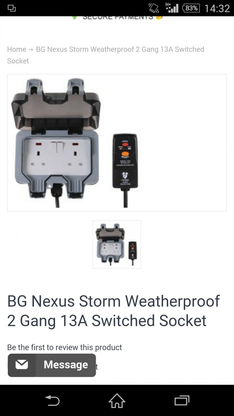

Hello everyone,
This is my first time on a forum like this and hope you can help with my query.
I have recently bought two 150 watt pir security lights. I would like to wire these up to two three pin plugs with a 3 amp fuse. I am thinking of using three core 1.5 mm armoured cable. I have bought a outdoor double socket that has a 13 amp fuse in it and will connect this to my indoor plug socket by drilling a hole through the kitchen wall. The outdoor plug socket that connects indoor has an RCD plug attached to it. I am looking to only have this switched on at night times as a security deterrent.
Would this be ok and safe to do and am I breaching any regulations.
Advice would be much appreciated.

The outdoor socket is the same as the picture I am enclosing. This is wired up to a RCD plug that will be plugged into the kitchen.
So the socket will be fused via the RCD adaptor socket.
Still not something I would use, as previous post I would try to bring the connections inside of property, rather than plugged outside.
Thank you all for your input. I haven't seen any other posts on the Internet regarding my query. Is this something that I can do without causing any danger to anyone and is it something that would need to be checked for legal reasons. I thought that having an RCD plug would be the only thing connecting to the actual household mains and if anything were to go wrong then the RCD would just shut it all down. Apologies if I am going on a bit. Also what thickness wire would I need to use as I will probably need 10m of it Due to placing one of the lights at the front of the house and what fuse amp to put in the actual plug that will be wired up to the Pir Light.

Will the RCD plug fit the socket and allow the lid to shut?
Why not get an RCD socket?
Is there RCD protection on the circuit already?
Why do you need armoured cable?
Why not do it properly?
I am trying to save money by doing it myself. The black RCD plug that you can see if the picture is already wired up to the outside plug socket box, this is how it is meant to be. The RCD plug will be plugged into the normal house mains socket in the kitchen. There is a double socket that I will use to plug in the two plugs from the the two pir lights, so the lid will shut correctly as they will only be two standard plugs in there.
I know it sounds like I am going around the houses with this. I just wanted to do it in a way that would mean I would not need to wire up the electrics inside the house and disturb anything as I am not qualified in that way. I thought by using a RCD plug as the only piece of equipment that would be entering the house
Ah.sorry, I misunderstood.
Your PIR lights are only going to require a 1A fuse to allow for current demand.
0.75mm three core flex that is suitable for the conditions, such a solar, frost, flora, fauna and possible mechanical damage.
So very likely 0.75mm flex and 3A fuse will be suitable.
