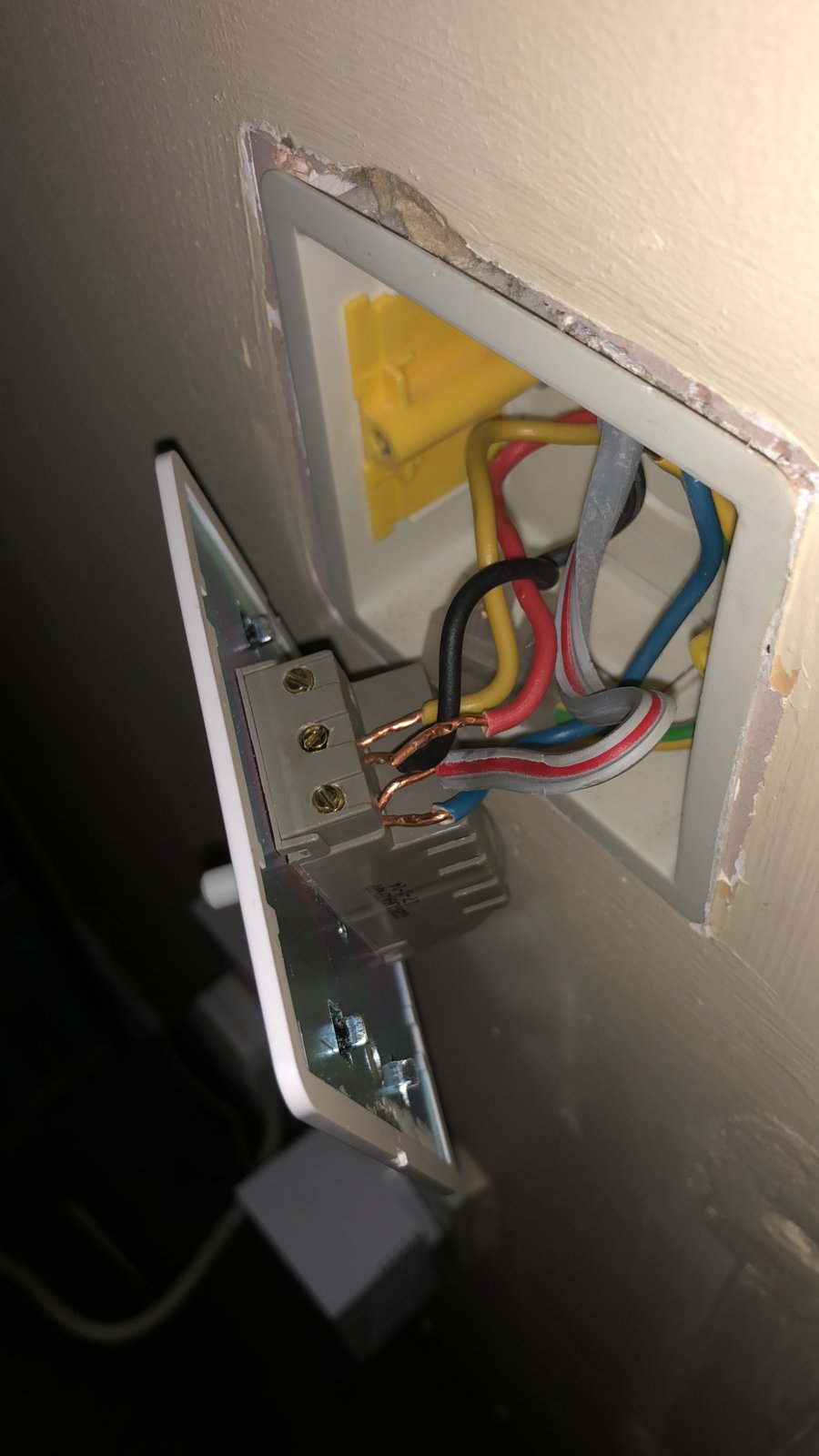

This is what’s going on behind the switch. If someone could literally say, black and red here, blue and yellow there etc, like done above I’d be hugely appreciative!
Edit - anyone know why I can’t upload this picture?
Here!

I’ve noticed that on the back of the same switch in a different Homebase store, it says that for two-way switches one of the switches has to be a retractive switch... Is a pull cord a retractive switch of sorts?
Well, I have, albeit you have a strange red single wire.
First of all you have to find which colour wire is in the COMMON terminal of the pull cord switch.
Right!? When I’d looked it up it seemed simple enough, but the wire combinations aren’t what I expected!
How would I find the colour wire in the common terminal? If it’s a cord pull, if I screw off the plastic attachment that hangs from the ceiling, would I find it in that?
Or would I have to do extra things and it isn’t as simple as the wires hiding under the plastic?
